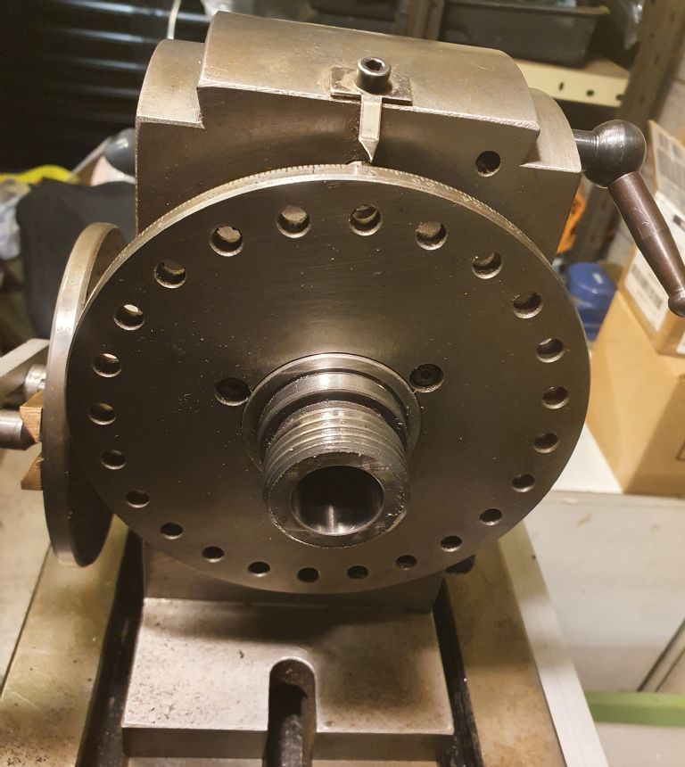

      I bought a second hand dividing head which is in great nick and has a Boxford 1.5" x 8 TPI thread on the spindle.
      It came with a chuck backplate (but no chuck) however when I offer the backplate to the spindle it only goes on about half way and locks up. So I bought a new Boxford rotary table mount (needed one anyway) and tried the backplate on it – same result – it locks up.
      I read on another forum that the issue is related to 55 degree verses 60 degree thread angle! The other forum also mentioned that a 1.5" x 8 TPI BSF tap, run through the backplate hole, will fix the problem. The cost of a 1-off 1.5" x 8 TPI BSF tap is £91+p&p = £116 which, as a pensioner, is way outside my budget.
      So would any kind sole be prepared to lend me the BSF tap for a few days? I will cover expenses and return to the owner afterwards. I live in Co Antrim. My word is my bond.

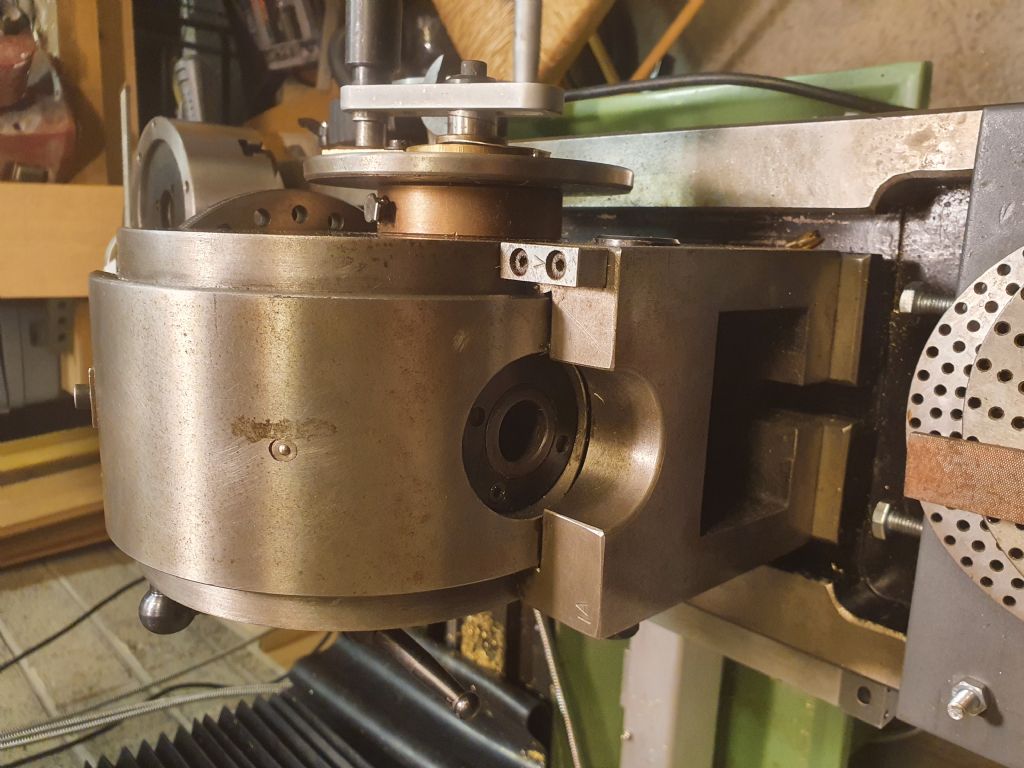

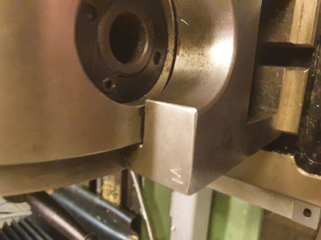

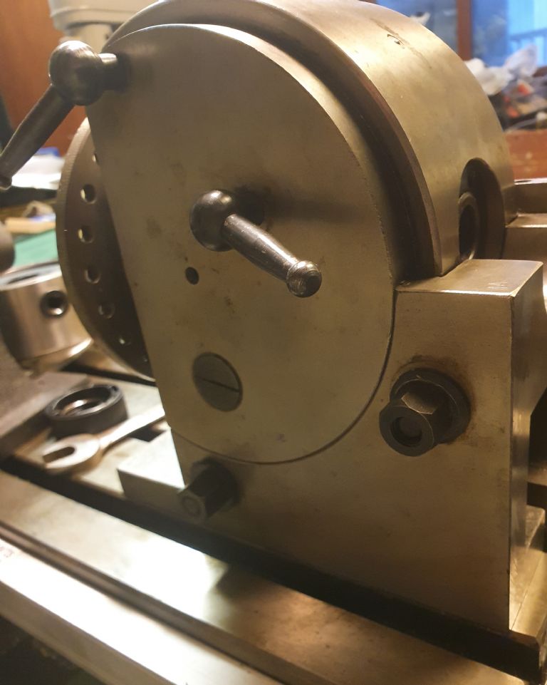

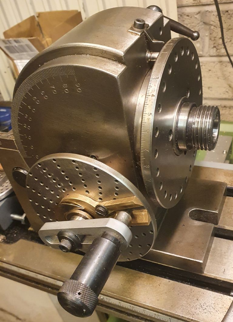

                                      Alan, can you post a picture of the DH to see if someone can identify it? If it is a continental unit (Walther, Hoffman, Rawler, Lucy, Aciera, or similar) it is credible that it is a 38 x 3p thread.
                                      #506494
                                      Alan McDade
                                        @alanmcdade29638

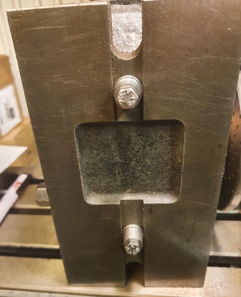

                                        7 bottom.jpg6 ia markings.jpg5 back.jpg3 back.jpg2 front.jpg1 dividing head.jpgPosted by Oily Rag on 07/11/2020 10:03:31:

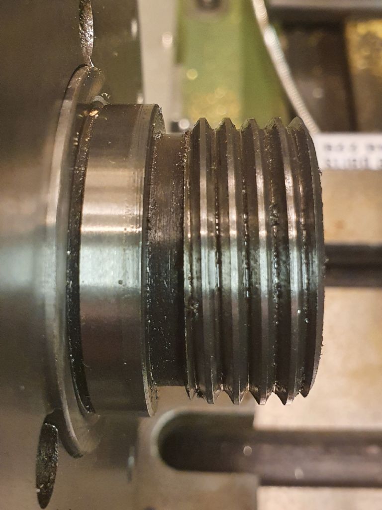

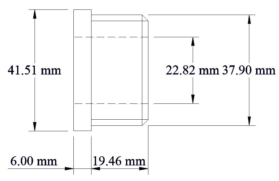

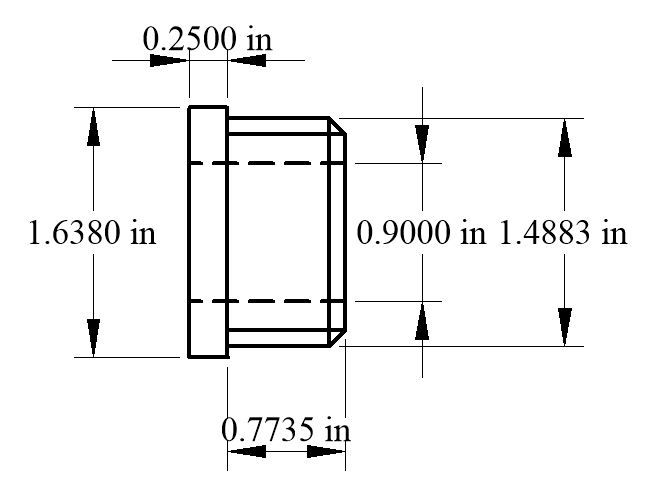

                                            metric dimensions.jpgDimensions of the thread as follows:

                                              The numbers do not add up unless am mistaken and they are of 2 different items.
                                              I stand to be corrected.

                                                That's not a Boxford spindle fitting. The Boxford is 1.5" x 8 tpi with a 1.5" dia. register.

                                                  I agree with Oldiron, there are discrepancies
                                                  The dividing head looks identical to a Vertex if that is helpful

                                                    Unfortunately, I don't think there is enough difference in the threads to modify your Boxford plate. I have turned Boxford backplates into Smart & Brown ones, but thats going from 1 1/2" to 1 3/4".
                                                    What is the thread pitch?
