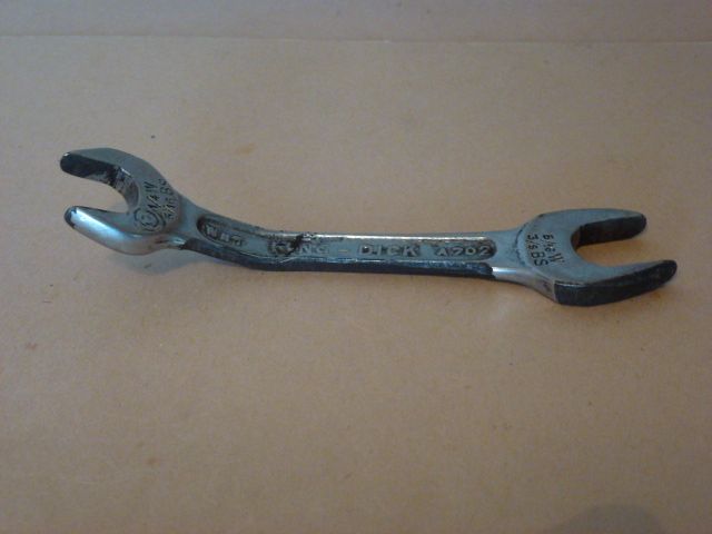

                                  I have had a Southbend and now the Boxford AUD, that headstock bolt is difficult to tighten, I wonder if a big Allen cap screw would be any better if you could find one, probably need a shortened Allen wrench, otherwise a 1/2" socket with the square end machined down and then welded onto a bit of 5mm x 10mm bar ?? – Use a 12 pointed socket, not the 6 pointed hex style.

                                    Clive Brown 1
                                      @clivebrown1
                                      Here's my Boxford headstock bolt spanner.. The available angle to turn the bolt is very small. Not a clever design.p1020781.jpg
