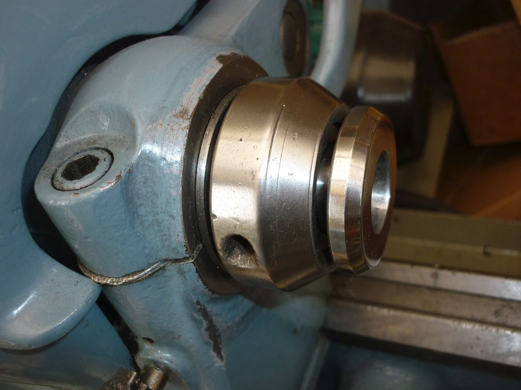

                  If you do use 3C collets with the 3MT adapter on a Boxford, it's well worth while getting the threaded nose-piece that screws onto the lathe mandrel. Not only does it protect the chuck mounting thread and register, it acts as a very useful extractor for the adapter, which gets very tight in the MT.

                        I think he refering to removing the adaoter that often can get stuck tight. The draw bar is threaded internally  on the end so your not supposed to use it for banging out the adapter.
                        On my southbend the nose protector when placed behind can be unscrewed to force out the adapter. as in photo of my southbend.

                          As per above. Knocking out will work, but, if done carelessly with a bar of undersized diameter it risks damaging the small peg at the rear of the adapter which is provided to stop collet rotation when tightening.
                          I'm just suggesting that jacking off with the screw thread is safer.

                                  Well, blow me down with a feather !!!
                                  Only owned the Boxford for 15 years. The threaded spindle nose protector can also be used to extract the MT3 – 3C adaptor….
                                  Who woulda thunk it! Ta velly much.
                                  Has 4 tommy bar holes, so tommy bar or better still, a good fitting C spanner would undo it. In the meantime, keep knocking it out with my brass bar….
