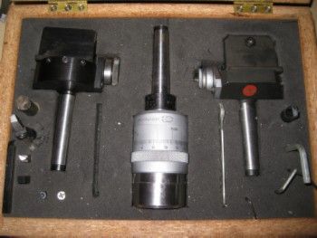

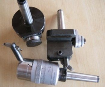

                  #335674
                  Joseph Noci 1
                    @josephnoci1
                    Ah, Well…..
                    Joe..
