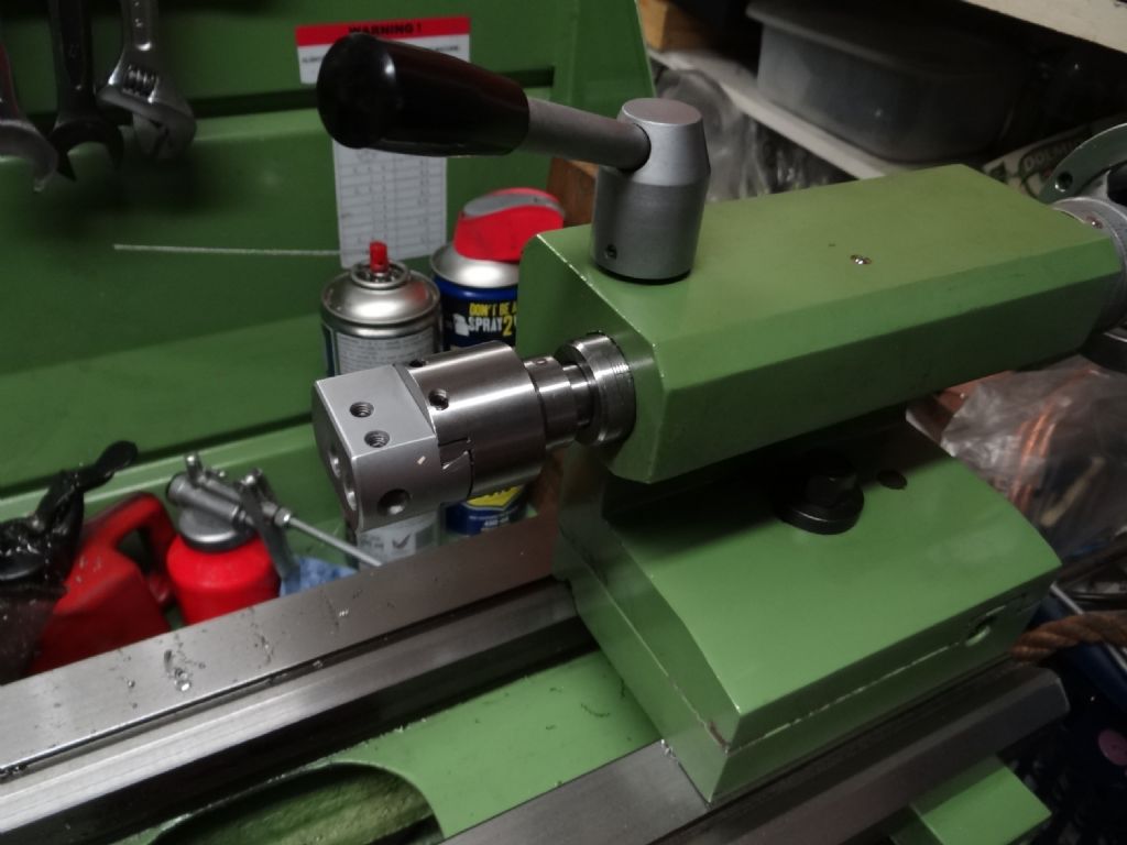

            Forgive me if this is hijacking the thread, but does Reg mean a Boring Head mounted in the tailstock like this?
            If so, is a boring head in the tail-stock advantageous? When I bore in the lathe, I clamp the boring bar directly to the tool-post and move the tool with the saddle. The boring-head is only used on my milling machine. Entirely possible I'm missing a trick due to inexperience. Comments welcome!

                Hi Dave, I had envisioned the head in the 2mt in the headstock, I don’t have a milling machine so have to use the lathe for all things.

                    Ah with you now! Never thought of doing that, probably because I do have a milling machine. Good idea on a lathe. In that case, the maximum would be as John suggests – the point at which the boring bar starts misbehaving because the head can't hold it rigid at the tool point, even with light cuts.

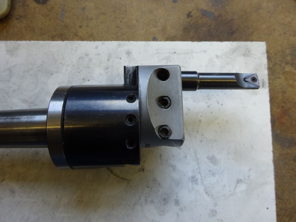

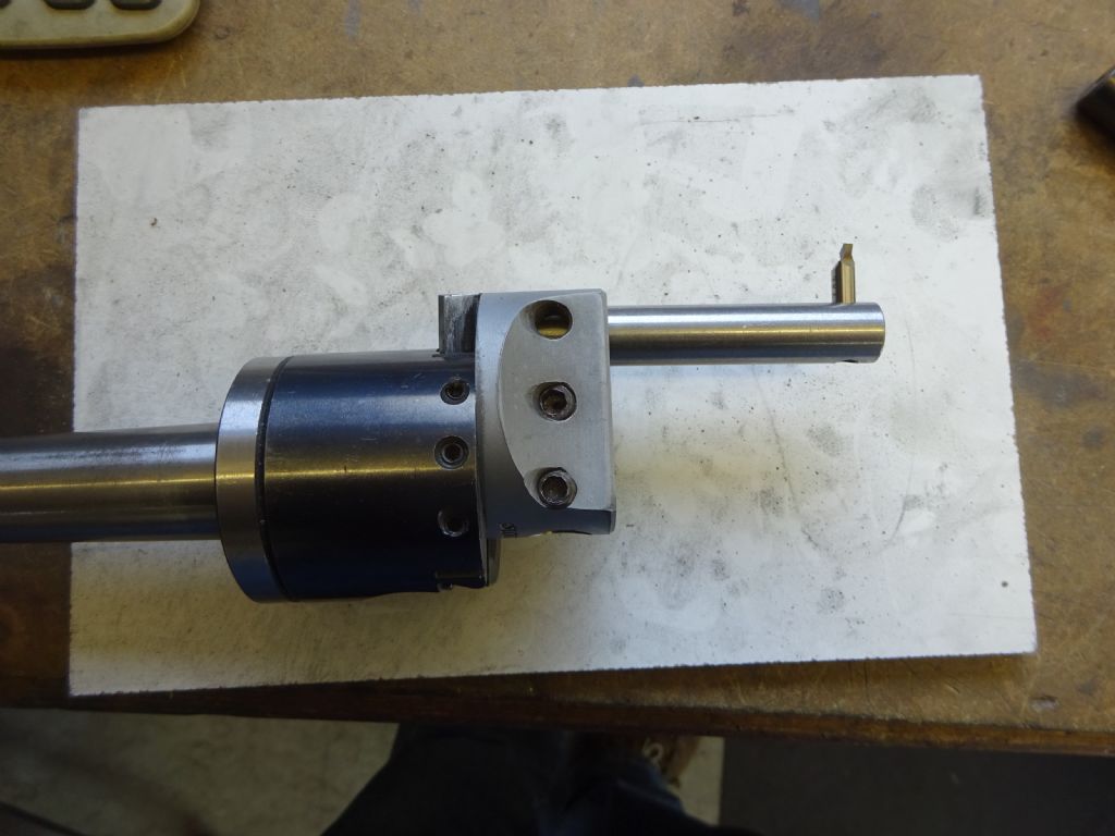

                        Even if using the end holes the type of tooling can be used to gain more diameter where length is needed, look at these two same offset of the head but 1+" increase in diameter

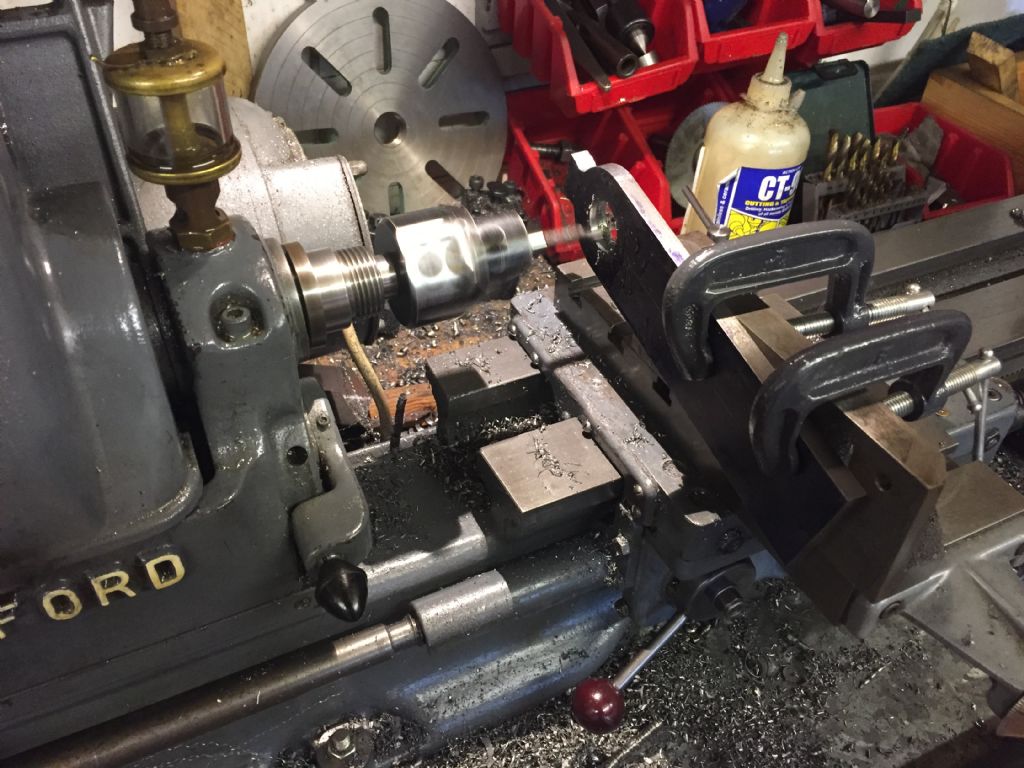

                          +1. I recently used a boring head on the lathe to bore out this banjo, despite having a milling machine (jig borer, in fact!). The lathe's auto-feed made this job far easier than doing it on the mill.
                            Edited By JasonB on 07/10/2018 10:35:34
                            Obviously the tool and its position affects the maximum diameter and with a long transverse tool it can be as big as you like in principle and given enough room on the lathe. But the limiting factor once you have decided where to place which tool, and given the size of your lathe, is how far out the movable part of the head can go without losing rigidity. For me that's about half the length of the dovetail, unless taking very light cuts..

                              Imagine the set up in Jason's second picture say cutting 3 in dia. Now imagine that boring head set like that held in the tool holder on the topslide and cutting a 3 in round bar. See any problems with tool flex and chatter?
                              That is the equivalent geometry you are setting up. Just 'cos you can doesn't mean you should.
