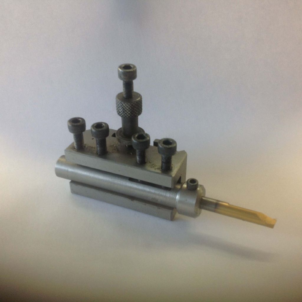

                      I made a similar holder for a small Sandvik boring bar. In my case, the holder was round but the priciple is the same. The boring bar is a tight sliding fit in the holder and if I remember correctly the bar had a chamfer on the rear end. I cross-drilled the holder at an angle of 5° or so and Loctited a silver steel pin through it. This ensures that the tip is presented to the work at the correct cutting angle. ( Make sure youre get the angle of rotation the right way round. ) There is a small allen head screw securing the bar in the holder and a flat milled along the top where the toolpost bolts bear upon it. End result:
                      mini boring tool
                      Edited By John Hinkley on 22/10/2018 19:48:28

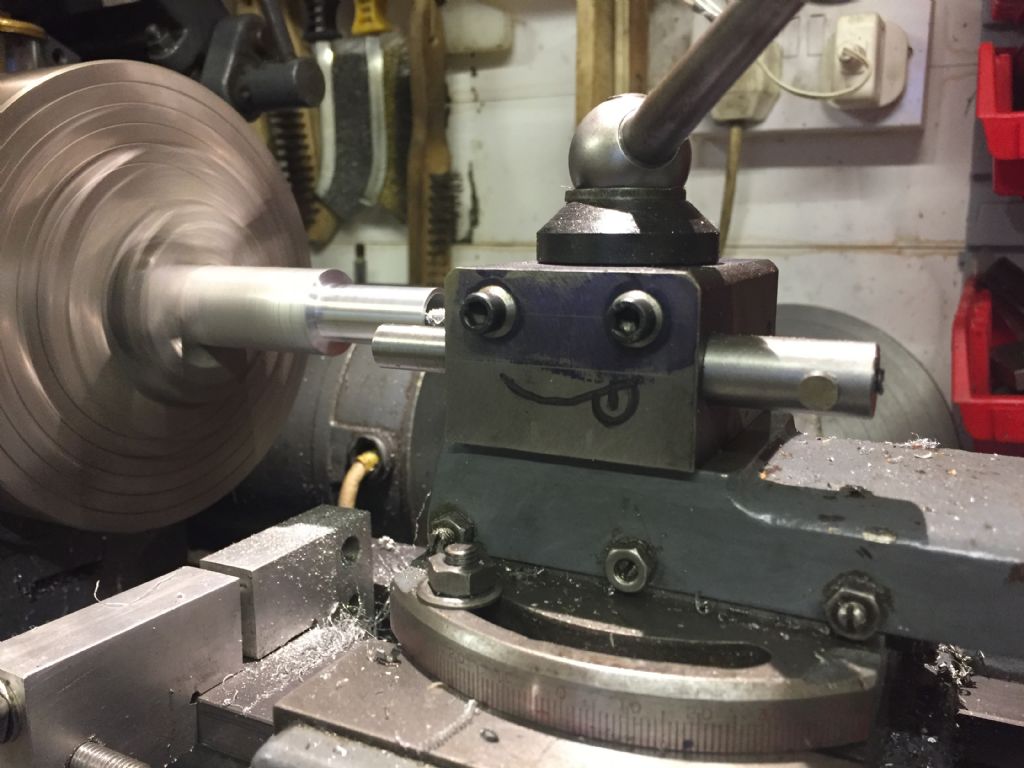

                                        As I don't have a quick-change toolpost, just a four-way, I made a dedicated post for boring bars. It is simply a lump of cast iron, bored and reamed in situ. There's a 1/2" hole and an 8mm hole to suit the bars I use. The securing screws are offset and and push against a bevelled pad (cotter?) that bears on the bar.
