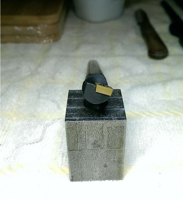

        MikeK
          @mikek40713
          Is this a shop-made boring bar, or a purchased unit?  Is it rotated to provide clearance?  I found this out recently.  My purchased bar is rotated to provide cutting tip clearance, and my shop-made bar rubs from lack of clearance.
