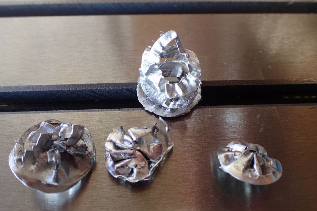

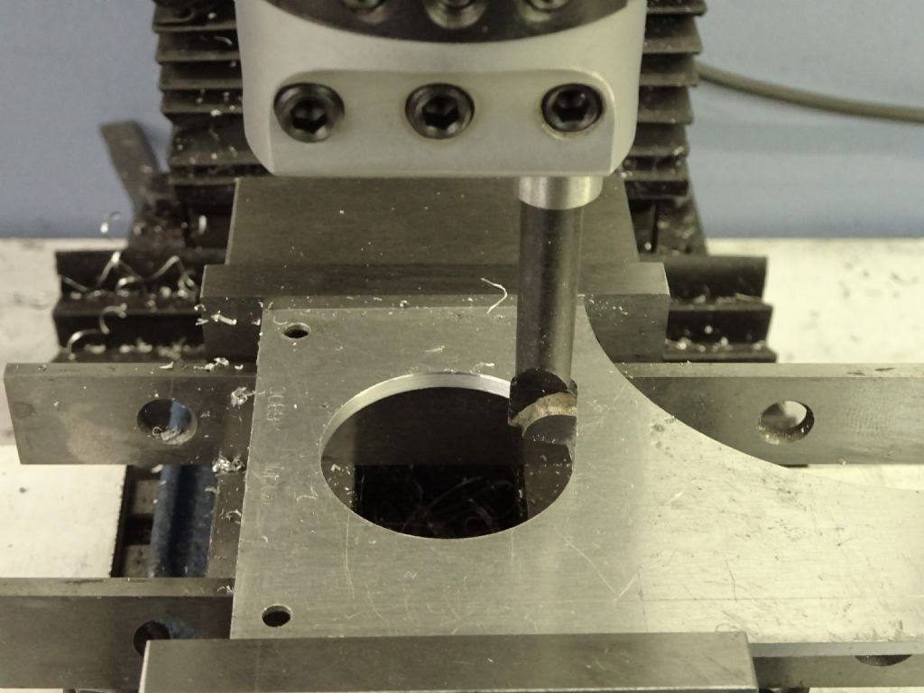

      I wanted a 22mm hole through a 25.4mm square lump of aluminium, so thought it would be a good project to try it out on. The hole came out well in the end, but I was clearly doing something wrong. Not sure if t was speeds ( tried several from 500 – 1500), feed rate – I was feeding the boring head into the work using the quill, or the setup of the tool.
      But I was making some very odd swarf even though the hole was all the way through the work (I started with a 10mm drill), and I was taking 0.25mm cuts, I was getting round disks every pass.swarf.jpg
      The tool used was the carbide on supplied with the set. I couldn't get enough depth with the HSS one.

          Peter,
          You need to show us a view from the boring tool slide axis (a 90 degree shot to the current one) to allow us to judge how the tool is set with regard to centre line. Normally for boring operations I set the tool slightly 'high' as you would when boring from a lathe toolpost. The other question is what is the tool top rake like, if set slightly high you need a good positive top rake when working with most aluminium otherwise you can get tip welding.
          Was the tip brazed on by a passing seagull? Not a good boring tool in my estimation – just a general purpose item. I use either Boremasters, Criterion (solid carbide), or a reputable insert tip boring tool with a decent polished high rake insert for a good quality bore in aluminium. Plus, of course, a little white spirit / WD40 / or Russian Fat.

            The tool is in the incorrect orientation, it should be in line with the slide on the boring head and having a little axial twist to give some rake The tool should move radially in relation to the hole when increasing the cut. By the way, how much are you trying to cut, and did you ore drill the hole?
            just think about it as a boring tool in the lathe the tool as shown is angled about 45degrees to the lathe cross slide and is elevated way above centre Thus it is rubbing all the time

              It looks to me that you have the tool in the head the wrong way around, the clamping screw usually clamps down on the top of the boring bar and pushes the bar down into its seat, you feed the bar out to the right as we are looking at it, you have the tool upside down and facing the wrong way also the cutting tip needs to be on centre to the feed out axis if that makes any sense, a high speed steel tool will cut well on this material at the speeds stated with cutting fluid as mentioned above.
              cheers Colin.
              #541106

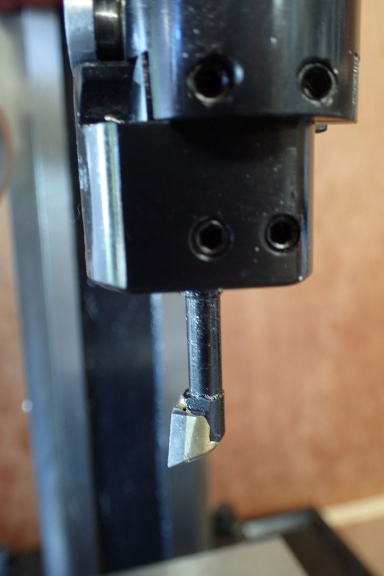

                As Colin says you have the tool the wrong way round as you are reducing the numbers on the dial when increasing the cut. Also it looks like it is dragging. Also The tip of the tool should be pointing slightly forwards as in the picture below, as you have it the tip is dragging not cutting.
                This is a different ARC boring head but one of their bars, cut fine when fitted correctly

                    The 30mm ARC head has grub screws on both sides but tool tip should be facing other way so it advances away from the adjustment screw which can be seen top left wound almost right out.

                        I get that, but how else do you make swarf that wide unless the 0.25mm cut is put on with the quill?.
                        And speaking of the original post, none of the above answers, although they have merit have explained the op's question :- But I was making some very odd swarf even though the hole was all the way through the work (I started with a 10mm drill), and I was taking 0.25mm cuts, I was getting round disks every pass.
                        #541220
                          Having melted the aluminium on a cutter in the past learning the CNC to the point where it becomes "plastic" I would say that as the cutter looks to have about 45deg of negative rake it has scraped/pushed the metal off the stock rather than cut it and what you see is in effect one big burr that has been pushed out the bottom of the hole

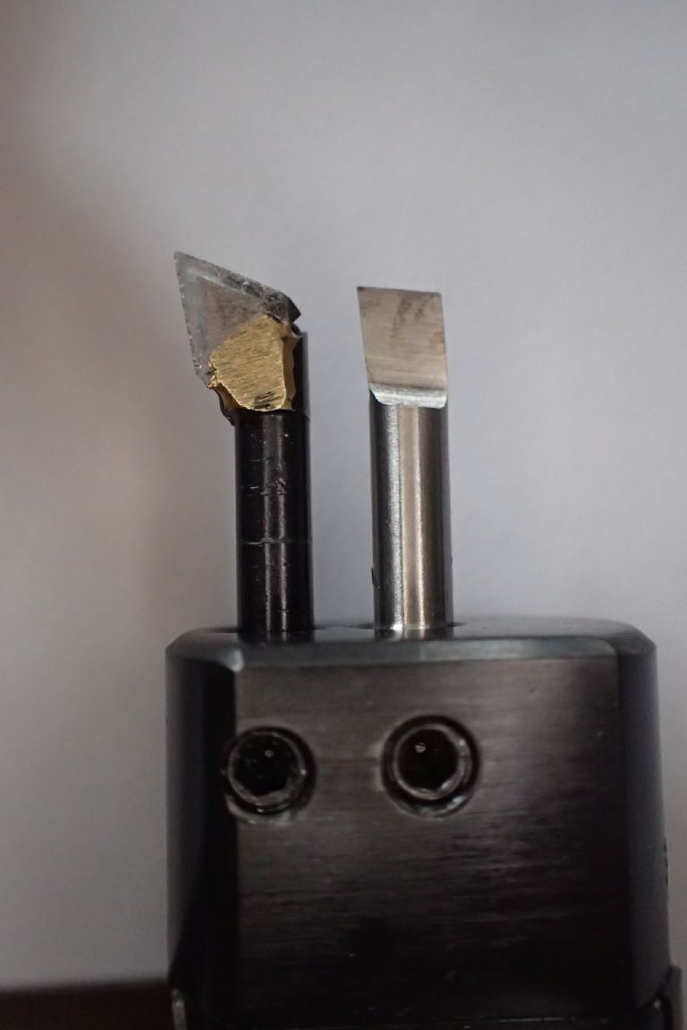

                              Jason was correct about the swarf. The carbide tool has about 25 (rather than 45) degrees of rake, and a couple of experiments showed that at 0.25mm cut depth the point was digging in first and then folding the resulting thin wall inwards towards the centre of the work. Down the 25mm depth it more than created a flat saucer of aluminium.
                              Thanks Paul for confirming it's not just my one. Why the carbide tool is the way it is I have no idea – I am not sure what operation or material would need that degree of rake. For comparison I have mounted the HSS tool (about 6 degrees) and the carbide tool in the head. (I will NOT be using them that way!)
                              Now I just need to find a source of 6mm shank HSS boring tools suitable for the head in a couple of lengths and/or a couple of 6mm shank insert boring tools suitable for the head.

                                    There is something that is not clear to me in the photo above with the 2 boring bars. The cutting edge on the HSS tool is facing the front which is normal. But if the brazed cutter is meant to rotate in the same direction, the carbide tip appears to be brazed onto the back of the spindle. (brazing under tension). They are normally at the front and supported at the back with the braze under compression. (or am I seeing things).

                                      The first photo views the tool as if looking from the left of the second photo, so the tip is mounted normally, it just has an unusually large lump of braze doing nothing behind it.
