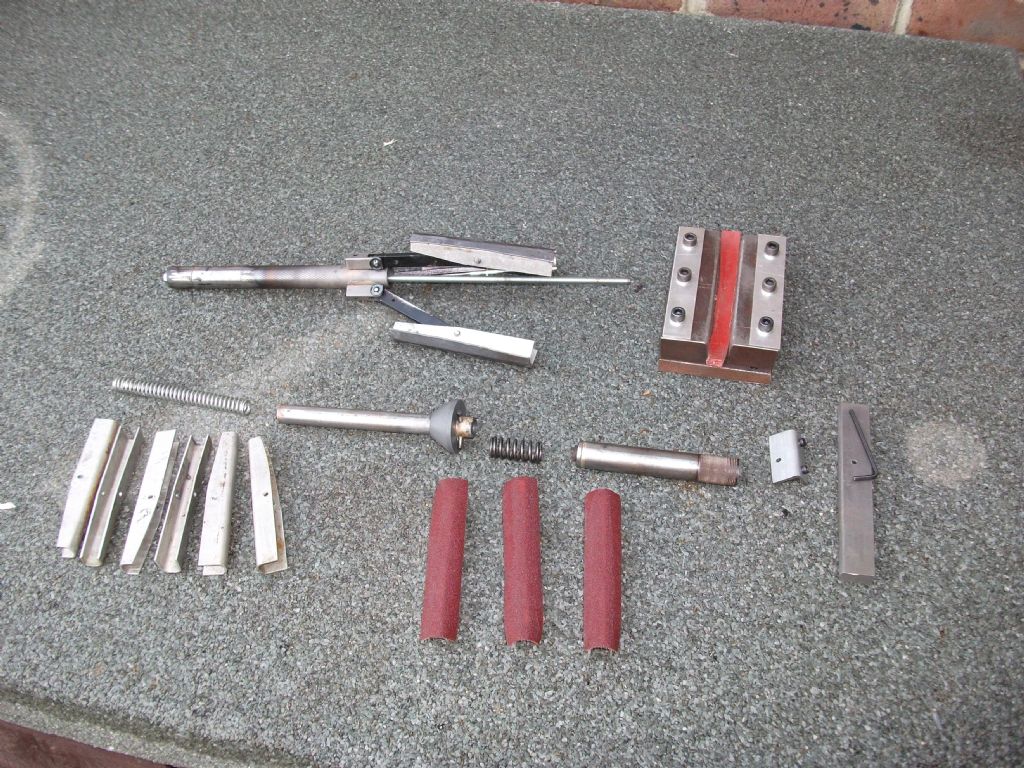

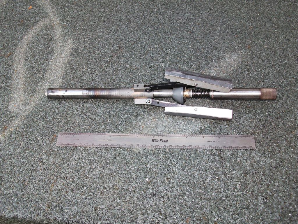

                Published in MEW 207 was this cylinder honing tool, mostly
                made from scrap materials has formed aluminium shoes
                that have suitable grades of abrasive glued on, or lead
                strips which allow for embedded abrasive.
                It fits around 2 1/2 to about 5 inch bores.
                Don't know if that you should leave a cross hatch pattern
                on a rotary pump bore i imagine that it would be an advantage
                to allow the vanes to run in ,in any event using lead strips
                would allow a variety of abrasives to be used.

                    Found a slightly better photo of the parts of this hone, seen here
                    the forming block and die on the right and on the left some
                    pressed aluminium shoes.
                    Using the die the abrasive strips are glued to the shoes
                    and pressed on a rubber strip until set.
