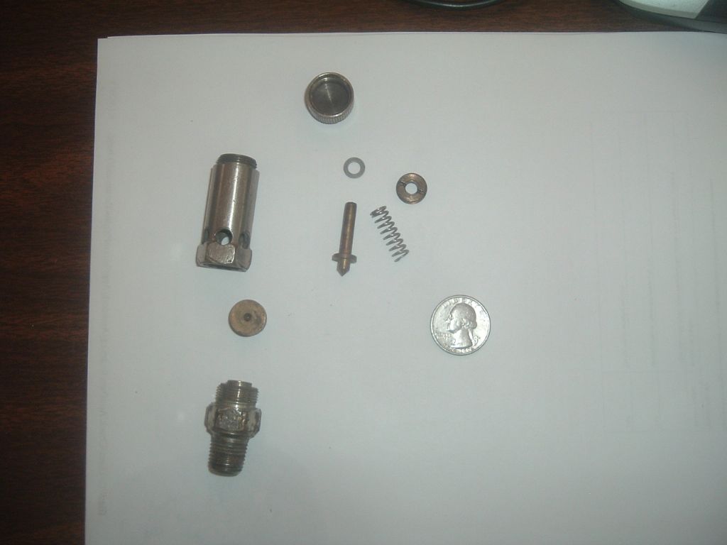

              I have, what I believe to be a domestic steam heat radiator relief valve. I found it in my Dad's tool box. I fugure it's got to be 75-100 years old. The coin in the picture is an American Quarter for scale. I would like to make one like it but a bit smaller to use on a model boiler. Think it would work? I intend to make the valve and body long enough to give a good range of adjustment.radiator relief valve.jpg

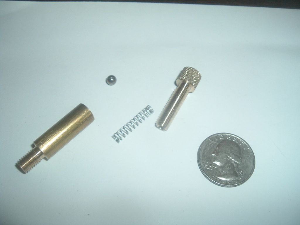

                  boiler safety valve.jpgI have been drawing up a set of boiler fittings for my first build. As I'm a yank, I am designing/drawing in imperial and using UNF threads.
                  I have Stan Bray's book, Making Simple Steam Engines, and will probably build my first boiler from the plans in that book.
                  This afternoon, I made an attempt at making the safety valve from that book. Below is a picture of my attempt. I've decided on 1/4"-28 thread for my various fittings. I used the spring from a 'clicker' ball point pen, and a 4.75 mm ball from a cut up ball bearing. I did not make the guide rod as in the book. Do I really need it?
                  The adjustment screw is long to make sure I can adjust the valve to the working pressure that is yet to be determined. What do you think of my attempt?
                  #371677
                  Hopper
                    @hopper
                    Looks good. Where does the steam escape? Holes yet to be drilled, presumably?
                    I never heard priming referred to as foaming in the seven years I worked as a licensed boiler engineer in the USA (Montana). But dialects vary with region over there. Foaming, in my recollection, referred to a lesser form of carry-over of bubbles coming off the surface of the boiler water due to contaminants in the water. Priming is actual drops (in large quantities) of water being carried over. Quite exciting on 24" diameter pipes etc. Like cannonballs going down the lines, which dance around like strands of spaghetti. A sight — and sound — never to be forgotten. Foaming can be more of a silent killer. I was on a crew that had to repair a power station turbine after the operators let the boiler alkalinity get too high and caused foaming. The force of the tiny bubbles of water that managed to get through the superheaters and into the turbine blades generated enough end thrust to burn out the thrust bearings, a white metal arrangement several feet in diameter.
                    But I think you'll be all right with your smaller version! You are in good hands with Stan Bray. One of the greats.

                      Per the drawing in Bray's book, there is a 1/16" hole through the knurled screw.

                          Ah. Didn't see the hole up the threaded spindle. Good idea!.

                                  Chuck The ball would have been better had it been stainless ( rustless )
                                  Roy
                                  #371924
                                  Chuck Pickering
                                    @chuckpickering45941
                                    I believe the ball is stainless, it came from a ball bearing…
                                    #371925
                                    FMES
                                      @fmes
                                      Posted by Chuck Pickering on 15/09/2018 22:07:46:
                                      Very doubtful.
