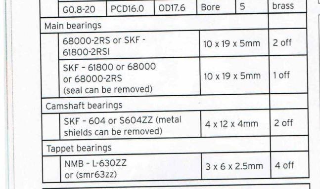

      I seem to have lost the ME pages containing the information on the bearing sizes for the crankshaft and camshaft.
      Could someone either tell me the bearing sizes or the ME issue containing that information please?

        #646178
          #646181
          John Rudd
            @johnrudd16576
            Thank you Jason, just what I need….
            However I thought the front bearing and rear bearings were a different size?
            12 x 21 x 5 and 10 x 19 x 5…?
            Maybe I havent read the drawings correctly?
            #646195
              There was something in the back of my mind that was saying the same thing, I'll get back to you in a while
              #646196
              John Rudd
                @johnrudd16576
                Thanks Jason,
                My comment was based on the dimensions annotated on the drawing for the crank nose housing….the front counter bore being 21 dia. and the rear 19…both being 5 deep. Then the crank journals are different too..
                I am somewhat hampered by not having a full compliment of issues since moving house..I fear some have gone astray during the removal process.
                #646198
                  Yes just looked at my opposed twin version and that is 21 x 12 x 5 on the inner nose and 19x 10 x 5 on the outer.
                  PM sent
                  #646200
                  John Rudd
                    @johnrudd16576
                    Jason, thank you.
                    Agreed, except I put the bearings wrong way round!
                    So to recap, I need two 19 dia and a single 21…
                    I think I got that right.
                    Many thanks for your help.
