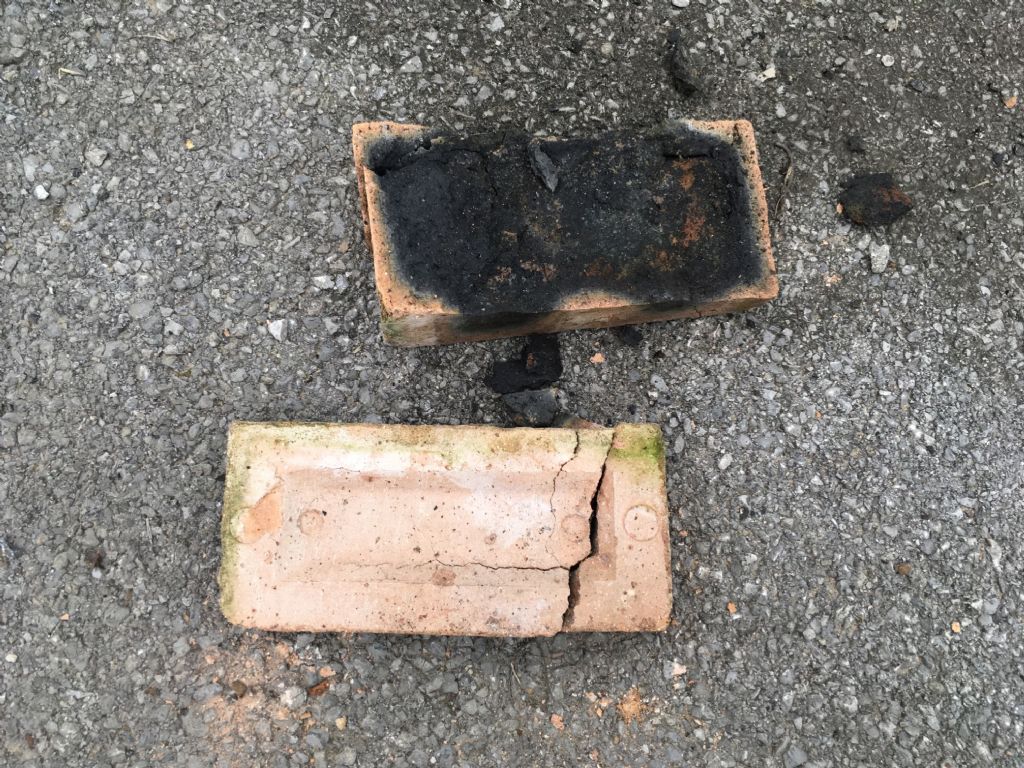

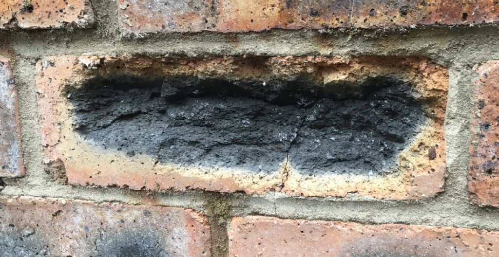

        Several years ago we had a high garden wall built
        Foolishly, I took the builder’s advice and purchased “Scotch Common” bricks.
        We are now in the situation where perhaps one in thirty of them are ‘blown’
        I want to fill at least some of them, before this turns into an expensive rebuilding exercise. Can anyone advise, please, what material would be most appropriate.
        Kindly resist the temptation to suggest JB Weld, or Milliput !!
        Thanks

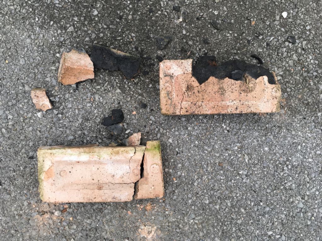

                              Here is the end of the wall … with good bricks and bad bricks:
                              Now one from the stock of spares [which has never seen mortar] :
                              and that same brick after dropping it from waist height, onto the tarmac :
                              and rearranged, for artistic effect :

                                  I'm not a brickologist, but wonder if these are clamp-fired bricks. The clay is mixed with coke or other combustible material, the bricks are assembled into a 'clamp' and fired, and the combustible stuff burns away, leaving a finished brick. One of Dad's friends, Noel Pycroft, used to make bricks this way on Hayling Island. This is different from kiln-firing where the clay bricks are heated in an oven.
                                  Looking at your bricks, the light colour of the outside and the black interior make me suspect that they are clamp bricks which have been fired too quickly and at too high a temperature, leaving the middle unburned and soft. That's much the same effect as barbecuing chicken legs too quickly, where you get burned skin on the outside and raw meat in the middle.
                                  It wouldn't solve anything, but my sense of curiosity would lead me to heat up a sample of the black part and see if it can be made more brick-like.
                                  Is there any prospect of taking this up with the supplier or maker of the bricks?

                                    I will get a gas torch on the black stuff, George, and see what happens
                                    … but it actually appears to be brittle.
                                    Unlikely to get much joy from the supplier after all this time, but I may pop over to see them.

                                          I'd say they are "overburns" which are often sold off cheaply and used in less critical situations such as garden walls.
                                          Commons are not that good in exposed situations to start with and the overburning will make things worse, water gets in, freezes and spalls the face off.

                                                I used to live in a 30's house which had that issue beneath the damp proof course. The front garden wall was similarly affected with some good bricks.
                                                I used the surviving 20% good bricks from garden wall to replace the house ones, you can chisel the old ones out if bad enough. Otherwise it's a filthy angle grinder job.
                                                If your spares pile has any undamaged ones they should be good, but you need either semi engineering bricks for the top of a wall or shaped capping of some kind.
                                                It might pay to leave it another winter to expose the full extent of the damage and buy any replacements after they a have stood in the yard and had a good frost.

                                                    Having inspected the free-standing wall that separates our drive from the neighbour, I am almost certain that several courses will need to come off completely, and it may even be better to have the whole thing rebuilt sad
                                                    I originally intended to put a roof between this and the House, to become a CarPort, and am currently somewhat relieved that I have’t yet done that. [grateful for small mercies]
                                                    Roughly … in the upper half of the wall [which is, of course, exposed to the wind and weather] there are perhaps only 10% of the Scotch Commons which do not have some visible cracking ! … it can only get worse.
