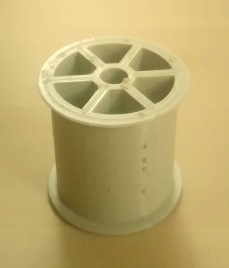

      As suggested in the thread about modelling a cotton reel…
      Here's a new thread about problems with 3D prints… and hopefully how to solve them!
      My problem is blobs on the print..
      I suspect that they occur when the extruder starts and stops..
      Any other ideas..?? and how to stop them!!
      I'm using a Creality Ender 3 V2
      This is what they look like…
      Thanks!!
      Alan

          Looks like your retract setting is too low, so the filament oozes as the head is moving from one move to another.
          Usually a setting in the slicer I think

            I'm using CURA as the slicer… retract is set to 5mm
            I'll try something greater later

              I'm guessing from the amount of blobs, you are running a very low layer height? If so dropping the temp 10 – 15° could help.
              Good luck.

                  I'll try lowering the print temperature (currently 200 C)

                    with that many blobs and seemingly random, i do not think it is a retraction poroblem.
                    Are the blobs solid or hollow?
                    What material are you using?
                    How old is it?
                    One thing I would definitely do is reduce the teperature and see if it improives things.
                    It could be moisture in the filament that is expanding in the extruder pushing out more filament than is needed.
                    hence the randomness of the bubbles.

                      Looks like you are running waaaayyy too hot and too slow imo!
                      Turn nozzle temp down. And print speed up.
                      Could also be a nozzle size/layer height ratio problem?

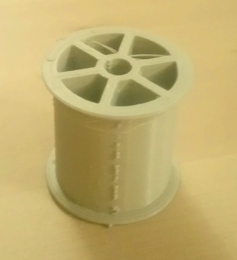

                        I'm currently printing the cotton reel again… Its still blobbing… but not so much..
                        I've lowered the nozzle temperature to 180 (from 200..)
                        I've not changed the retract.. its still at 5mm
                        The material is PLA… only opened the reel a few days ago..
                        I've looked at the CHEP youtube that Lee recommended.. but it seems more to do with the new version of CURA.
                        I'm using CURA 4.13.1 (CURA 5.1 beta won't run on my linux system..)
                        Thanks for all the suggestions!!
                        Alan
                        Edited By Alan on 24/04/2022 17:53:49

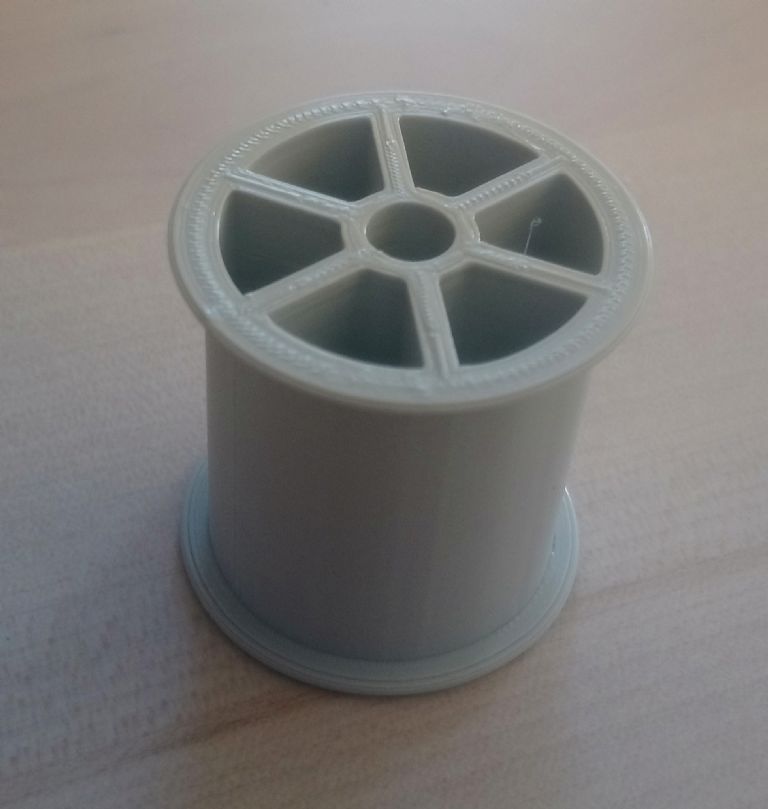

                          So…
                          The 2nd print was just as blobby as the first…
                          BUT… the 3rd print was smooth… !!
                          This was printed direct from the micro SD card in the printer.
                          The blobby prints were printed by using OctoPi..
                          Doing some Googling… it seems that there is a known problem with data transfer on prints that use a curved surface…
                          The slicer chops it up into lots of small straight lines, and this is what OctoPi tries to send to the printer.
                          There appears to be a plug-in to stop this.. so I'll try that next.

                                  So…
                                  I've now printed the cotton reel twice more..
                                  Using the arcwelder plugin in both Octoprint and in Cura…
                                  This one is using the plugin in Octoprint…
                                  Still blobby… and there are some on the other side…but nowhere near as bad…
                                  And this one with the plugin in CURA…
                                  Still blobby… and with none on the other side… but much better…
                                  I think that these simple tests show that using the ArcWelder plugin in CURA gives the best results… still not perfect though… I can see my collection of cotton reels growing as I try to get this working properly!!
