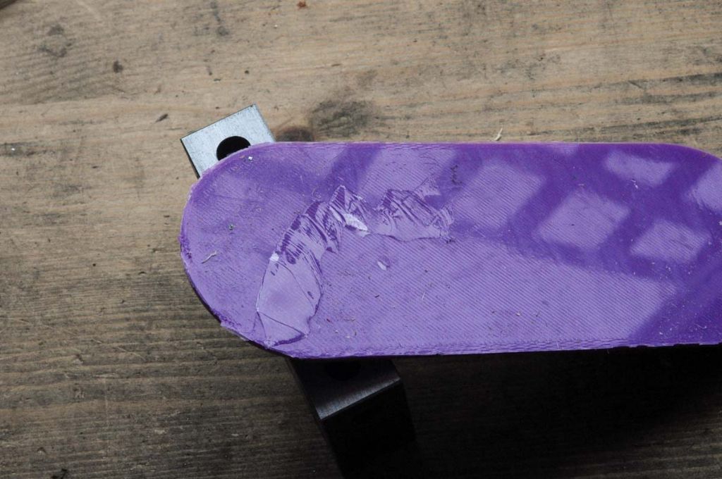

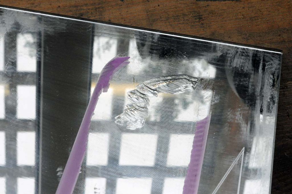

      I hadn't done any 3D printing for a couple of months. So, I fire up Cura and, as usual, download the latest version (4 in this case). I started printing something but after about 5 minutes the PLA filament stopped feeding and broke. Right, I thought, the filamant is old, I'll get some new stuff. Same problem. OK, we'll try a new hot end. Same problem. Close scrutiny of the filament end showed tell tale marks from the drive splines – it seems to be reversing. Go back to Cura 3 and problem solved. After about 1/2 hour the print separated from the bed. I've tried everything I know but the nice new black filament will not stick. I go back to the old filament. Success! Great adhesion, so much so that when I separated this print it brought half the glass bed with it:
      I had a spare.

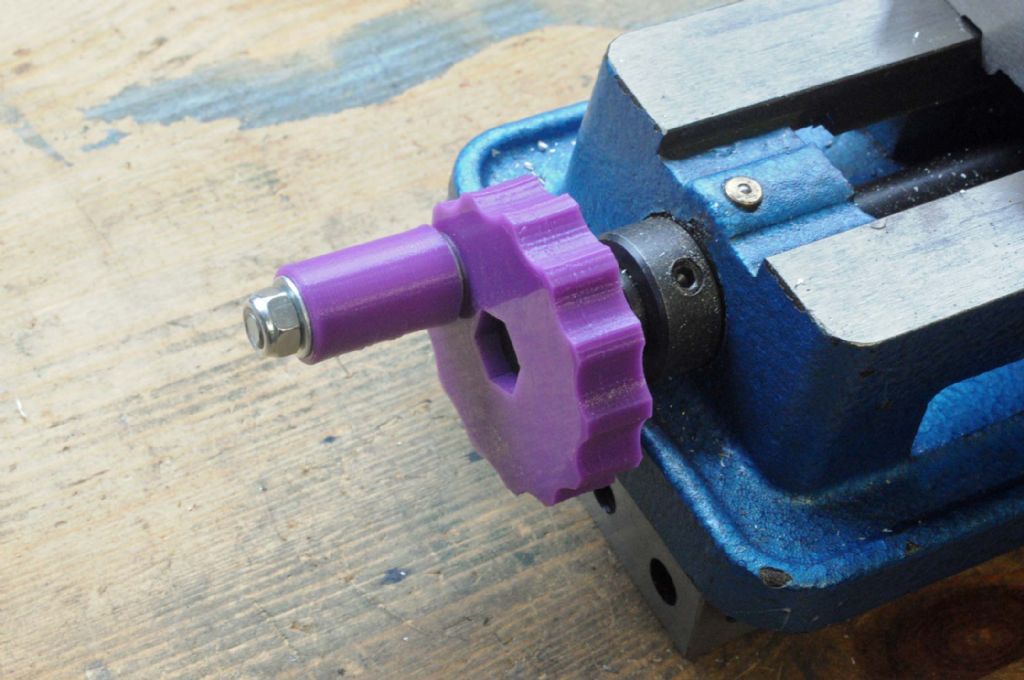

      Anyway, this idea from Neil's book worked very nicely.
      Still can't get the new black filament to stick though sad

                                My printer came with a bit of ordinary mirror as the bed. In the end a similar thing happened, due partly to impatience.
                                I now use a sheet of borosilicate glass with a thin coating of 50/50 PVA/water.
                                I don't have any issues with adhesion (except for a sample of Rigid Ink I couldn't get to adhere for love nor money!)
                                I find things self-release (with a click) if I leave them long enough to cool to room temperature.
                                The glass is also MUCH tougher and less likely to crack or spall.
