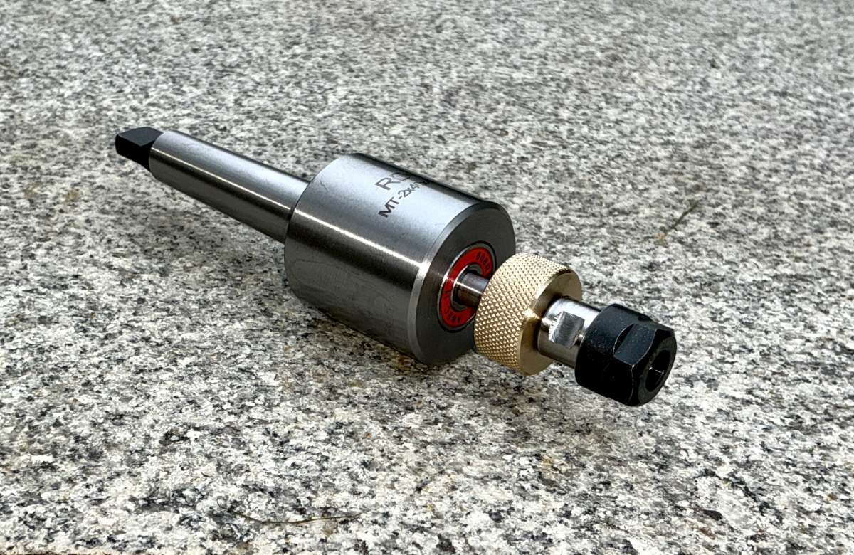

      Are blank end Arbors soft all the way through? Just wondering if I can bore a hole all the way through an MT2 arbor. Or can you buy one with a 10mm hole through the middle?

            If it’s too hard to drill, I’ve lost the cost of buying it! I don’t need a draw bar.

              Not as cheap as they used to be, but I’ve ordered one from RDG Tools.

                    The one I got from RDG is soft on the end and through the middle so drilling a hole through the middle was no problem. 😉

                        I’m just waiting for the collets to arrive now and I can try it out.
                        IMG_5758
                        #819770
                        old mart
                          @oldmart
                          We have a taper turning attachment on the Smart & Brown model A and I decided to produce a MT2 taper. What you need to appreciate is that a Morse taper requires accuracy within a few seconds of arc. I set up the angle using a true running male MT2 in the spindle and a DTI set exactly on the centreline. The tool height has to be exactly on the centreline also. The setup would only work for MT2 as for some unknown reason every Morse taper is a different angle. The MT2 produced was unused for years until I wanted a cutter to go in the pillar drill which has backgear to cut various diameters of Tufnol used to make cable pulleys for the flying banana.
                          Vic, I see a tang on your arbor but no 10mm hole. Is the tool a small rotary broach?

                              It will possibly serve two purposes. The primary purpose for me is as a sensitive drill. In addition it could be used as a small rotating centre with interchangeable centres.
                              Inspiration was from here:
                              https://youtu.be/L0ZTw5J8oTE?si=6ng5kst7cnbtFlDM
