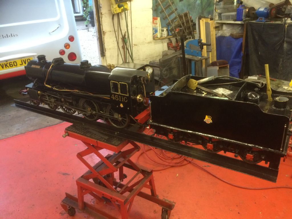

            Just one last thought about the ' locking up' of the motion.
            Are the end of cylinder drain valve holes really at the end of the cylinders ?
            It is possible that they are being covered by the piston as it gets to the end of its stroke.
            This would stop the condensate( water) getting away freely and cause your problem.

                    Well today was a good day with help from boiler inspector at club found the injector after bleeding now filling boiler but its not dry its leaking out of the bottom but is now working with the reeves number 4 injector.
                    The wheels locked up again once pressure reached we took the new Auto drains out loads water came out and wheels became free.
                    i have ordered 4 516 manuel drains at least i know when they are working.
                    Just got to sort the axle pump working now at least i have some hope this time
                    Ron

                            #253694
                            Ron Hancock
                              @ronhancock63652
                              Well some great news at last Julian Atkins lent me one of his working injectors tried it working brilliant.
                              Also fitted 4 new 516 by 32 cylinder drains now working fine no more wheels locking.
                              Also fitted a new 2" by 1 12 oil pump as the other was very small and no where near as good as the one i had from steam fittings well pleased.
                              Just have to make a new reversing left hand threaded as other was so small broke of last week
                              Lets hope i will be able to finally drive it Sunday bet it Rains
                              All the best Ron

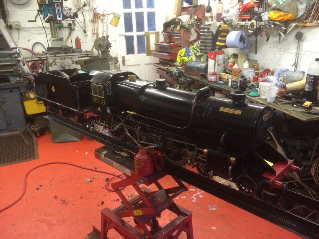

                                        Well if it's not Raining tomorrow going to try her out.
                                        Borrowed injector of Julian fitted new Manual drain valves new Oil pump .
                                        Steamed well in workshop think she will be OK to Run at last.
                                        Ron
