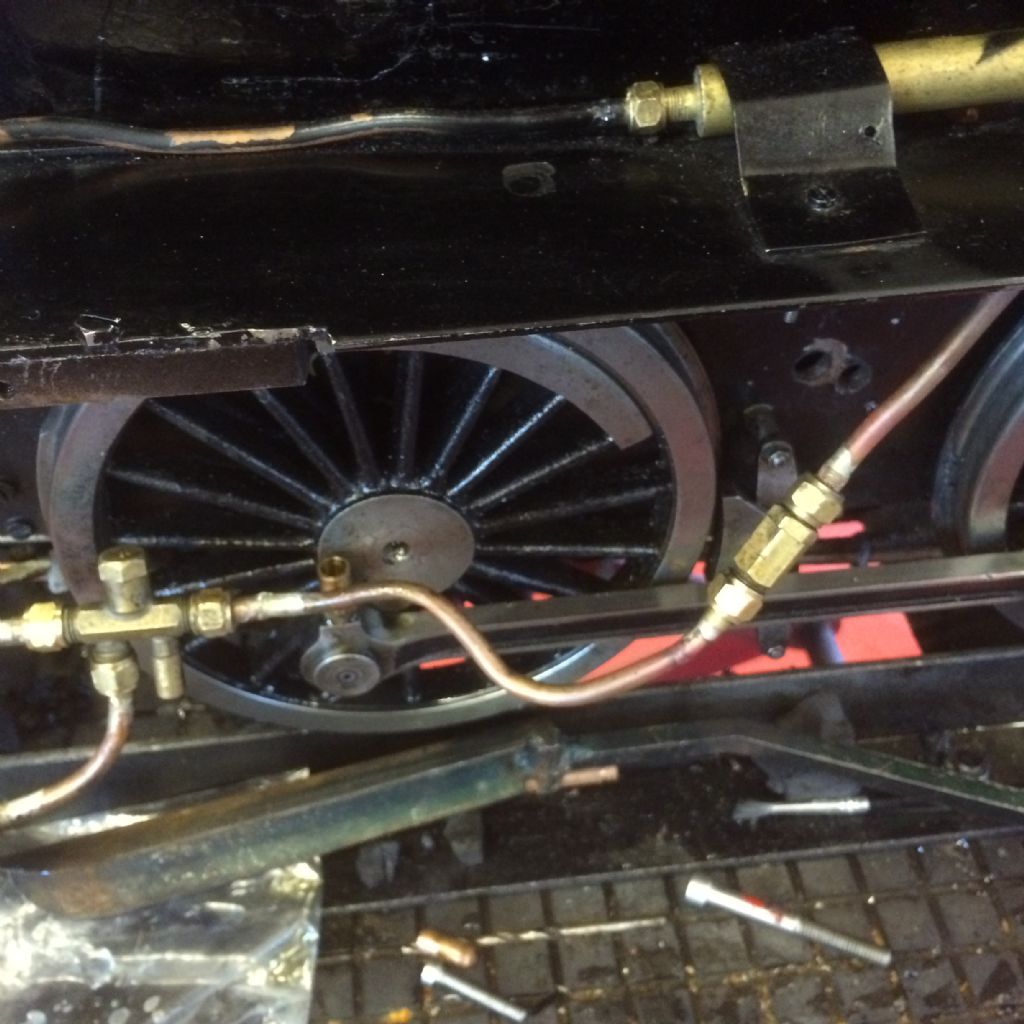

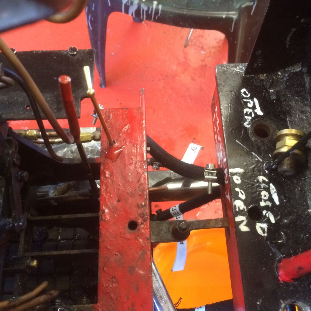

      Well for months been trying to sort water problems on my black 5.
      I have changed all clack Valves as the new ones where leaking and blowing back into tender.
      The injector will not pick up changed the valve at top lowered the feed pipe then fitted new injector made sure got good feed water to injector still not working.
      Now just run Loco on Air to check axle pump working got good feed fitted new Clack valve plus all new pipping.
      Also when Loco gets up to pressure wheels lock I have now fitted 4 new bypass valves although the Manuel ones seemed to work ok.
      I have done every thing I can the ball is free in axle pump took pipe of outlet water was pumping ok.
      No ideas left
      Ron

                  Posted by Ron Hancock on 29/08/2016 19:21:45:
                  fitted feed very low for injector
                  #252919
                  Ron Hancock
                    @ronhancock63652
                    Posted by Ron Hancock on 29/08/2016 19:22:17:

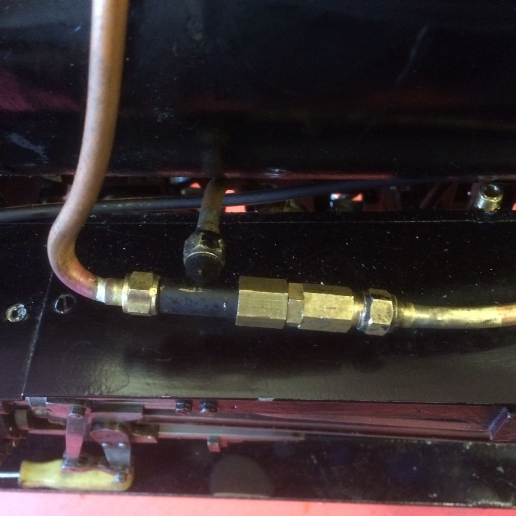

                    fitted another clack valve new just in front of injector as suggested by club
                    #252920
                    Ron Hancock
                      @ronhancock63652
                      Posted by Ron Hancock on 29/08/2016 19:23:27:

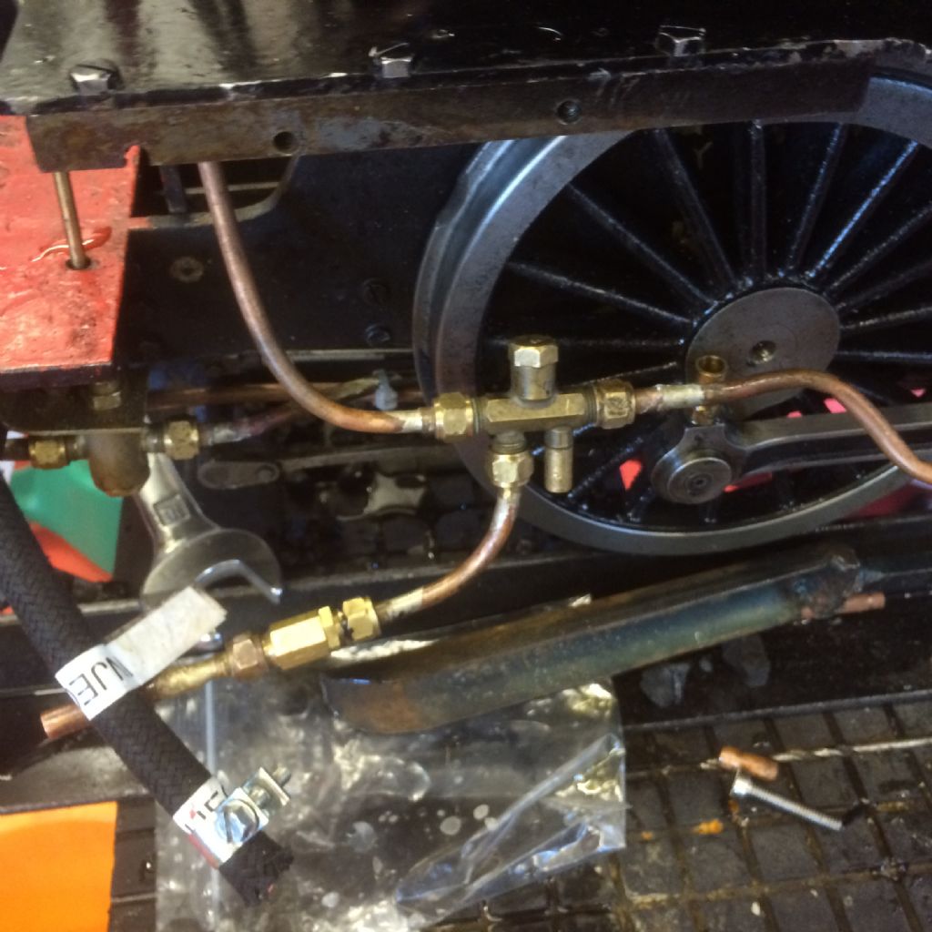

                      fitted two new water valves make sure they work ok plus al new piping
                      #252922
                      Ron Hancock
                        @ronhancock63652
                        Posted by Ron Hancock on 29/08/2016 19:22:56:
                        fitted new clack valve to hand pump and one just in front of axle pump with all new pipes made sure the axle pump feed was vertical

                                I note you appear to have added an inline check valve on the water inlet pipe to the injector. This is unnecessary, and also might be reducing the flow of water to the injector.

                                    Just a thought, but I think you have introduced too many non-return valves on the routes into the boiler.
                                    Perhaps thinking that at least one will work. Not good.
                                    Check the boiler mounted clack valves all work , on the bench.
                                    Take out any other clacks you have added ( that are not needed).
                                    Just get your confidence back by making sure the hand pump circuit works.
                                    Then then the axle pump / bypass circuits work.
                                    Ask one of the club members to try the injector on one of their locos, it is the only way to find out if it works,
                                    unless you have steam raising kit in your workshop.
                                    Keep the pipework simple and well sized.

                                            Hi John i have three clacks fitted one from axle pump that feeds into the Hand pump where i have another clack.
                                            the hand pump works fine i had made sure the axle pump worked before fitting the clack valve it does not work now as i tried it running on air.
                                            On the return pipe to tender with new water on off valve found no return when open and no water feed to boiler and yes the arrow is pointing in direction of flow.
                                            I have spent weeks trying to solve the problem first found clacks faulty i changed for new ones then i was told pipe work was not very good so changed all then changed the water feed valves changed injector for another new one,
                                            I have fitted new auto cylinder drain valves as wheels where locking when steam pressure was raised turns freely on air and when cold.
                                            I just don't know where to start now feel i have tried every thing i can think of and also what members at club suggested but no nearer.
                                            totally failed

                                              Ron, make absolutely certain your injector water valves cannot suck air. There must be glands sealing the spindles, i.e., the handles on the tender. Julian will be your best advisor.
                                                I have double checked for any air leaks so did my club as that was one of the things they suggested.
                                                Seem all ok it was another reason i changed all the pipe work for new just in case.
                                                I fittied high pressure hose with petril pipe clips as stronger than Jubilee so very tight so no leaks their.
