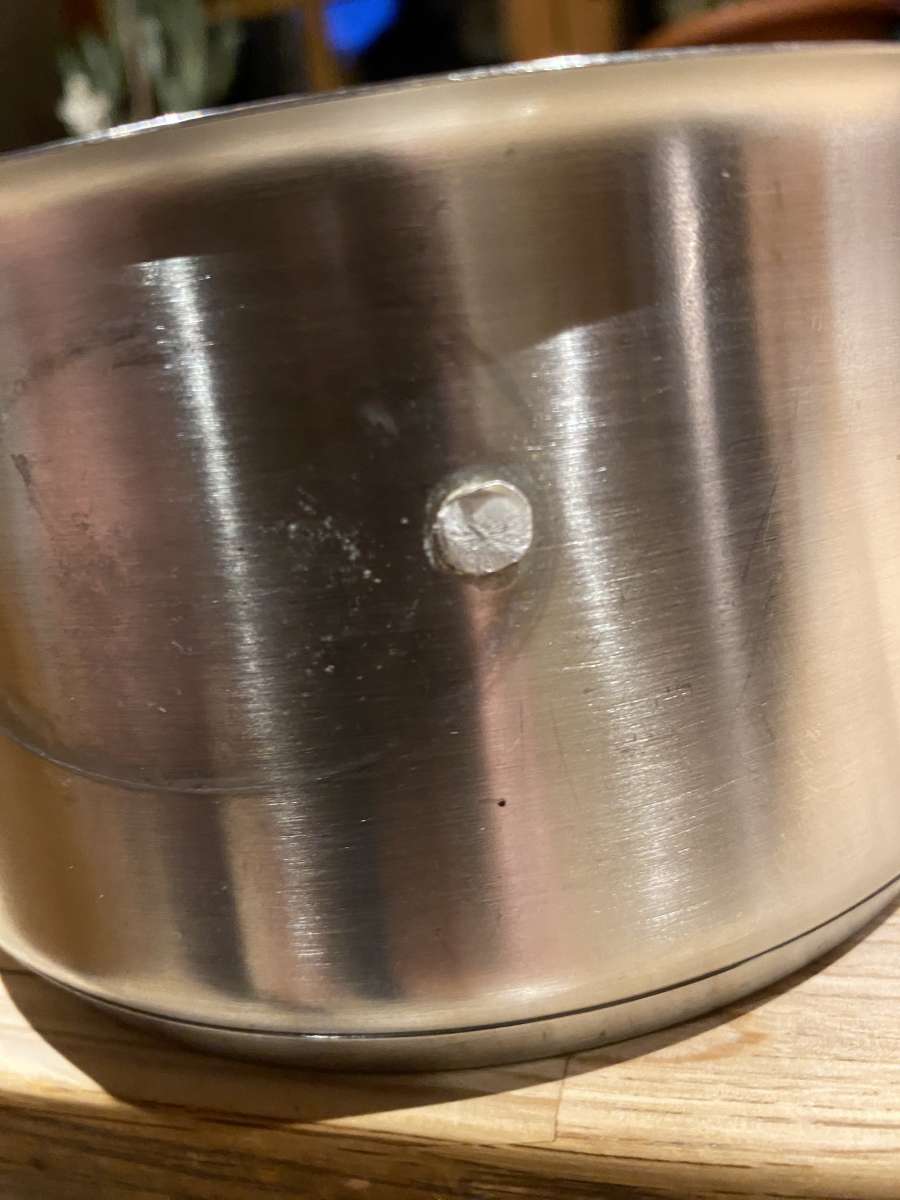

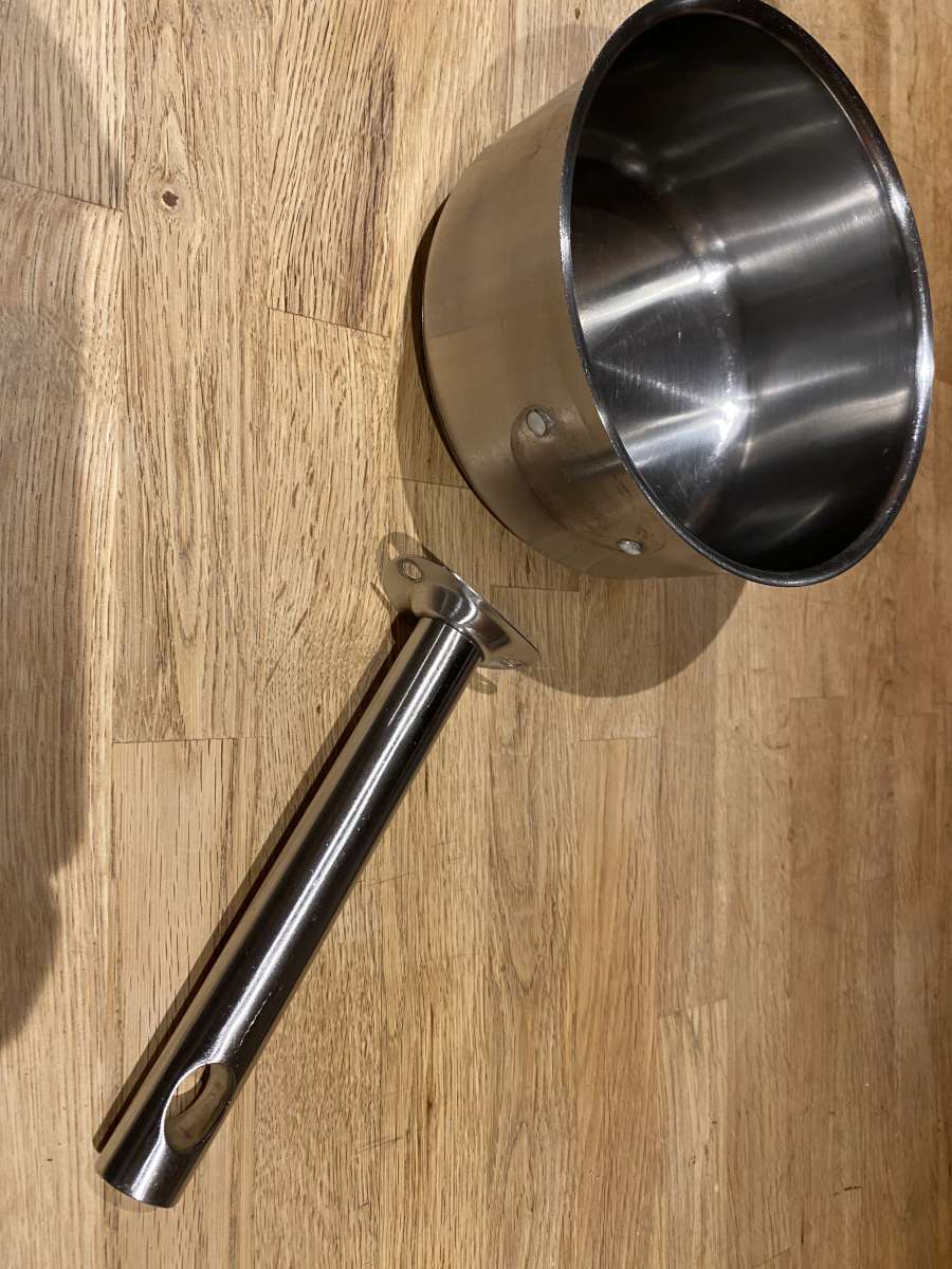

      Lucky escape this morning as the handle literally dropped off the saucepan while taking it out of the dish washer. Lucky it wasn’t full of hot food when it “let go”.
      It’s a stainless steel pan and handle riveted on with “composite” rivets.  I have never seen rivets like these before.  They are aluminium rivets with mushroom heads that have a very thin stainless steel cap encapsulating just the head.
      I guess the pan is 10 years old and is (was) in daily use – now relegated to the workshop.
      So, do your partners a favour and give all your pan handles a good work over and make sure its safe to go into the kitchen !
      IMG_1169IMG_1170

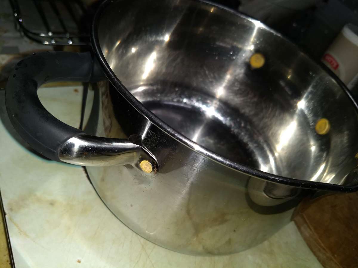

        I had exactly that problem with otherwise excellent quality saucepans from Lakeland who honoured the guarantee and replaced the failure with another one just the same!
        I have since replaced all these attachment rivets with stainless steel button head screws and blind nuts to keep the rest of them from a similar form of failure.
        The silly thing is that these were sold as “dish washer safe”

          Dishwasher tablets are alkaline so will soon dissolve the aluminium rivets. Most of our pans have now been upgraded to stainless screws and dome nuts.

              The dishwasher detergent dissolves aluminium. I had exactly the same problem but, because the actual pot was really good stainless steel I simply drilled the ally rivets out and made up some brass replacements. Worked a treat.
              Brass rivets

                        Well, I was going to consign the saucepan to the workshop, but the management put in a repair request.  Fortunately, I had a couple of 1/4″ mush head aluminium rivets in stock (hoarded away since I did my apprenticeship with Vickers in 1963) , so I estimate that these should give the pan a few more years life! I will carry out a corrosion inspection on a more frequent basis !

                              Onthe SS saucepand and aluminium rivets. It’s not just the dishwasher detergent dissolving the rivets it’s electrolytic corrosion between the aluminum and stainless steel. This will happen with any conductive electrolyte. But being highly alkaline does make it worse because it helps breakdown the aluminium oxide layer.
