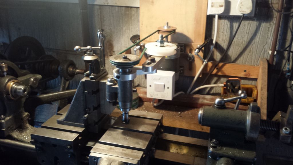

              I am looking to make a detachable geared head drive for my potts milling attachment. I want to able to use the attachment in a vertical set up and turn the drive through 90 degrees using bevel gears instead of the jockey pulleys.
              Just thoughts at present ………. regards geoff

                    #304058
                      The angle grinder gears are spiral bevel gears and ridiculously cheap for what they are. At modest speeds they run happily in either direction, I used a pair on Southam.
                      #305047
                      geoff walker 1
                        @geoffwalker1
                        Hi All,
                        I've decided I don't need a geared head, just turn the motor through 90 degrees and have a direct drive.
                        Think I'm on a winner with this, K.I.S.S. is sometimes the best way!!!
                        geoffpotts spindle with direct drive

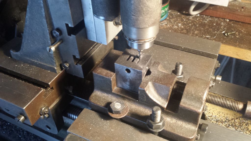

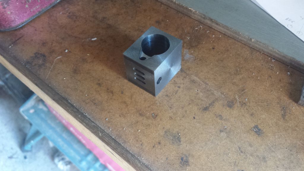

                          #306886
                          geoff walker 1
                            @geoffwalker1
                            Hi Neil,
                            Thanks, I like it as well.
                            Just started my first ever model steam project, a vertical marine engine and have been using the Potts to mill the ports in the cylinder block.
                            I have just upgraded the Potts specifically for this vertical set up, I'll have the details with you soon for your editorial perusal. geoff
