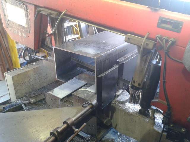

                Hi, I agree with Gaz, as any decent fabrication shop will probably have a power saw of some type to cut it.
                The last industrial bandsaw I ever used, would have cut it without any problems, and would have done it within ten minutes.
                2016-05-17 11.59.50
                Regards Nick.
