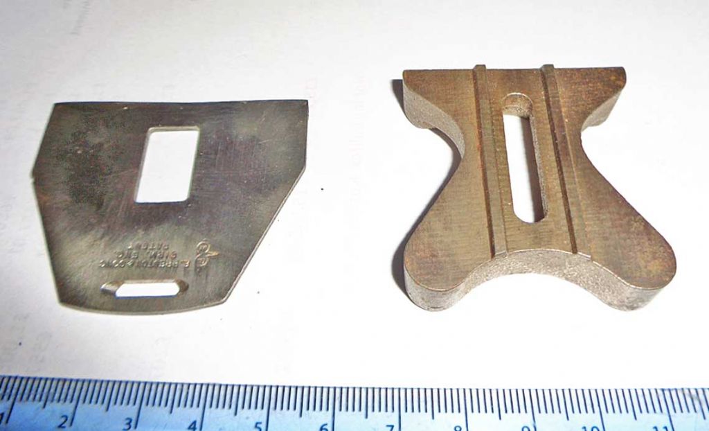

      Hi All,
      I am looking into having some small parts made and have no experience of the best way to proceed.
      One part is a thin ( approx 2mm) blade as shown so needs to be in tool steel and will be in to slightly different sizes
      The other part is originally in cast iron which has then been machined on 2 faces. It is approx 46 x 42 x 11.5 finished.
      I envisage getting 20-50 of each part made if possible.
      I am happy to model these in Fusion 360 subject to getting the models inspected by someone with more experience than myself before proceeding.
      I have no idea of the methodology of getting this done or the viable options available and of course whether the cost can be economic.
      Laser cutting, water jet, and casting are the options I guess?
      I would appreciate any help here please.
      Cheers,
      Martin

                Certainly for the blade, water or laser cutting would be ideal. You would probably need to supply the material as all the companies I have used carry stock of steel, aluminium etc but I doubt anyone has gauge plate (or some other heat treatable steel). I would contact several companies with a DXF outline of the part and ask if they can handle it. There normal jobs would be from 8×4 feet sheets and not all companies will want the bother of cutting parts from strips or small areas of stock.
                Getting the cast part made by CNC I suspect would be uneconomic but I have no experience of what the casting smallish quantities might cost.
                Ian P

                  The Cast Iron casting looks like a good candidate for wax investment casting. You should be able to find a foundry that can do it for you. It is possible to 3D print the core pattern that is then melted out although a proper machined mold for the cores would give a better finish. the foundry may be able to work directly from the Fusion file and make the pattern from that.
                  **LINK**
                  investment casting is very accurate the finish will be as good as good as or better than the finish on the part in your photo.
                  I don't know much about Plane Irons, A quick Google search found a good selection of links on the subject, you are not alone,
                  **LINK**

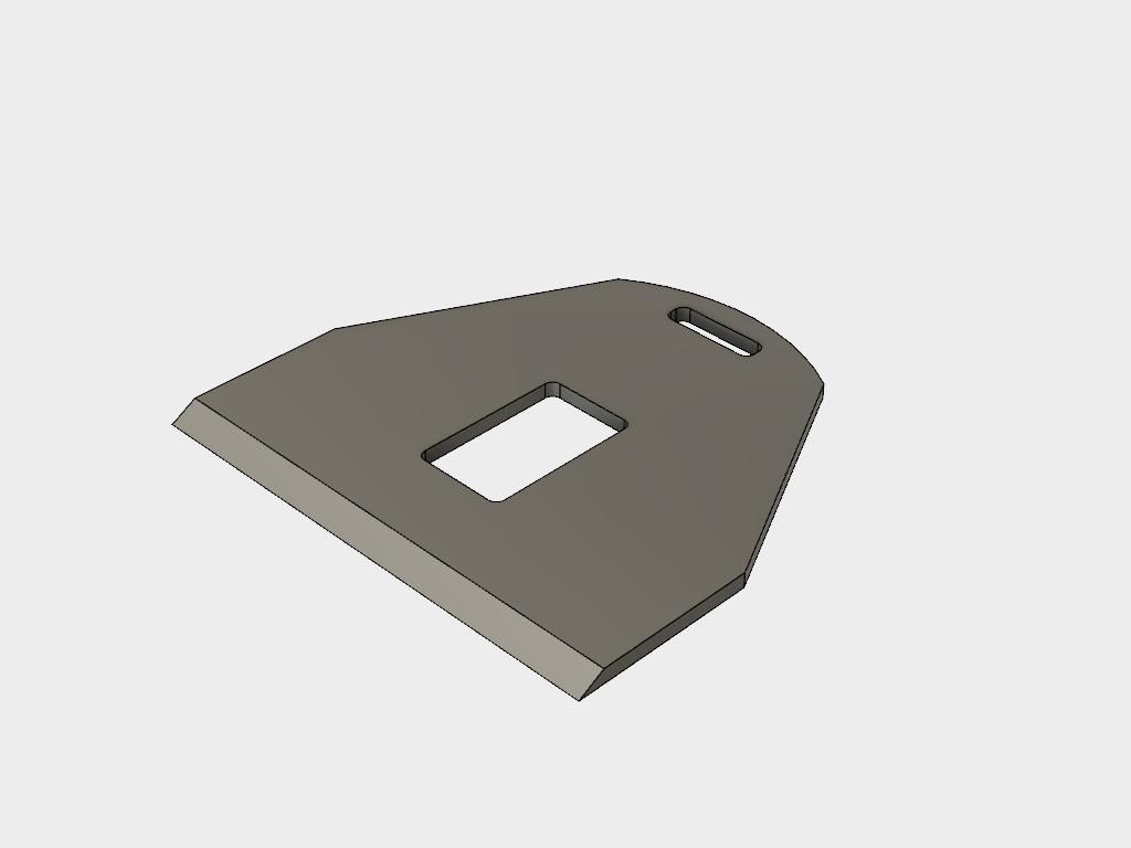

                        Ist attempt at blade in Fusion:
                        #338072
                        Martin King 2
                          @martinking2
                          Have added 5mm to 'replace ' the worn front edge. As is usual on these there is not enough left to give any projection below the sole.

                              Imperial Gauge plate would come in at 1/16" and metric you can get in 1.5mm and 2mm. Quite a few of the aftermarket plane irons are made thicker than original.
                              I suppose it all comes down to what it will cost to have them cut vs what you value your time at. Probably as easy to do them as individual parts with a few simple stops and something to set the angle then you can do one process quickly on them all before altering the setup for the next batch.
                              If you can do the small slot as shown in your sketch rather than how it is cut in the blade then that will speed things up and everything except the bevel could be water jet cut. Not sure if the heat from Laser cutting would make the edge a bit hard, really depends on how slowly the part was cooled.
                              If you produce a DXF file from your drawing that can be e-mailed to the cutters for a quote, try Sciss as they are model engineer friendly, I've used them a few times. At least once you have a price you can work out what method will be best based on what they can be sold for (I'm assuming you won't use them all yourself)

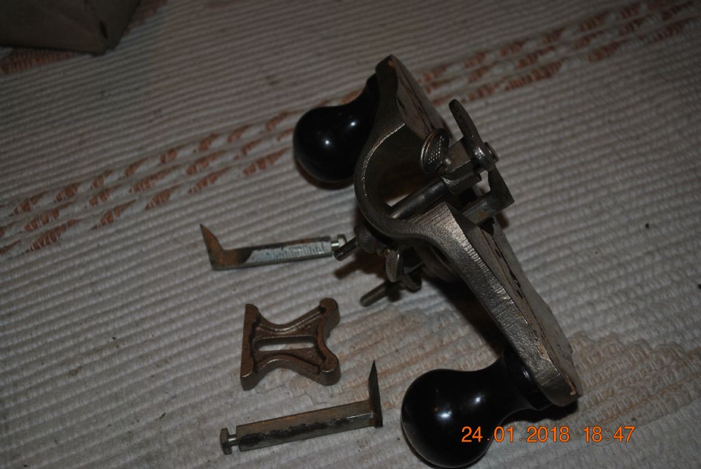

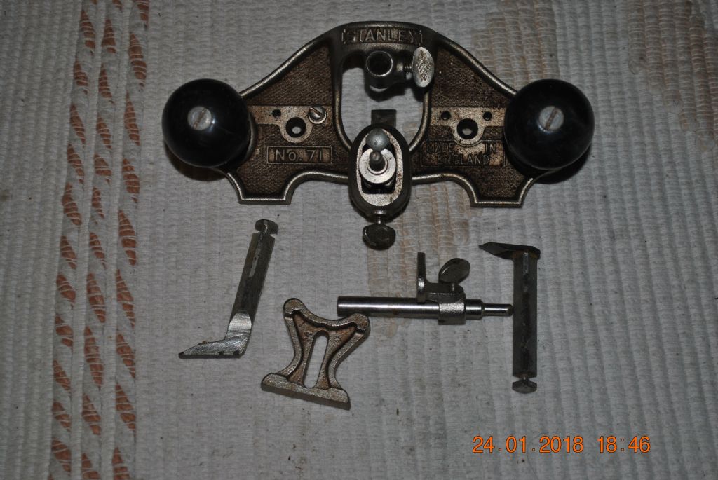

                                            Sam Longley 1
                                              @samlongley1
                                              Stanley No 71 was lovingly known by my joiners as an old woman's tooth
                                              As you can see I still have mine & although old technology & I had a stair trencher that would knock out a matching pair of stair strings in 7 minutes it still came in handy for trimming up odd little bits at the bottom of the trench , especially on winders if the overhead router missed a bit
                                              I wonder if the OP has not been asked to make the depth stop as this is quite useful in some operations
                                              See enclosed pictures
                                              old womans tooth 1
                                              old womans tooth 2
                                              But thinking laterally the cast iron bit does not need to be quite like that it can be in a more rectangular shape in plastic with a slot & an elongated piece of metal sunk into the slot to act as a washer to support the pressure from the holding screw. The side skirts are note necessary.
                                              The end with the hollow is for running against a curved section. The part could be made in something like tuffnol whale & be perfectly adequate & easy to machine in a mill
                                              Edited By Sam Longley 1 on 24/01/2018 19:23:14

                                                    Martin King 2
                                                      @martinking2
                                                      Hi sam,
                                                      These planes are usually found with the depth stop and one cutter, it is always the fence and other two cutters that go AWOL.
                                                      I need to make parts that are as close to original as possible.
