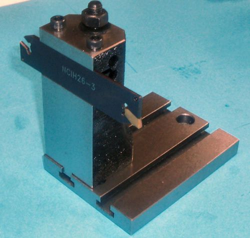

                            John Reese
                              @johnreese12848
                              If you are using a QCTP I strongly suggest a parting blade holder made to fit the tool post. You want to keep the centerline of the parting tool as close to the centerline of the cross slide as possible. The object of this is to minimize sideways deflection of the tool. Such deflection causes the parting blade to bind in the cut jamming the tool and likely breaking it.
                              #390122

                                  IanT
                                    @iant
                                    Depends on the material and its size in my view Ross.
                                    For larger mild steel – I use this rear mounted insert tool (photo below) on my S7 and it will part through 2"+ steel no problem – but the tip is 3mm wide. The only inserts I've broken have been under interrupted cuts – so I revert to HSS for those and move slightly side to side as I go in to ensure clearance. I still use HSS on smaller diameter steel (I have another rear tool post for that) but have purchased a smaller insert tool that I need to make a holder for (another TUIT)
                                    For brass (which is mostly <1" dia) I use HSS (front mounted) tools and they work just fine and are simple to keep sharp. Small diameter work really only needs a thin/short cutting blade which saves on material.
                                    So as usual – the answer depends what you are trying to part – I don't think there is a single 'best' solution (not for my work at least)
                                    IanT
