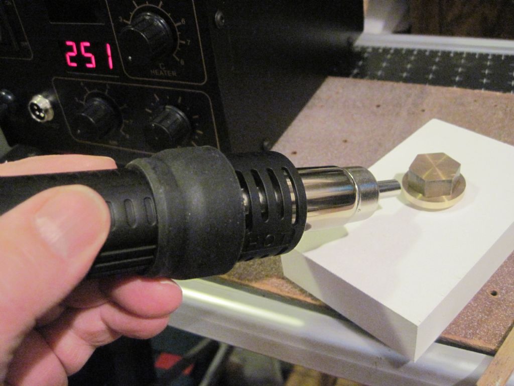

            IanT
              @iant
              I use a very old Weller iron for my 'simple' soldering projects – and I can still get spares for it too, including the temperature controlled tips which work very well.
              However with the increasing use of surface mounted devices, I purchased a hot-air soldering station about two years ago – that also has a more traditional iron included. It cost about £30 back then and I'm very pleased with it. I'd recommend one, as it will cover all of your electronic soldering needs. SMD then becomes quite possible (with a good solder paste) and that is very useful for many newer components which are often only available as SMD these days….
              As a side benefit, I also use the hot-air gun (which is temp controlled) on heat shrink and to melt shellac for wax chucks and other temporary mandrel fixings. I find shellac very useful & convenient and now generally prefer it to using superglue – mostly because the heat gun makes the melting very controllable….

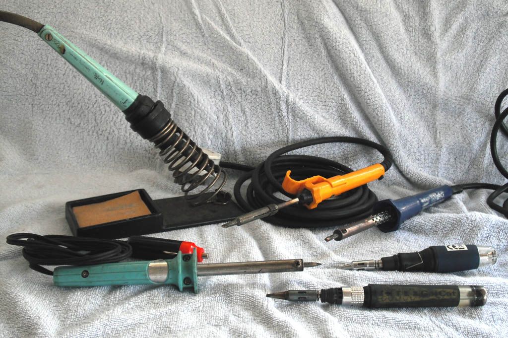

                                      Anthony Knights
                                        @anthonyknights16741
                                        I have had a variety of soldering irons over the years. These are the ones I've ended up with.
                                        Back row left to right- Weller 60 watt temp controlled, 25 watt Antex, dead cheap 30 watt Chinese thing I bought when I was on a job and the iron I was using failed ( faulty element ).
                                        Front row 12volt 15 watt which plugs into a car lighter socket.and finally, two catalytic irons which use lighter fuel gas. Very handy if you are stuck in the middle of nowhere with no access to a mains supply.

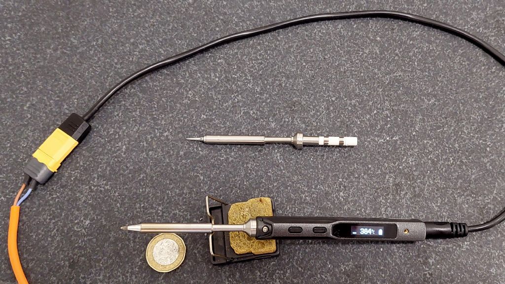

                                              Andrew Entwistle
                                                @andrewentwistle
                                                I can recommend this TS100 60W iron. I use one at work and at home. It requires an external <=24V DC power supply (I use a laptop type mains supply or intercept 24V DC from instruments that I am working on, or from a battery pack via XT60 connector). It is like a pen to handle, warmup to 400C takes only 12 seconds and it takes plug-in bits that contain a heating element and temperature sensor. I run it on open source firmware (programmed via a micro-USB socket) that allows customisation of timeouts etc. I see that the TS100 model has been superseded by the TS80 that uses a USB-C connection for power and interface. ts100 2.jpg
                                                Edited By Andrew Entwistle on 19/07/2021 14:08:53
                                                Edited By Andrew Entwistle on 19/07/2021 14:19:13
