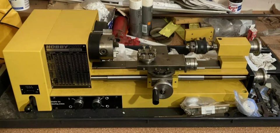

                  Well I've just picked up a 1985 MD65 from a lovely house with double garage workshop in the Cotswolds. The seller who's clearing his late fathers tools said his father had lots of plans to built things but never actually did much. I think he liked buying tools more than using them!?! Anyhow, he had a new Warco 1022 that had never been upwrapped and a Myford along with other "bits".
                  Honestly, I don't think this lathe has been used, there's all the delivery grease over it and there were no "chips" sat in it. No belt dust on the inside of the cover that hadn't even had the hinge fitted to the machine. No sign of the tool post screws being "used". If it has been used it's been cleaned very well as I turned a bit of brass when I got home and got some in the grease, when trying to brush them off I moved the grease (lower arrow in pic). I think I'll have to give it a good clean and set it up.

                    Congratulations with your new lathe, it looks to be in good condition and with the change wheels needed for screw-cutting. Clean off the grease and apply some SAE 30 mineral oil (or way oil) on the non-painted parts. My lathes are certainly covered with chips.

                        That looks to be in excellent condition smiley What accessories did you get? I can see the 3 jaw chuck and the drill chuck as well as what looks like the milling angle plate in the background.

                          As mentioned, change gears, drill chuck, milling plate, there's the hobbymat vice and dust cover as well. No centres but they're cheap enough to buy, no faceplate or outside jaws for the Bison chuck which is a bit of a pain but I've found some from Gloster Tooling.

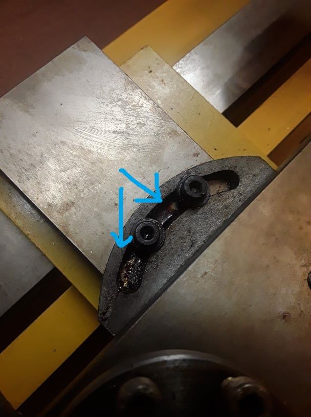

                          Can anyone shed any light on the screw in the middle of this photo is for? I've got on in the "box of bits). The advert says gib strip etc but I can't see in the advert what the etc is or where it goes or what its for on my lathe.
                          https://www.ebay.co.uk/itm/Hobbbymat-MD65-cross-slide-gib-strip-etc-/234250063701?mkcid=16&mkevt=1&_trksid=p2349624.m2548.l6249&mkrid=710-127635-2958-0

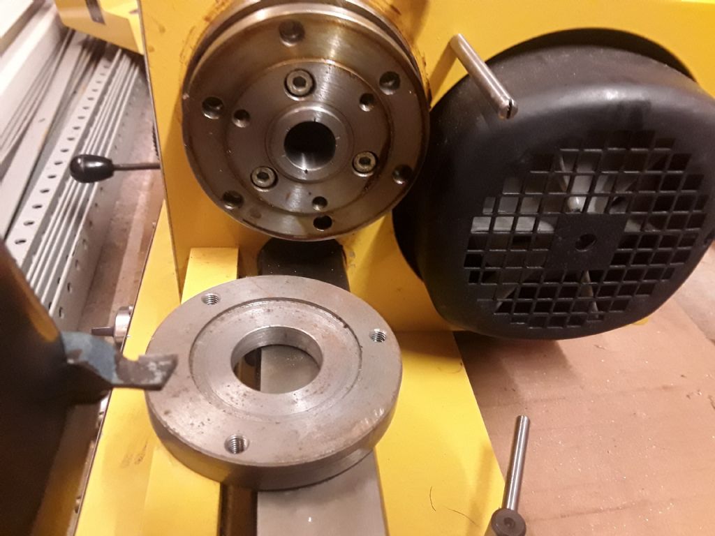

                          Also I have this backplate, although the register is internal which makes me think it's not a backplate, maybe an adapter for a front mount 4 jaw chuck (without the holes and register machined on the face yet)?

                            The backplate is indeed a backplate. It needs the register to fit on the front flange of the spindle, You need 3 studs to go in the backplate (permanently) that then go through 3 plain holes in the flange and you have to develop the skill of getting a washer and nut on them in the confined gap. Small fingers rule.
                              Sorry the screw in the picture of the ebay advert I've linked to.
                              I've seen people remove that flange and make a new one and use a front mount chucks so they haven't got to mess about with the rear studs.

                                The Advert.. The knurled tops of the screw and bar are reminiscent of Hobbymat parts but not sure what they are – the plain bar looks like a 'knocker-out' ?supplied with the milling head.
                                It looks a stiff price (to my mind) unless you are desparate for a gib strip?

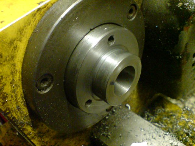

                                The manual advises leaving the spindle flange alone unless absolutely necessary (it's a tightish fit, ?turned on it's matched spindle at the factory) for maximum concentricity, however, (iirc) it has to come off for bearing overhaul, so probably not the end of the world as long as you are careful not to damage or compromise the fit of the spindle.
                                I've always heeded the manual, it'd be interesting to hear other owner's views..
                                I've never felt massive annoyance at the chuck fitting, the studs end up quite close to the edge of the flange – a bit annoying, but not insurmountable..

                                  Hi, indeed DiogenesII is correct, the manual does say that the flange should not be removed and it won't really help much for changing the bearing or cleaning and re-greasing either, however if you are changing the flange for one that you will be truing up once fitted onto the spindle, then it should be OK.

                                          Hi, I don't have one of those knurled screws, but I don' have a belt cover either, both were missing when I bought my lathe and the screw isn't shown in my manual. One thing I forgot to say Tom, is that when you make your new chuck flange, don't forget to drill the three holes that line up with the bearing cover bolts as these will allow you to service the bearings without having to remove the flange again.
                                          Regards Nick.
