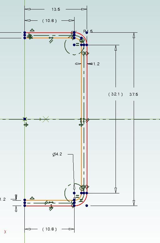

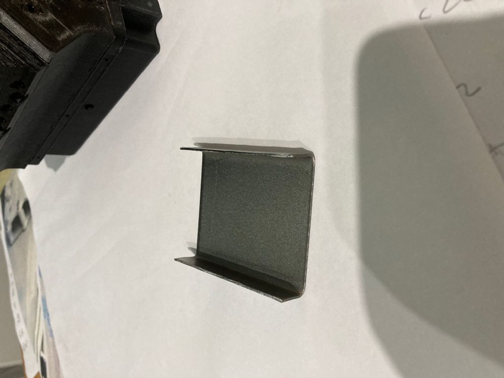

      Does this sound right?
      I started with 1.2 mm thick steel x 61mm depth.
      I bent it in my Sealey 760 metal bender to start practising ready to make the chassis rails.
      The top and bottom flanges are to be 12.5 mm wide and i bent at a line of 13.5 to allow for a 2mm radius.
      Now measuring the total top to bottom and the 12.5mm widths (which were 13.5) it comes to 64.5, its grown, glad i got plenty of scrap.

          You need to measure the neutral point which is just less than half way through the thickness of the metal if I remember right. The outside dimension increases and internal decreases.
          #502557
          DollyDigger
            @dollydigger
            i thought overall it would be about the same, but 4mm increase…wow
            #502563
              Yes thats about it. Assuming this is what you measured as 13.5mm flanges and a 37.5mm leg to give the 64mm overall then if you measure the green lines which I have drawn mid way you get 10.8 + 3.3 (1/4 circle) + 32.1 + 3.3 + 10.8 which totals 60.3. thinking again the neutral point is just beyond half way not below so that would make it abit longer and give your 61mm starting width

                  Sheet metal bending is not so simple! The neutral axis is never a fixed axis – it depends on the material thickness, the bend radius and whether the elastic limit of the material is exceeded in the bend. There are tables that can help you with this, but unless you know exactly the sheet material grade, its temper, etc, ….
                  The safest way for the home shop is to bend a trial piece – say a piece of material 50mm wide, 200mm long, scribe a bend at 50mm from one end, into the brake long end first, bend tight on the line, and then lay the long end flat on the table, short end upright, and measure the height with a vernier. The delta from 50mm allows you to calculate the bend allowance, which will give you the end points of each bend. The sums from then follow reasonably easily…

                    Thank you Jason thats a great pic and helpful.
                    Thank Joseph as i think you hit the nail about home practise until its right, this is what i have done.
                    To get my req piece size of 12.5 x 50 x 12.5 mm i ended up with a 72mm strip, bending it a 11mm in from the edge with the tightest radius the bender could accommodate

                      Bending to a specified length is probably the leaste accurate of the fabrication & machining processes.
                      The neutral axis for thin sheet metal is approximately in the middle of the sheet but for thicker plate moves closer to the inside edge of the bend. (depends on material properties of the bent part). An approximate position for the neutral axis for 20mm plate is about 1/3 of the distance from the inside edge. (Metal stretches more easily than it compresses)
                      If you are not accurately calculating the bend dimensions with a formula and the correct metal properties, do a test bend first. Material does not have to be very wide, just the same thickness and type.
                      Some of the better 3D CAD systems (I use Solidworks) have a sheet metal function that calculates the position of the bend line of the metal sheet in the flat position prior to bending.

                        You really do need to know your materials in this game and not just a piece of steel covers all
                        Thanks for that Paul, i gave Jason's diagram a real good go over until i was fully conversant in how it all comes together and i really feel i have a much better grasp on metal bending, thanks to all.

                              Paul is correct; the neutral axis is not usually at the midpoint of the material, but is closer to the inside of the bend. I normally do sheet metal design using the sheetmetal function in Alibre CAD where the K-factor is 0.33 by default, ie, the neutral axis is one third of the material thickness from the inside of the bend. Assuming that a box and pan folder is being used the other important factor is the bend line, ie, the start of the bend. This is where the material is clamped. Based on previous work if I made the part shown I'd expect overall dimensions to be within 0.1 to 0.2mm.

                                  I had forgot about fusions sheet metal , cheers gary, that was sooo easy, although it came up with 69.7mm and i double checked the settings, the only bit i am not sure of is what the k setting should be, i put 33
