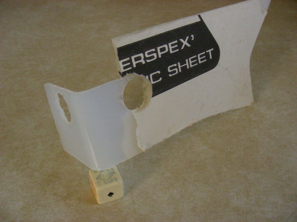

                            I think your hot air gun with cylindrical former is well worth trying. By a modest coincidence, I tested this method of bending acrylic just the other day using the high setting on a cheap B & D hot air gun.
                            I should perhaps point out that the material is some decades old and its brittleness is apparent from the holes which were probably made with a hole saw. I didn't use a former and just continued heating until the sheet was willing to bend. From previous attempts I know that overheating causes undesirable bubbles.
