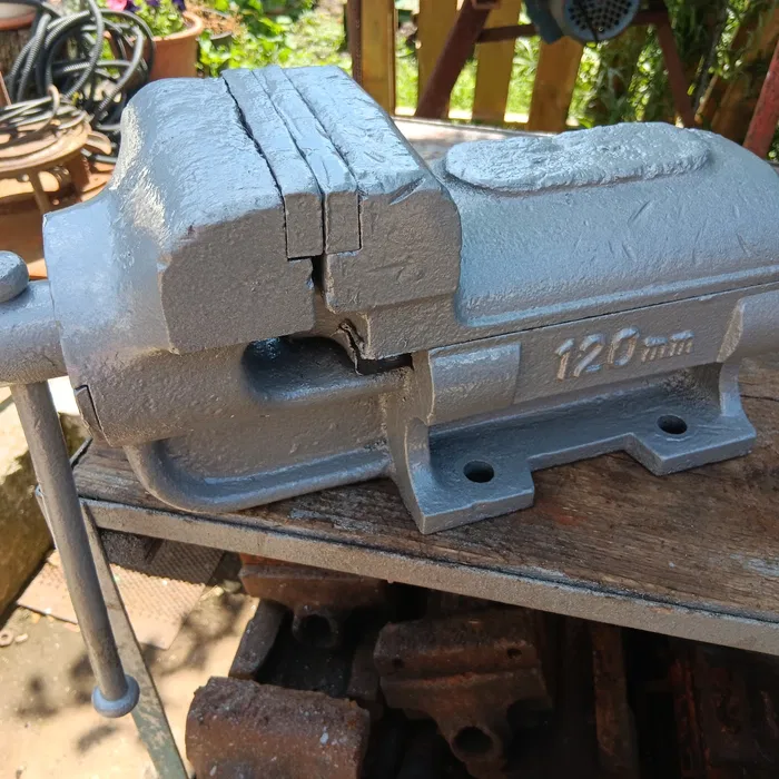

                      Sonic Escape
                        @sonicescape38234
                        I have one of this. I like it a lot.
                        #803472
                        Clive Foster
                          @clivefoster55965
                          Sonic Escape
                          Thats an interestingly different approach to vice design compared to the traditional Record et al.
                          Having the moving jaw at the rear with proper dovetail guides must mean that the jaws close far closer to parallel than the usual Record type where the font jaw moves and is a rattling fit in the body. The extra Vees cast in for gripping pipe or round looks a really useful feature.
                          Allowing for total lack of experience in actually using one I suspect I’d be really happy with a baby version to replace my Record Imp as a general purpose small stuff “precision (?)” bench vice.

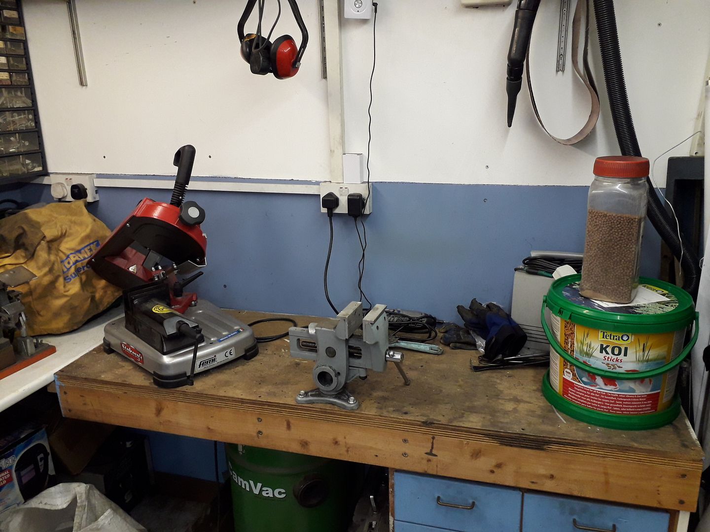

                            #803499
                            Sonic Escape
                              @sonicescape38234
                              Interesting that Heuer vice. At a first look it doesn’t inspire to much strength. It looks like it’s made of sheet metal. But the specs are encouraging. Unlike most vices it is made of steel.
                              The Unior vice is indeed expensive on that site. I paid much less for it but I bought it in Romania. Also multiple sizes are available. They start from 80mm.
                              On Clive Foster Said:
                              Sonic Escape
                              In Romania that is the traditional style for vices. For many decades during the planned economy and for some time after this was the classic vice. Everyone had one of those. They came in many sizes, from 80mm to over 200mm. Many still look for them, believing that anything done in the past is better.
                              The Record style we call them English vices. It reminds me of when I first saw one in the 2000s and I wondered why it was made like that 🙂

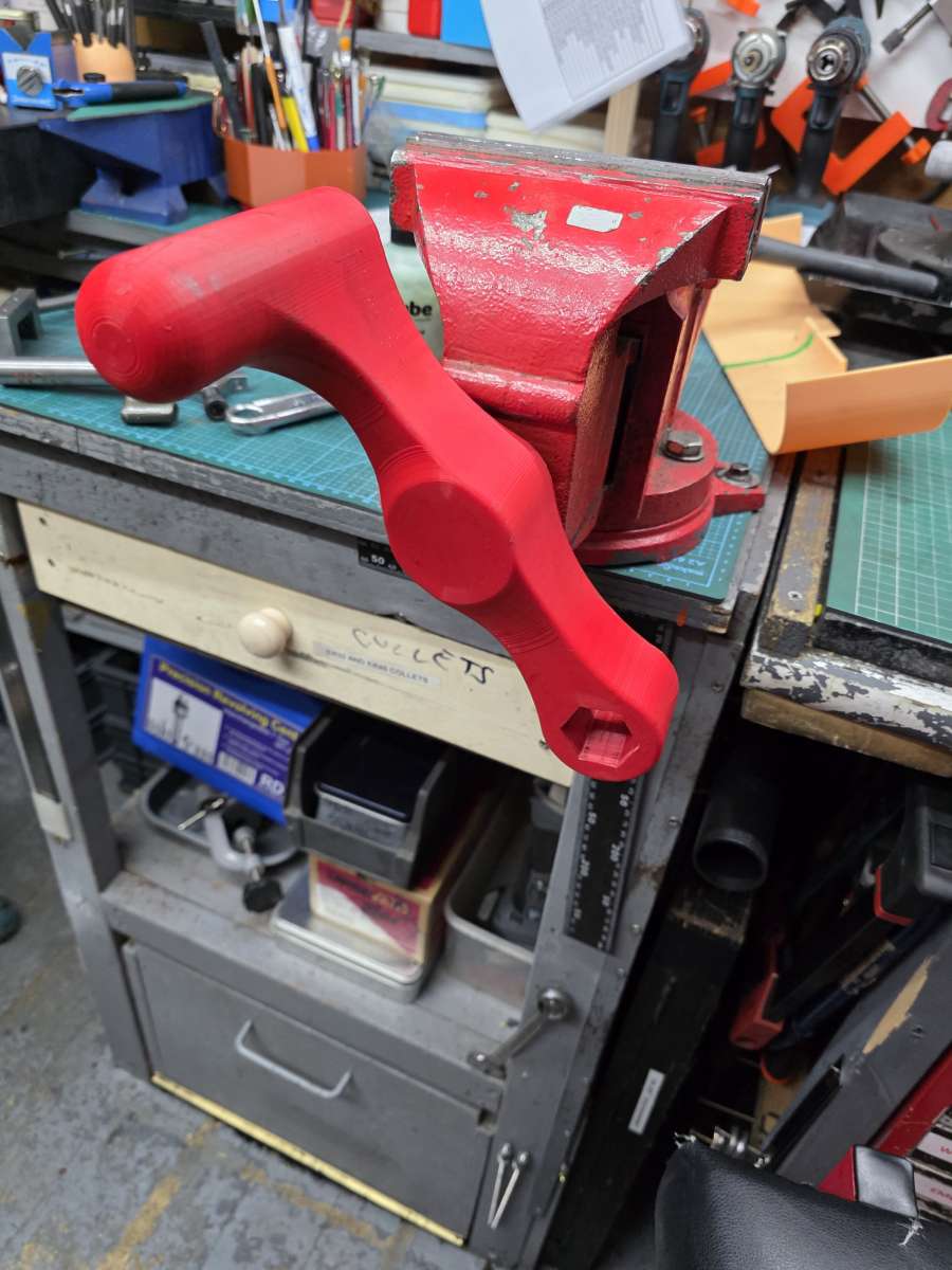

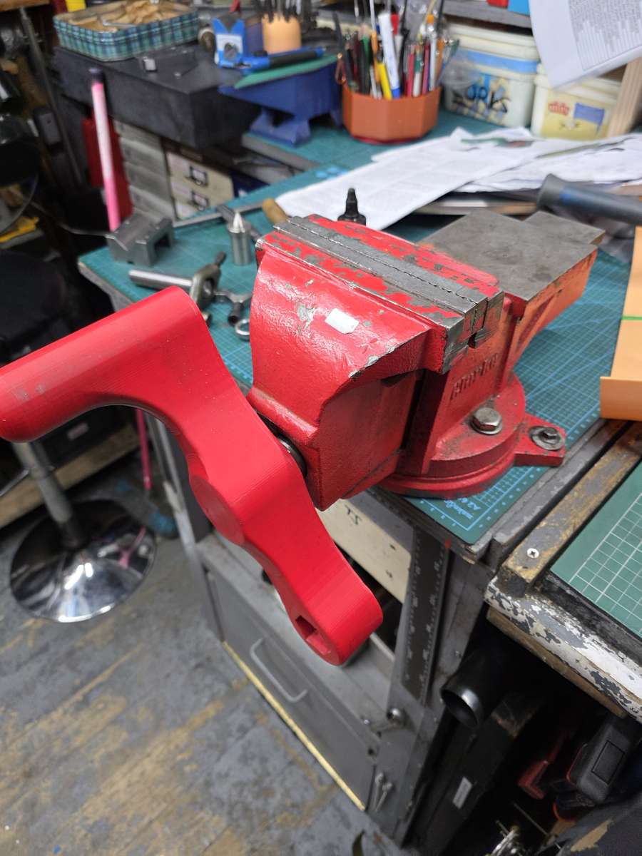

                                jimmy b
                                  @jimmyb
                                  I’ve got a 6″ one from Machinemart, must be 15 years old. No problems whatsoever!
                                  I did remove the handle, mill a hex on the shaft and 3d print a new handle. This works very well and has been in use for a few years.
                                  Jimb

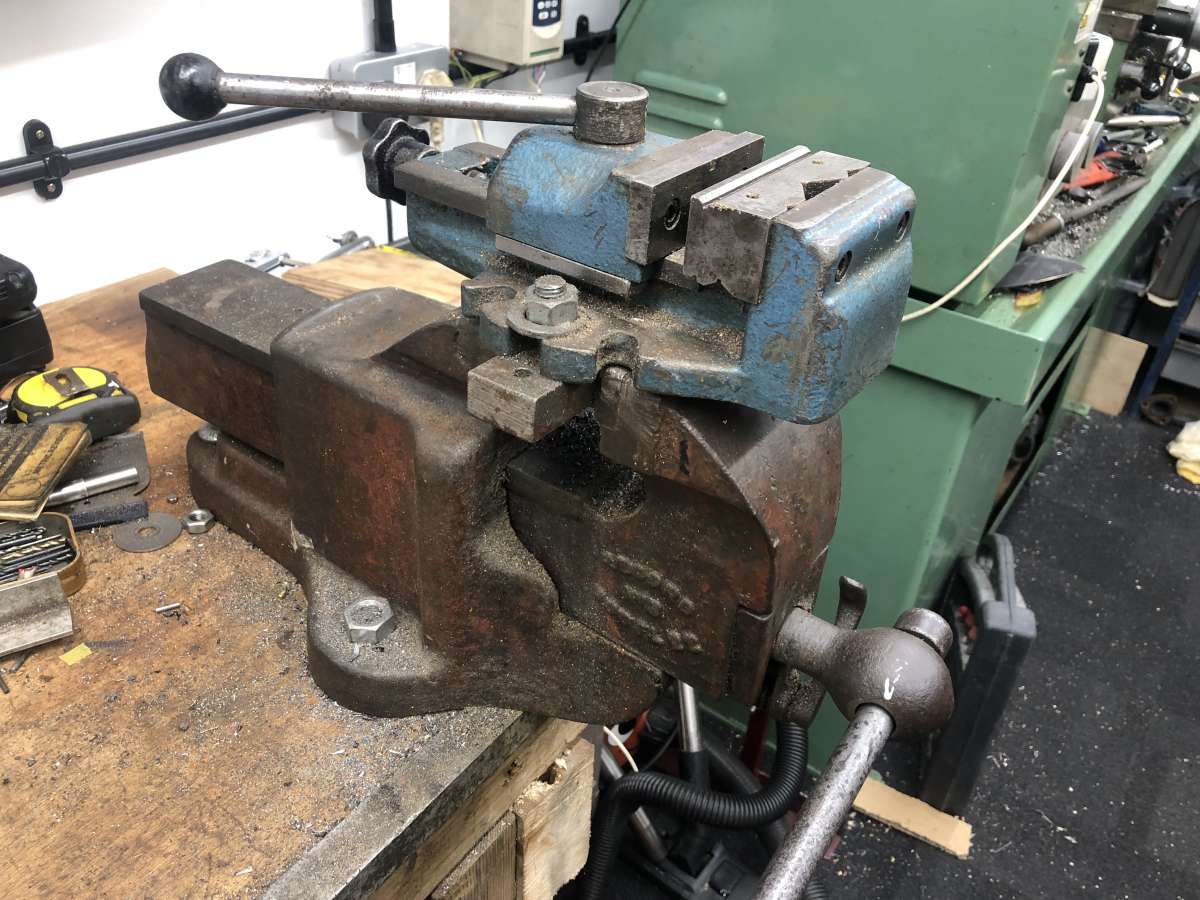

                                              You need to be a bit careful about generalizing when talking about a “Record” vices. You can buy a new one for £50 from the likes of toolstation or you can spend over £1000 from one of the industrial suppliers on one. Like anything else you get what you pay for and need to decide on what you really need and how deep your pocket is.
                                              To some extent what you plan to get upto comes into it, For a number of years I managed with a 2.5″ record of my fathers which was fine for several Stuart size models and Minnie. It was only after being given an old Woden with cracked steel jaw that I went upto a 4″ and even then a lot of the time I use a much smaller vice held in that one, when you are making engines that will sit in the palm of your hand there is less need for a large vice.
                                              20250619_182331
                                              I’ve also got one of the Parrot Vices that Axminster sell at the other end of the workshop, the swivel as well as being able to lay it on it’s side have both been useful features but I would not be trying to bend a bit of 12mm bar in it.
