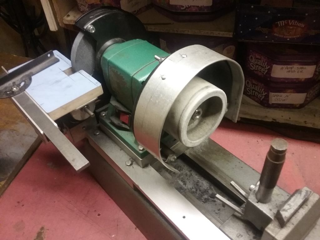

              Thanks Simon for your detailed reply, I have a white cup 4" at one end and fit diamond cups at the other, the supplied guards are awkward to fit around the cup so have made my own not sure if it is adequate,will take a pic

                Perhaps I should add a guard to front, in mitigation I always wear a full face visor

                  Thanks for the picture, and of course any guard is better than none. But please please please bear in mind that most full face guards are not impact rated. If you do get hit full in the face a typical face guard won't be enough.
                  That gets us into another subject being the impact rating of eye protection, goggles etc. I don't feel competent to offer advice here, even though my risk assessment was incomplete without identifying remedial action and the effectiveness of those measures. I only did half the job!
                  Any one able to comment on how eye protection is rated?
                  Good luck! Simon

                    Fair comment will see if I can improve the guard. Will be interesting to see comments on impact ratings we,do put our faith in them

                      My initial worry in the photo is the distance between wheel and toolrest in the background. Now that is scary.
                      Never, ever use a grinding machine (or any workshop machine) without safety glasses. They are cheap and nowadays usually comfortable .
                      And as for having a machine thats not bolted down, thats another story. You will be telling me next, you hold the piece being ground in gloves. Ahhhhh

                        The toolrest is adjustable and can be slid nearer the wheel, it just happens to pulled back and would be advanced when grinding, it is just a mock up design for a more robust rest which I am making, thanks for your concern though,not sure about bolting down because it is to the bed which weighs about a hundredweight, anything else to criticise? Always keen to learn and I'm sure you have my welfare at heart
