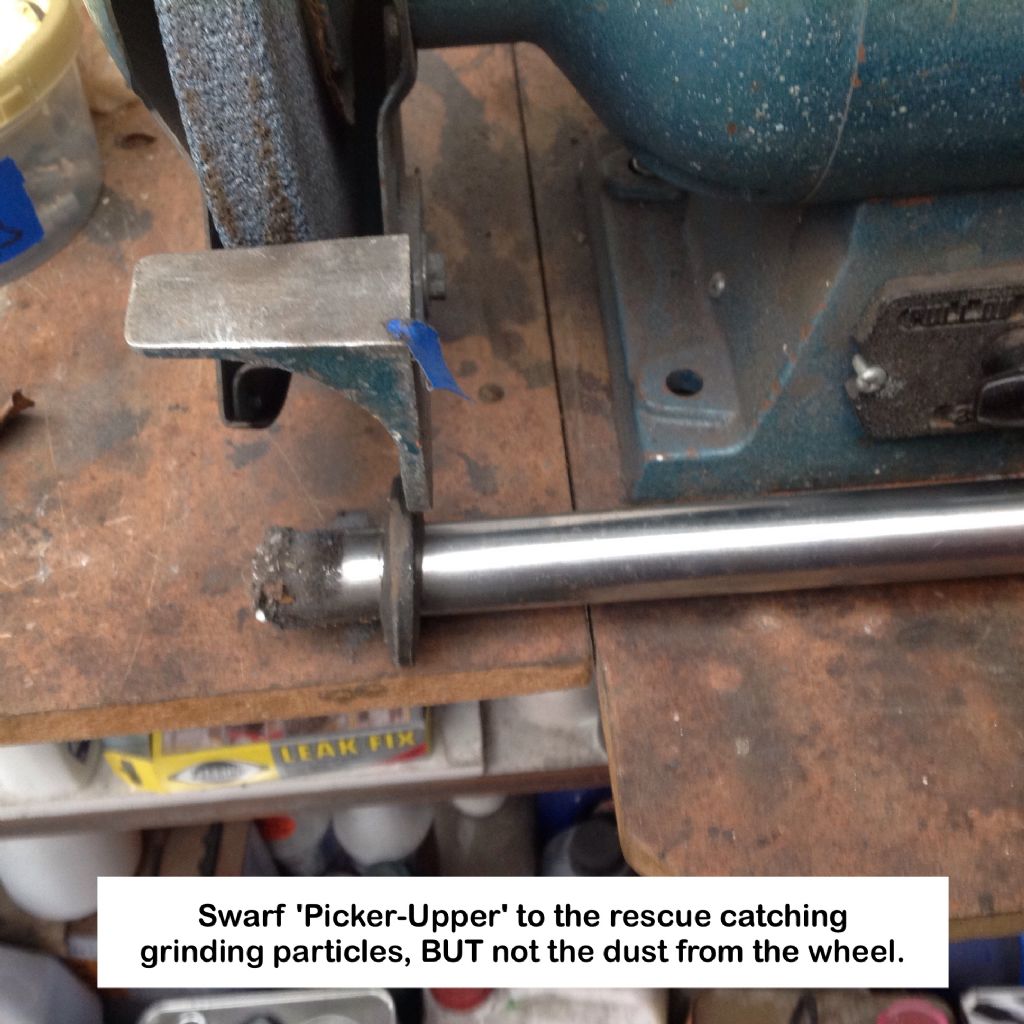

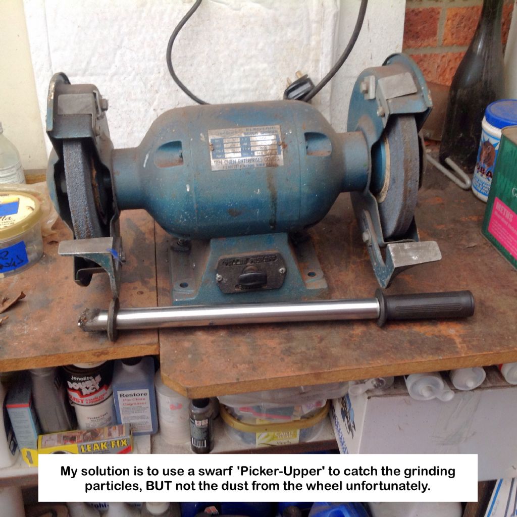

                        My solution that has worked a treat for capturing the metal bits, BUT not the dust for obvious reasons.
                        Grinder is in the Carport for the above reason.
                        Annotations say what that magnetic 'wand' does, and it also picks up 99% of swarf generated by my machines when I clean as well as from the floors in Workshop and Carport wher a surprising amount lands when I forget to use the 'wand'

                          Good idea ouballie you have me idea how to used old speaker magnets norm
