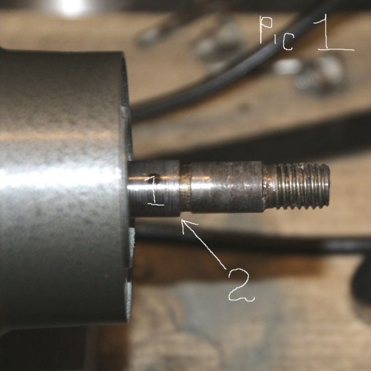

        I have several bench grinders all of an eastern persuasion and all have the same design of grinding spindle nose as shown in pic1.
        The problem here is the miniscule "flange" arrowed at "2" which is supposed to help stop the wheel from wobbling from side to side.
        I bought yet another grinder from the boot last weekend for a couple of quid and on trying it out when I got back home I could see why they wanted to get rid of it. One of the wheels was running so far out it was dangerous to run it up to speed, so I have set to and come up with a mod which corrects this problem on these cheap Chinese machines.

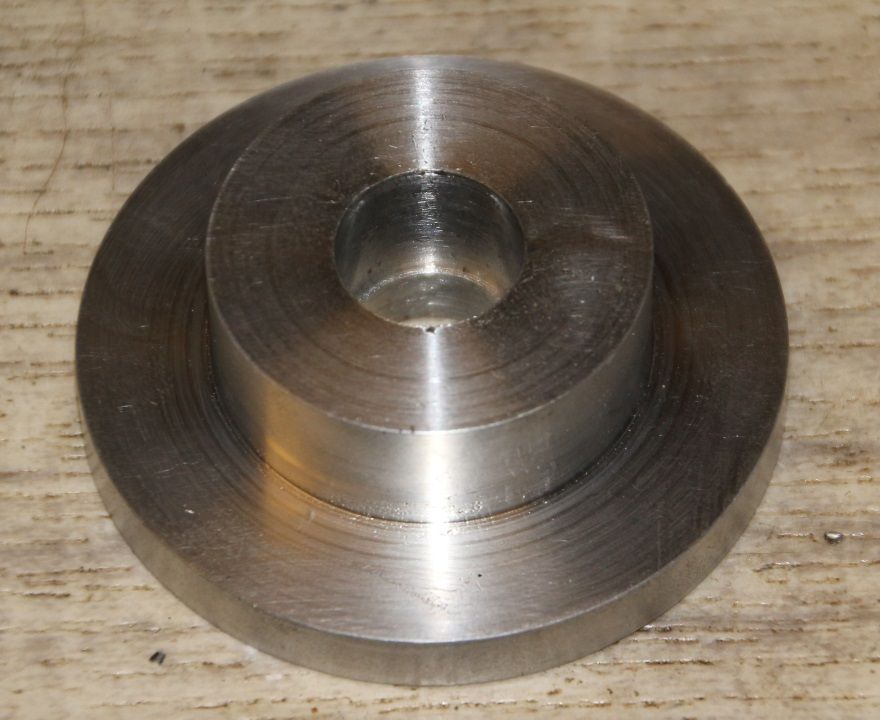

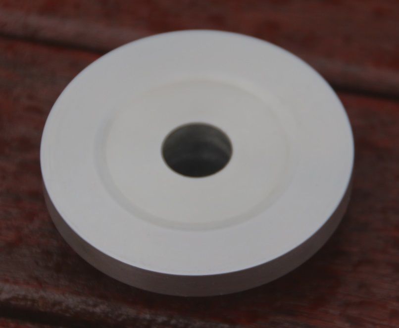

        My corrective flange now relies on diameter "1" for eliminating sideways wobble on the wheel. The flange is bored out to be an accurate fit on diameter "1" and flange edge "2" now becomes a simple stop. The shoulder which goes up against this "flange" can be seen inside the bore on one of the other pics.

            The original design of locating wheels as seen on many bench grinders, including my new 8 inch arc Euro trade Allwin is a poor design.
            Does the modified design improve things as shown by Rik in the original post I.e. side to side wobble?
            In passing how come so many grinding wheel have holes that are non standard. Does this mean that you have to buy or make a bush to suit and what sort of "fit" to wheel and shaft should we be looking for?

              Many wheels have a standard 1 1/4” or 31.75mm hole and are bushed to suit grinder shaft. The shoulder on the shaft is an inadequate location especially for the typical pressed flanges. I make a new inner flange with a 31.75mm boss for the wheel, make the hole for the shaft a push fit and it should keep the flange running true. You will probably need a new wheel as they are often made with the hole to fit the shaft. The wheels will need dressing to run true and I will do a one time dress to the sides to true them which I feel a 25mm wheel could take without causing a problem. I do not recommend this from the position of being an expert so do it at your own risk. A smooth running and true wheel is a pleasure to use.

                    That tiny lip becomes an issue with the cheap nasty monkey metal flanges that seem to get supplied with most grinders nowadays. A good close fitting washer works wonders, extending the bore of the washer is even better !
                    Better still is facing the washer square actually on the grinder shaft.

                        No mention has been made so far about the need for both flanges to be similarly recessed away from the bore so as to put even clamping forces on the wheel. There are some clear illustrations in a HSE handbook on the subject that's free to download at (http://www.hse.gov.uk/pUbns/priced/hsg17.pdf).
                        I particularly note that if you have over a 500W motor the inner driving flange should be keyed or otherwise fixed to the drive spindle.
