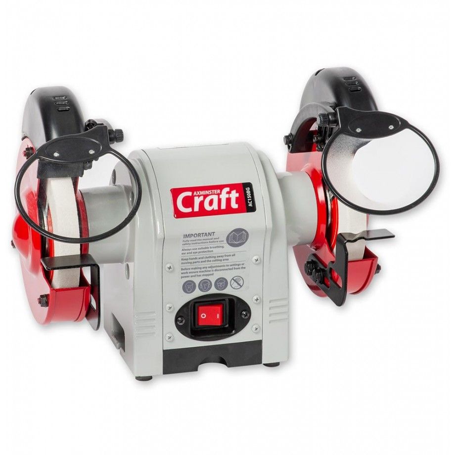

                              Thanks for the suggestions guys, having spent quite some time looking at no end of grinders I have gone with the Axminster Tools Craft one pictured below.
                              £65 including delivery which suited my pocket, 150mm, 250 watt, if the picture is anything to go by it looks well made, so hopefully it will be and give good long service.
                              Thanks again.

                                Amen to that but for many purposes you will want to replace the standard bent metal rests.

                                                      These are the same grinders that Arc sell. Be aware that the plastic light shade assemblies on top of the guards are extremely flimsy. Mine are on the list of things to re-manufacture out of aluminium after they both broke in the first week.
                                                      I got the 8" one, mostly for sharpening TIG tungstens.
