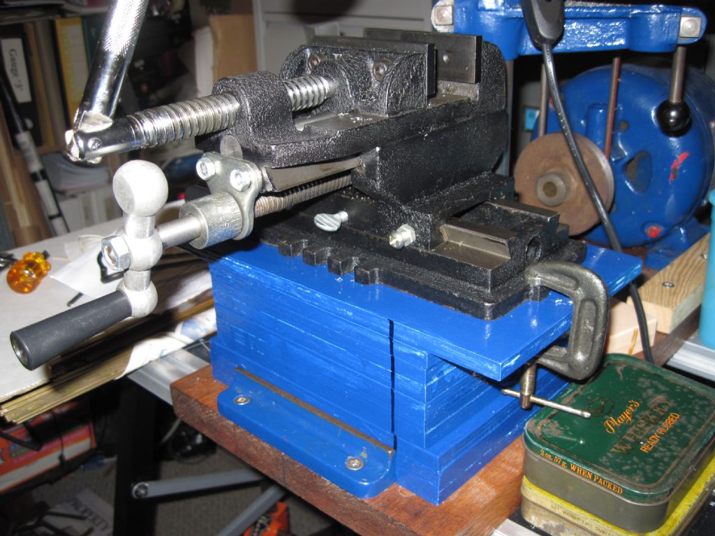

                            Well, I find my 6" cross-vice quite useful Dave. It's pretty much a fixture on the table of my Warco 2B – and it's been there a few years now. I quickly realised it wasn't a 'poor mans' XY Table – simply not accurate enough – and as others have said – you couldn't mill on it even if the drill was suitable. But it is good for 'positioning' over holes without a lot of fuss and once there it locks up Ok. It does make the table heavy but the Warco has a rack on the column, so it's not a problem for me really.
                            In fact I like it so much that, as I mentioned a few weeks back, I fitted a 3" cross-vice under my little Cowells – but had to modify the Y traverse and make some raising blocks. It simply lifts off the base if not required and I can swing the normal table back around for some things that are easier to just drill on it – but it's nice to have the choice….the packing is adjustable – very basic but it works…
                            Regards,
                            IanT
                            Cross vice for the Cowells drill 3
