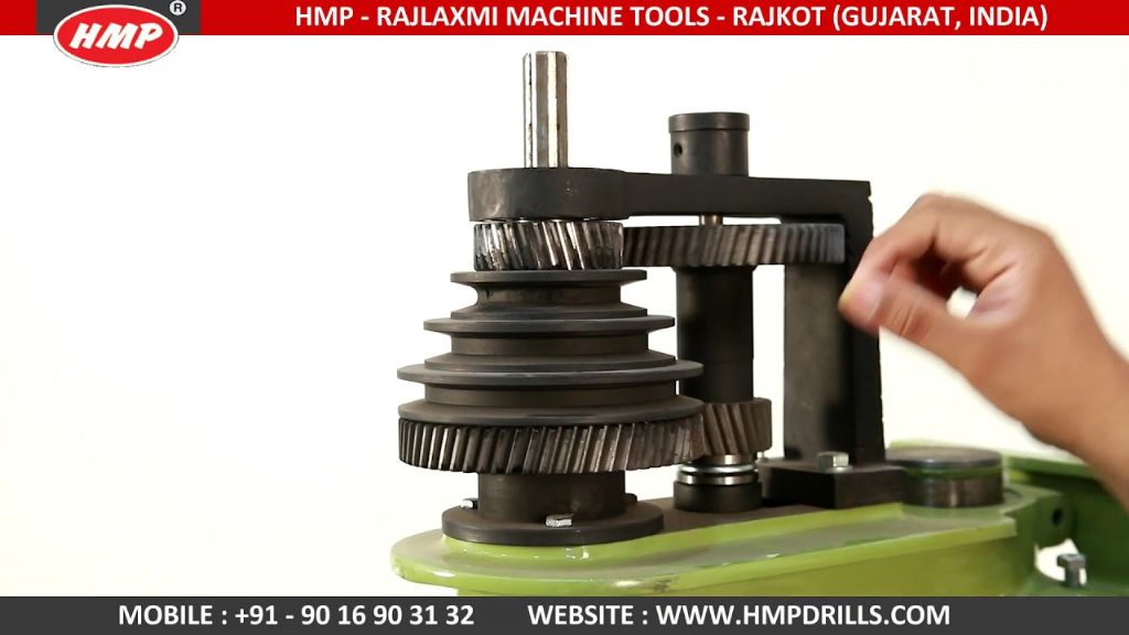

                        #524015
                        Dave Halford
                          @davehalford22513
                          To be honest you need to buy a drill with one of these in it.
                          This is just a random photo off the web and not intended to be a advert.

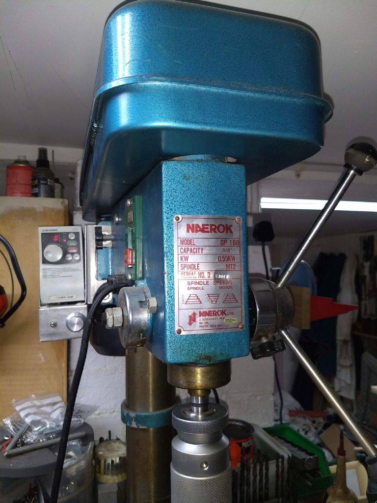

                          Gary Wooding
                            @garywooding25363
                            I replaced the 1ph motor on my Naerok drill-press with a 3ph of the same power, and added a VFD. Works a treat.
