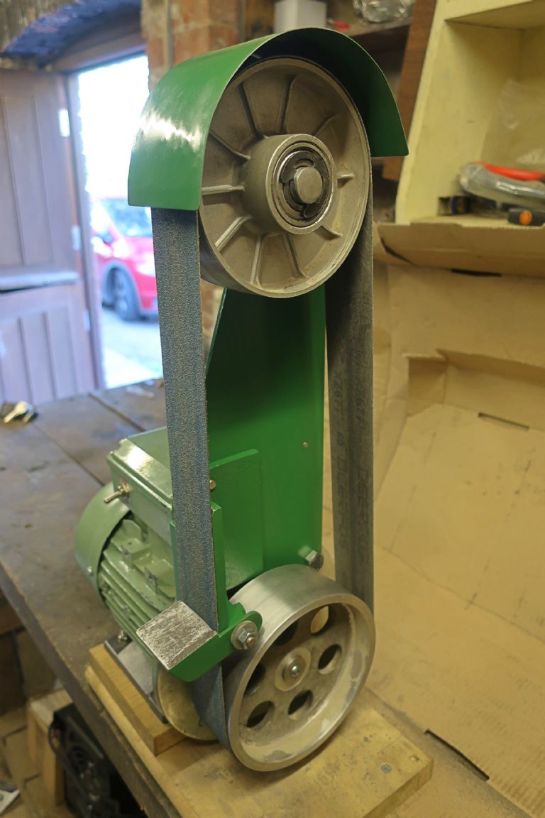

      Both my belt sanders are older and British. Both have crowned pulleys and tracking.
      Set up the tracking on a new belt and when I do some hard sanding and drag the belt to one side, release the pressure and it re-centres.
      Maybe I am not keeping abreast with modern engineering practice.

        My belt sander pulleys are crowned, its the flat plate between the pulleys that gives you a flat sanding surface.

          If you think that the pulley is flat, lay a straight edge across it !

            Well, I put a straight edge on the roller pictured above – definitely flat although it does taper by about .3mm from one end to the other. The drive roller at the other end has though got what could be described as tapered ends so not quite crowned but almost!

              As mentioned above, one can simply machine opposing shallow tapers – 2 degrees will do it – and blend using a file.
              This tracks fine with 6" pulleys at 2850rpm, and the tracking adjustment is capable of putting the edge of the belt exactly on line with the edge of the platen (and keeping it there) if needed. Both of the wheels have a shallow 2 degree crown.

                I used to think that line shaft pulleys were flat, until you stood one up on a flat surface and it leaned to one side or the other !

                  Posted by Speedy Builder5 on 02/06/2020 15:36:38:
                  Well, I gotta let you and John Baron score on that one!
                  I took a close look at my Parkside with a straightedge and there is something – though 'cos the big roller feels like it's covered in some sort of springy plastic, it'd be very hard to measure.
                  Never mind, it was cheap, it holds its line and works well – I wouldn't now want to be without it.
