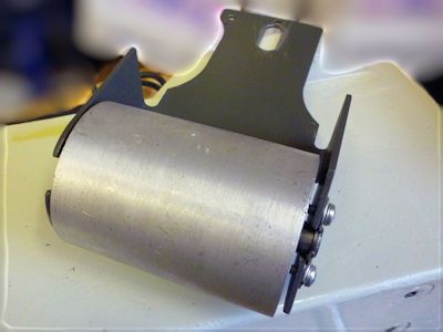

                                                Only if it is a good quality one! Mine definitely hasn't:-
                                                In fact the whole thing is a lesson in mediocre engineering (see my review BDS 460 Belt Sander).

                                                  I've not noticed a crown on my belt sanders, maybe it's due to them all having tracking adjustment.
                                                  #476919
                                                  Simon Williams 3
                                                    @simonwilliams3
                                                    If you had a crown on your belt sander pulley the belt wouldn't run flat. Hence it needs (the added complication of) a tracking adjustment.
                                                    Rgds Simon

                                                      I think so too. I've got a Parkside cheapie belt sander from Lidl that clamps to a workbench and I use it for wood and ally flats and chamfering the edges. It hasn't got any crown I can see, the track adjustment works fine, and it's becoming one of my standard go-to tools.
                                                      It's a superb example of mediocre engineering at its very finest.
