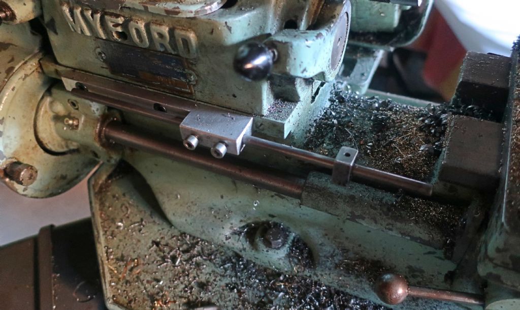

                                  Here's mine. Simple and effective.
                                  I use it in combination with my indexable lathe stop, usually with longer jobs and the indexing rods can't reach the normal fixed stop.

                                      Not official or a bed clamp but this simple device has served me well for years:
                                      The Super 7 gearbox prevents the even simpler solution shown in an earlier post. For the same reason, it is necessary to have a selection of stop rods of graduated lengths.

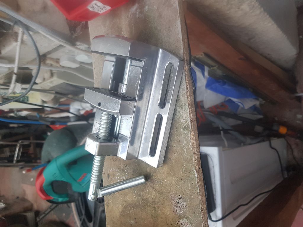

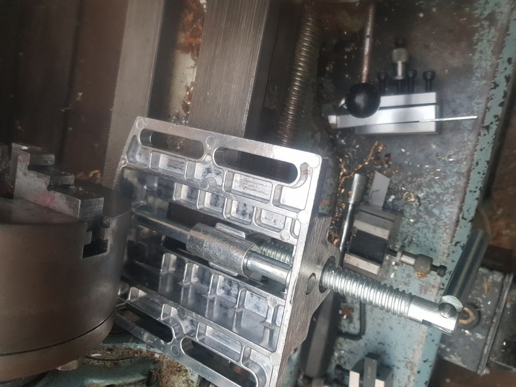

                                        I think we should ignore those who belong to the flat earth society and dont like their cages rattled.
                                        I posted the question re the ML7 as I thought I had missed something and a suitable simple attachment might in fact exist.
                                        When you have to do repetitive work, a bed stop is important and one that doesnt slip like using those plastic quiick clamps do – waste of space.
                                        I wasnt looking for a universal gadget and those with a dovetail bed are better served with a DTI clamp
                                        Some other robust clamps need serious milling which auntie Doreen is not up to the mark just now. Nice work on show btw.
                                        So at the risk of a firestorm of ******* from a dizzy height here is my cunning plan
                                        I bought one of these mini vice off ykw £9 and was prepared for disappointment as usual with PRC stuff, so to my surprise when it arrived I was surprised at the quality and precision of this die cast product – so much better than the ************** CI job crude and sloppy. It complements my little xy table also v impressive
                                        then looking at it hot
                                        It could make a bed stop clamp
                                        Now eagled eyed guano carriers will notice from the photo that screw stick out. In fact I removed these and what I thought were soft jaws, so it was just ally surfaces. It clamped to the bed quickly and firmly, no risk of damage
                                        ******* carriers moaned that you will have a large over hang and cant get close to the chuck
                                        I have shown that you can clamp close to the gap bed and by removing the topslide clamp nut (leaving the other nut to do the clamping – this works) you can get fully close to the chuck and all that without having to cut off the vice flange, so it can still function as a table vice – double result
                                        Hope this helps – living with Mrs Myford you constantly have to be inventive

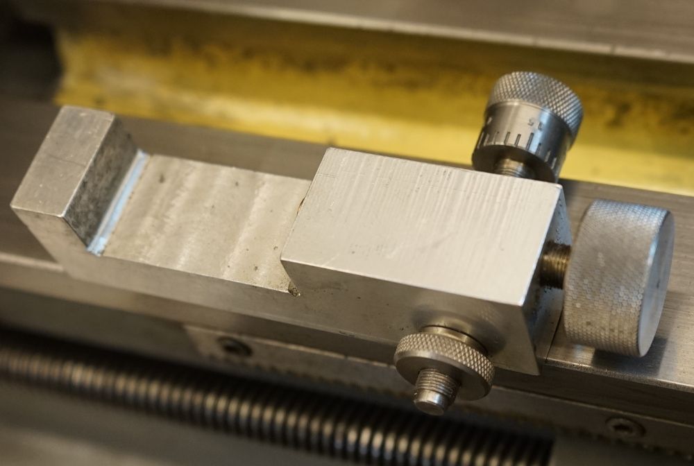

                                          It looks as though I may be a little late to the party, but here goes anyway.
                                          For a very simple saddle stop I sometimes use a toolmakers clamp.
                                          This has the advantage that I have one or two, and that they can clamp close to the end of the bed, as shown below.
                                          a simple solution.

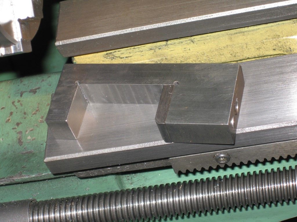

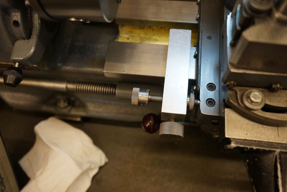

                                          I later made something a bit more refined which would clamp to the bed of the ML7.

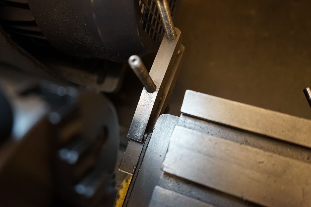

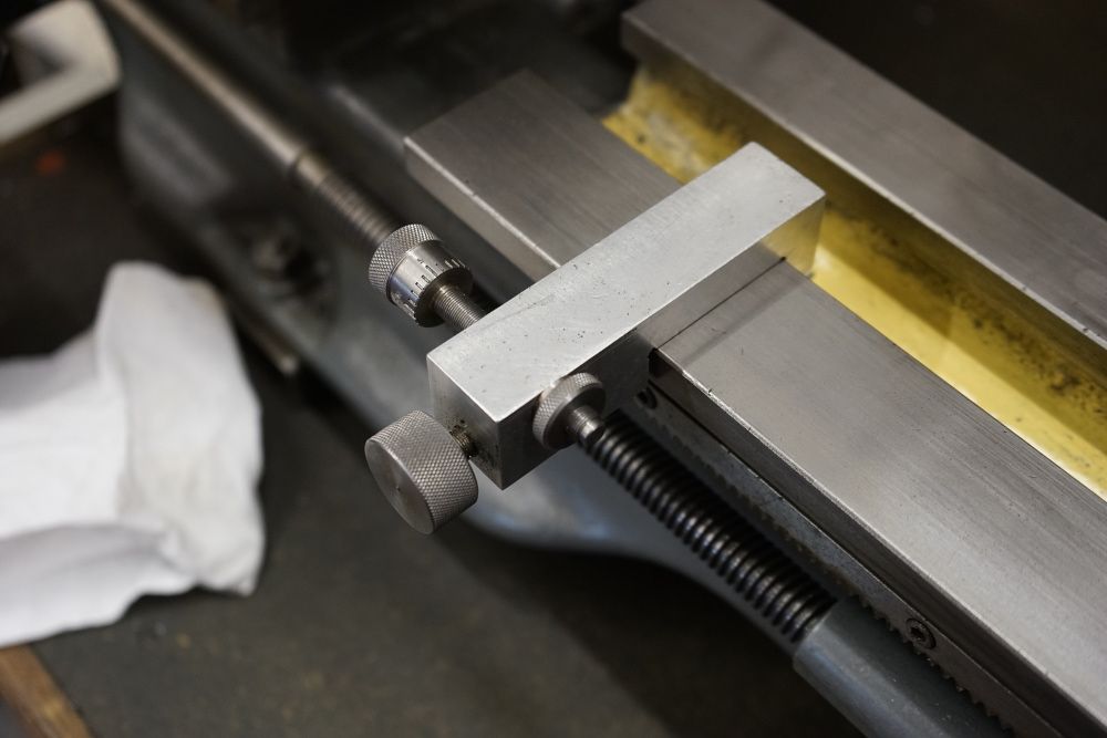

                                          The body of the saddle stop is made from aluminium. All the milling was done on the ML7 itself, using a vertical slide.
                                          The threads of the clamp screw and the stop rod are both 40 TPI. This give a fine adjustment to the stop position, and in the case of the clamp screw gives a tight grip for very modest torque on the thumb wheel.
                                          Underneath, the bit hat clamps to the bed looks like this:
                                          A brass plug on the end of the clamp screw prevents the screw from graunching the side of the bed way.
                                          Nice and simple, works for me.
                                          JimB

                                              Nice piece of work JB Im glad you put that brass plug in there, had me worried for a moment but you need a miller for that solution and auntie doreen is hors de combat till I complete a dozen other unfinished works
                                              it must be remembered that both the outer and apron side sheer faces are used to guide the saddle, great care needed
