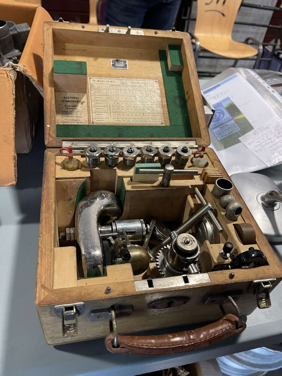

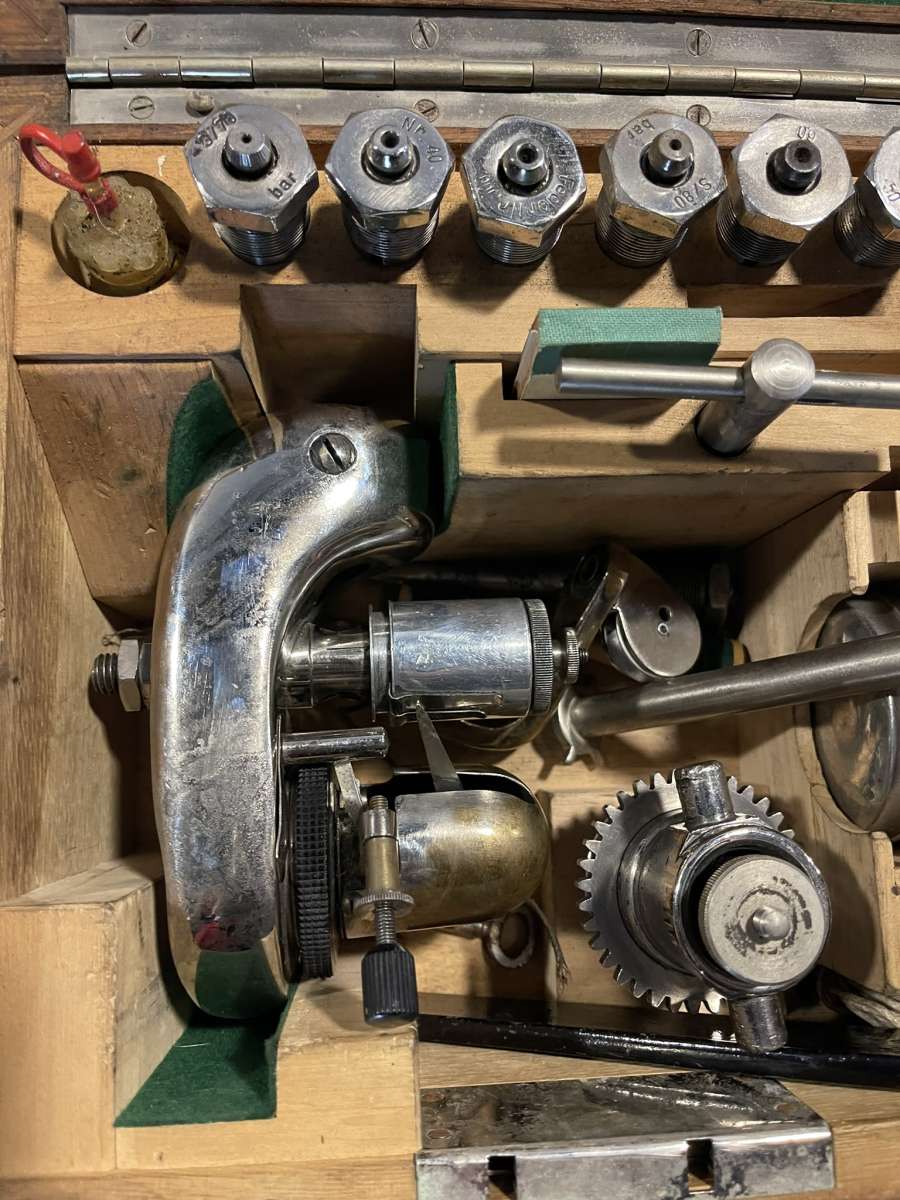

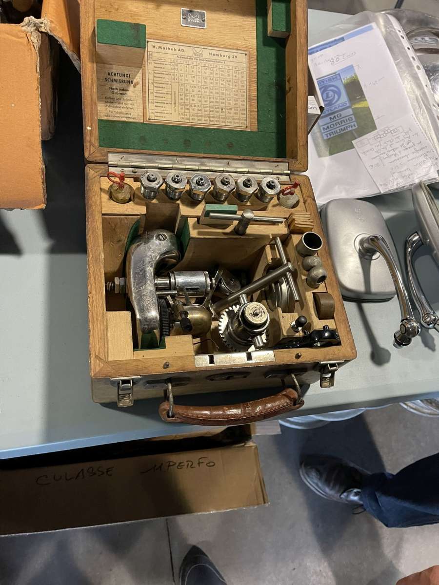

      I was at an autojumble last Saturday and this was on one of the stalls – already sold, but nobody had a clue what it might be….
      Any thoughts since it piqued my curiosity?

        Hi Simon,
        it is a so called Maihak Indicator. You can with this device, at a full size steam engine, record so called indicator diagrams. This is for the optimisation of the valve setting of a steam engine.
        Werner

          Also made by Dobbie McInnes, and can be used on slow-speed diesels as well.  The area under the graph is the power developed per stroke.

                How slow, slow-speed? Large marine engines?

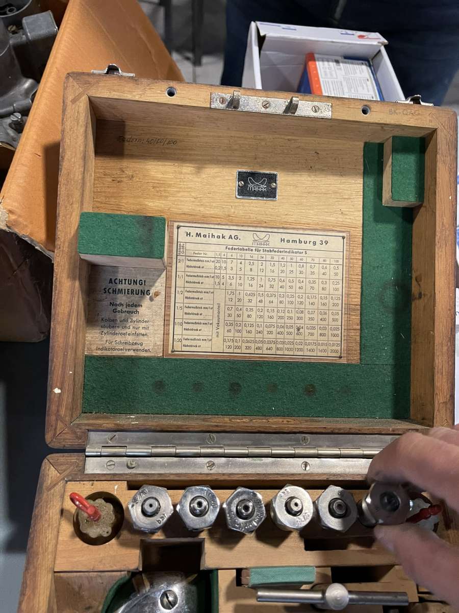

                The trademark in the lid gives a clue to what this instrument is!

                    I tried as little research on the company itself but unearthed only several German and American, museum and library references.
                    Summarising from the catalogues of Trade Literature at the American History Museum Library, and Smithsonian Libraries:
                    Company Name: H. Maihak A.G., founded in Hamburg in 1885. Later (still?) owned by Westinghouse Electric Corp. of Pittsburgh. I was unable to find if it still exists.
                    The Smithsonian’s collection is of trade literature, and its partial translation shows the products as:
                    Instruments ; gas analysis instruments ; electrical instruments ; instruments for locomotives ; thermometers ; power measuring instruments ; other instruments .
                    (Record Id: SILNMAHTL_29282)
                    The trade-mark is a stylised indicator-diagram for a double-acting cylinder,  but of what sort is another matter even allowing for artistic licence: a compressor?
                    I think the motif represents the diagram for a double-acting, two-stroke Diesel engine as were (still are?) built for ships. The loop is of full-stroke compression, short full-pressure phase, long expansion.
                    Leading builders of marine Diesels included M.A.N. and Sulzer, both German.  (Sulzer introduced a two-stroke Diesel engine that could be reversed within itself, rather than relying on an external gearbox, by valve-gear.)
                    [Source: R.H. Grundy, The Theory & Practice of Heat Engines, pub. Longmans, Green & Co., 1942 and 1943.)
