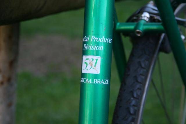

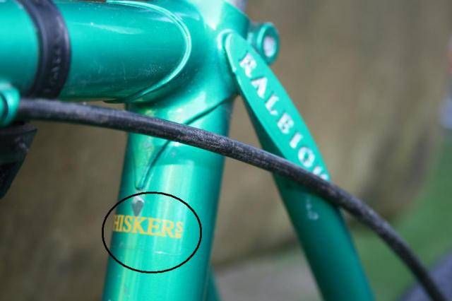

                        Hacksaw
                          @hacksaw
                          Bit off topic hijack …Nigel , tell me more about this Whiskers catalogue..! I thought it was just a bike shop in North London ?
                          I bought this bike down our local tip for 15 quid, and thought it looked a bit up more market than a Halfords offering.. A decal on the seat tube says Whiskers , other decals say Raleigh Special Products . whiskers.jpg
                          #370734
                          BOB BLACKSHAW 1
                            @bobblackshaw1
                            What I can remember from the early 1970s Whiskers catalogue was sheets of A4 with parts and offers.
                            I use to cycle there from Luton with mates from the cycling club to see what was on offer, I think that they specialized in Campagnolo, very expensive at the time but the best.
                            Good price for that bike Hacksaw, looks early 90s.
