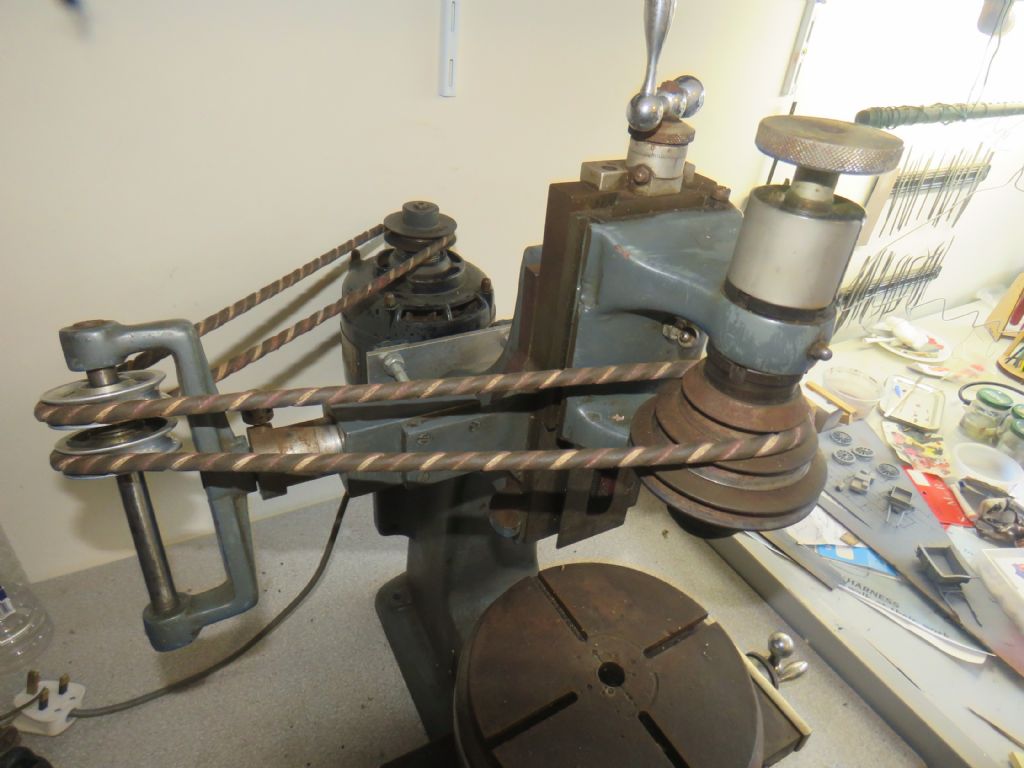

      Hi everyone, I have been given a BCA miller which has round headed grease nipples about 5.8mm across.
      Will something like the Hilka grease gun fit these nipples, or what do I need?
      https://hilka.co.uk/manual-grease-gun-set-84800120.html
      I do not want grease to leak all over the machine when I try to use the gun on a nipple for the first time.
      Thanks for your help, Arthur

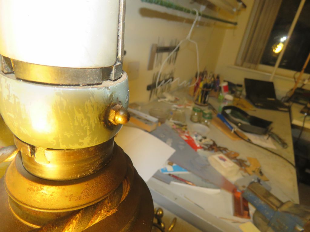

                The thing that has to be right is the main spindle with a grease nipple half way up the column and a horizontal feed from the nipple to the spindle. As I use small diameter mills, Tony at LathesCo said I should consider increasing the diameter of the pulley on the motor to increase the rotational speed, but I would not like to do that without ensuring the spindle was properly lubricated.

                  I thought some photos would help:
                  The BCA Miller
                  Grease nipple on front of main spindle
                  Grease nipple on front of spindle

                    Welcome, Arthur
                    Nice to see the original cotton belt there !
                    The recommended lubrication was:
                    Main Spindle : 2 Nipples : Oil : Shell Vitrea 37
                    Slides and Rotary Table : Nipples : Grease : Shell Alvania 2
                    Rotary Table Worm : Oil : Shell Vitrea 37

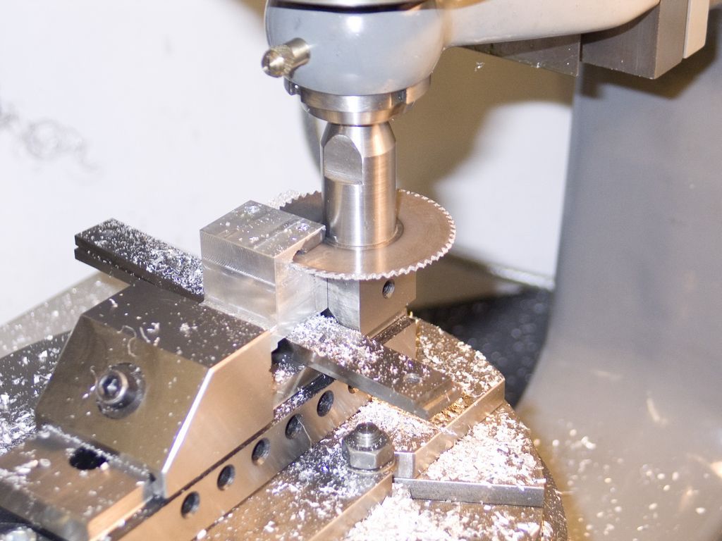

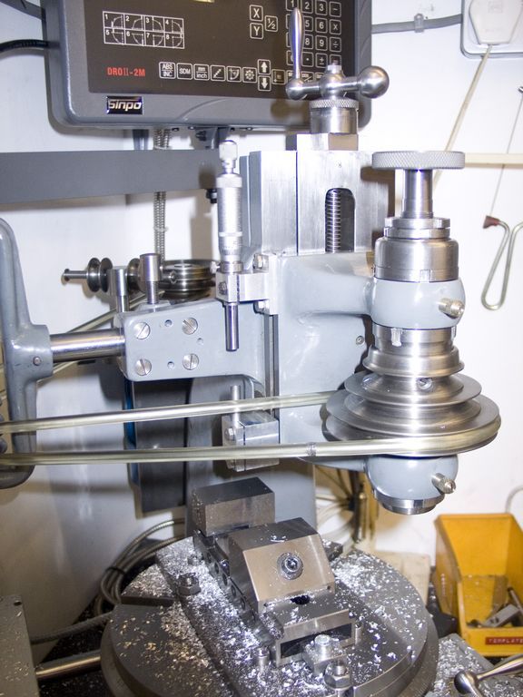

                          Here is a shot of mine, it has oiler cups where the outer sleeve has a knurled ring that you rotate half a turn to reveal the hole in the top.
                          Phil

                              Phil – your machine is in lovely condition. Did you fully refurbish it and did you use Tony's book and was it useful?
