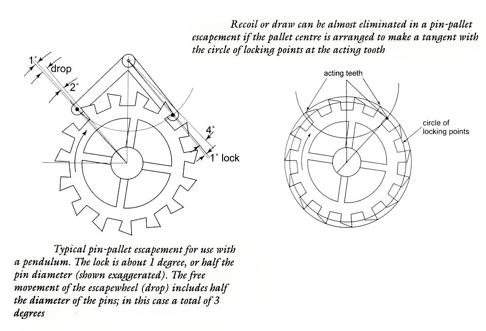

              The Brocot
              It clearly shows the impulse as the pin slides over the tooth. Niel's isn't so clear on the dead beat. Normally a slitted "carrier" like this would normally have push pull screws on both types.
              Watching that gif I am wondering if Abbeyclocks comment about efficiency is a load of bull.

                  The Brocots:
                  Slides 26 and 47 of this presentation are interesting !!

                          More or less yes Michael. There is rather a lot on escapement efficiency on Abbyclocks including the dead beat. I am thinking it's a red herring. I'll have a look at the presentation later.
                          I don't see why a Brocot shouldn't be used on a 1m pendulum however tiny jewelled pallets might not be appropriate. I'll see if I can dig out some details on the pin size of one that uses something similar.
                          Julian seems to be unable to accept that some might want to make a rather accurate clock or that in real terms most additions are no harder to make than those in a simpler clock however he has a point on recoil but perhaps he could explain why there will be some.
                          Anyway as it was mentioned – by me sadly, Julian may not like that, this is the pin pallet.
                          Note again slight recoil comment but this is still a recognised dead beat. The reason I took some notice of it was the number of clocks I have had where those super fine escapement wheel tips have bent. Pretty easy to straighten again but it shouldn't happen. This one uses the wheel tooth top slope for the impulses. I get the impression that many clock makers don't like it – cheap watch technology. The Brocot is easy to manufacture too.

                                    Posted by Ajohnw on 30/04/2016 23:57:26:
                                    As I pointed out in an earlier post, the diameter of the Brocot pallet is made equal to the tooth pitch of the escape wheel less the drop. So there is no problem with tiny jewelled pallets, just make the whole thing bigger to suit. Fully hard silver steel on brass has about the same coef. of friction as ruby on brass, perhaps just a little less hard wearing but it should last 100 years or more! My sister has a long case clock made by our great great grandfather about 175 years ago and it is still going strong with no jewels.
                                    Russell.

                                          The pins on a 2 sec period pendulum design I have are 0.095" dia and some one ran the clock with a 20lb bob on the pendulum.
                                          Michael's presentation link is interesting – nearly dead beat, well they all are but big swings is worrying. That suggests a big impulse angle but the escapements he made were generally tiny. Escape wheel size and the centre distance between the escapement and wheel has an effect on this. If the pins stays the same size the impulse angle reduces as the wheel and spacing gets larger. This also has an effect on the angular effect clearances have, None of them can be made perfectly.
                                          This is probably going to be tough going as it concentrates on the Graham but explains all sorts of things and how all dead beats relate so the Brocot design is all over the place.
                                          **LINK**
                                          I have my doubts about the efficiency arguments who ever wrote it but that's me. Theory is fine but often practice is different and theory turns into scotch mist.

                                            Posted by Russell Eberhardt on 01/05/2016 09:58:24:
                                            Russell.
                                            The reason for jewels Russell is the wish for no oil at all anywhere. But I would want to make sure it works first. They aren't cheap. This might start a debate on oiling jewels but I'll try the one that goes don't.
                                            Whoops – I meant to add thanks Russell. That gives me a nice easy way of viewing the impulse angle. sad Calculating what it is precisely may be a bit tough.
