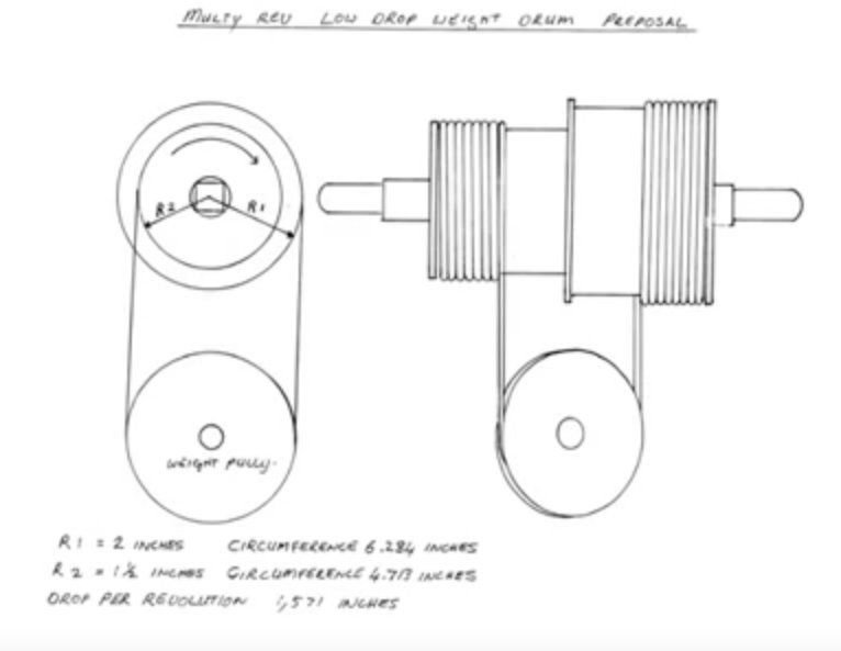

                  I think that is the only one Jack and too much chuntering and not enough of the clock really.
                  surprise The winding drum can turn an 11ft drop into a 17" one. Lots of loss of torque though.
                  blushMy maths are probably screwball there but it will do for now, For 132" coming off one 115 goes on the other,

                      The weights do look a bit big John. It's shown here and on youtube
                      **LINK**
                      With the sizes he gives it should give the same performance as a weight of 1/8 the size less any losses.

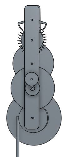

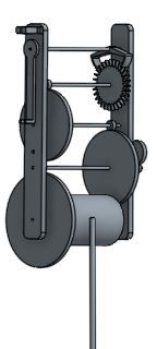

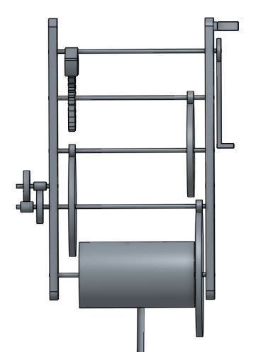

                        Slowly progressing with my drawings. At the same time as designing the clock, I am learning CAD for the first time. I am using Onshape which seems generally to be all right, but seems to do odd things at times, for no apparent reason. I had to draw the pendulum suspension block several times as part way through adding other parts to the assembly, the block split into its components parts and appeared to fall apart.
                        The width between the frames is currently arbitary and will be set later once I have worked out hw large the winding barrel needs to be. Using the idea of a looped rope with pulleys, I should be able to get seven of eight days running time from a four foot drop.
                        I have settled on the following gearing. It may not be ideal, but it all seems to fit and look generally fine. I know that it still uses ten leave pinion in the train, but I am struggling to devise a better ratio that fits together.
                        30 tooth escape wheel followed by:
                        12:90
                        12:96
                        12:120 for the barrel wheel
                        I have 10:30 and
                        8:32 for the hour and minute hands.
                        As mentioned before, the frames are merely shown to hold the wheels and aroburs in place and are not the final design or size.

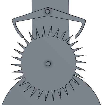

                          I don't know how many teeth you have on the escapement wheel but I was reading that the pallets usually span 90 degrees so 7 1/2 teeth on a 30T wheel and 15 on say a 60 etc. 7 1/2 becomes 7 in that spread sheet I posted.
                          Just a comment in a book. Like most things in this area not much info about.

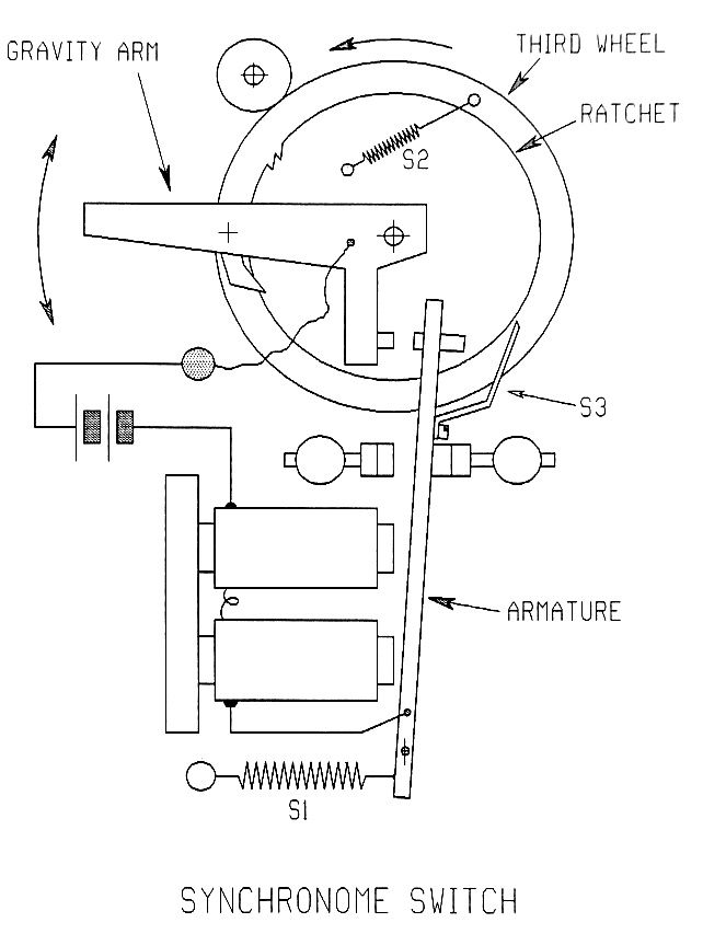

                                This is a rough layout of an "electric remontoire".
                                S3 locks the remontoire wheel when the solenoids operates. It's driving the escape wheel pinion and the hour and min wheels before it so is intended to be the only source of power.
                                Harrison used the same style of maintaining spring (S2) on his escape wheel remontoire but used 2 springs rather than one.
                                Sometime when done mechanically this sort of arrangement is used to cause one of the hands to jump at the correct interval rather than move slowly in the usual way.
                                Suitable sources of coils and contacts might be relays. The type with clear plastic covers that can be pulled off.

                                  My escape wheel has 30 teeth and the arms of the pallets are at 90 degrees. They span 7 1/2 teeth and have an angle of either 1 or 2 degrees (drop?): I cannot recall which I drew. I know that in the drawing below, one pallet hits the teeth of the wheel. This is because I cannot work out how to rotate the wheel in the CAD drawing.

                                            I found the blog interesting too Michael. One thing I noticed was probably a need to take some care when taking a wheel blank from one machine to another but that may just be an impression from shots of making the pinions – sticking a mandrel in a 3 jaw chuck doesn't seem to be very sensible to me. That lead me to understand why some cut the teeth on the lathe.
                                            Reading a bit more on the dead beat angle in 2 books 90 degrees is ideal. One reckons that major departures makes things more critical so manufacturers generally use it. The other reckons it minimises friction but on large wheels using it will add more inertia and hence increase friction that way so on large wheels it's better to increase it. The book I mention states that this area is the most important one in the clock. Another points out that they can be made in two parts and turned to get precise rads – slot to hold each half in a piece of bar. Which ever I would use the spreadsheet for the design as it shows a good way of getting the impulse faces correct.
                                            For a clock I'm going to call John's Folly. Nice double meaning. I'm inclined to use Brocot but am not sure that I have design information where the wheel finishes up looking much like a dead beat one. A Riefler is vaguely similar but I wouldn't be keen on applying the impulses to the suspension as I doubt if I could sort that out. On the other hand I can't see why this couldn't be used in a conventional fashion. This one appears to use a slope to provide the impulse where as the Brocot uses the rad on the pin. The pin pallet also uses a slope and it seems can be rather good if made correctly.
                                            Not too clear on slope – the slope is on the wheel rather than part of the pallet.
                                            Any views?

                                              John, the Brocot escapement is a dead beat escapement. The important design point is that the front face of the escape wheel tooth is radial so that it is tangential to the pallet and thus avoids recoil. It is easy to make and set up hence its use in better quality mass produced mantel clocks, often with a visible escapement and jeweled pallets.
