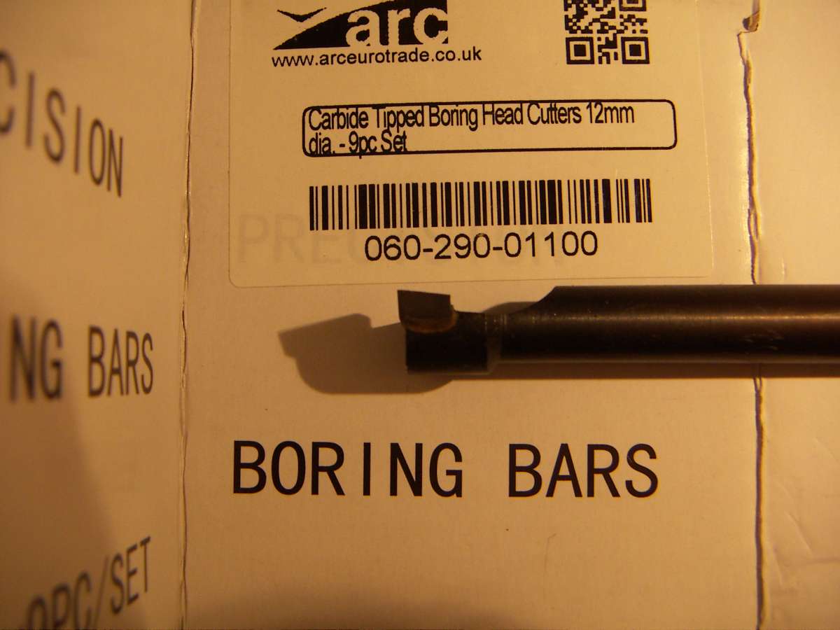

      Do any round shanked boring bars actually have their cutting edge on centre?
      I’ve searched but not found a conclusive answer. My cheapo 50mm boring head came with a selection of 12mm brazed carbide bars but all have the cutting edge way too high.
      I know there isn’t technically a centre height for a boring head, so for clarity I mean a diameter, parallel to the ways of the head, passing through the centre on the tool mounting holes. Having the cutting edge in this line is the only way for diameter adjustment to be sensible.
      I know I could rotate the tool in its hole, to get the tip on centre but this would give VERY negative rake.
      The indexable bars I have for the lathe are also above centre, though less so.
      All I can think of is using a smaller diameter boring bar in an eccentric sleeve to bring it down to centre.
      I know this is far from a new problem so someone must know the answer.

              My understanding is you set the tip on the “diameter” so the scale on the head reads correctly. The cutting is done on the end of the bar not the side. Thus the top rake is provided by the slope axially rather than radially, as per image. arcbbar

                I see what you mean but the tool should behave exactly as it would in a lathe, with the same tip geometry, including relative to the point of contact with the work.
                When you mount a boring bar on the lathe tool post, you don’t rotate the tool along it’s axis, to get the tip on centre. You shim or adjust it vertically. The tool geometry stays the same either way but the actual cutting angle is very different.
                Again, I’m sure I’m overthinking this. Once my cheapo CCMT bars arrive, I’ll have a play and all will be well.

                  Phil’s post above reminds us to think more carefully about the actual geometry of the cut. Get a similar confusion with flycutter tools effectively the opposite of this as they cut sideways not down.
                  You also need to think of the direction the cutting forces will bend the tool.
