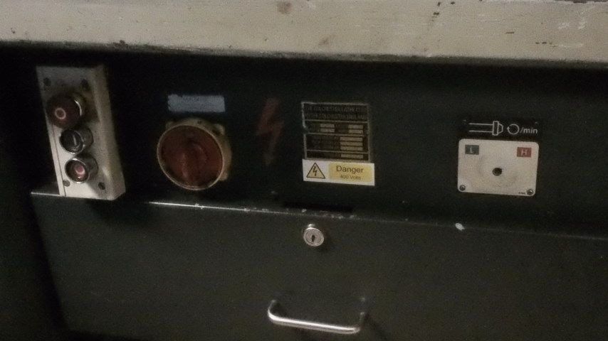

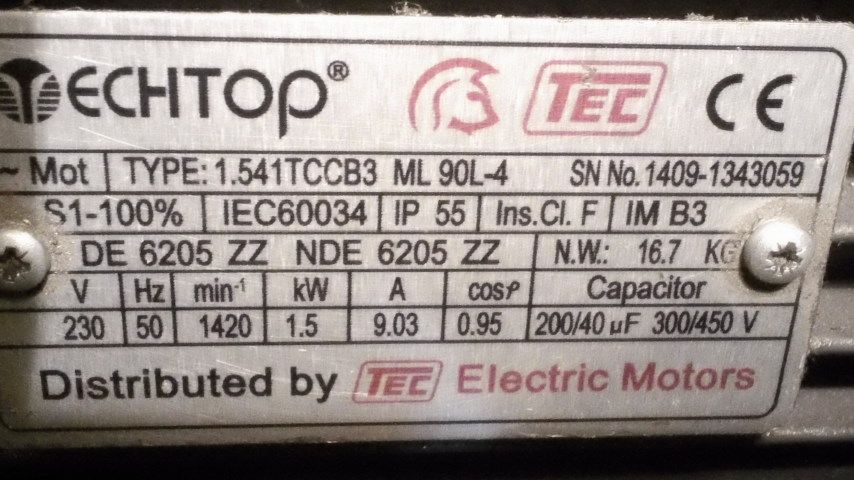

      dsc00724.jpgdsc00722.jpgHi i have just purchased a used colchester bantam that has been converted to single phase.From what i gather the leaver on the apron should introduce power for forward and reverse but my lathe i am having to use the power buttons for what the manual says should be used for the pump.The other problem is i dont have a high or low switch so must of been missing when i purchased it.

        Clive Foster
          @clivefoster55965
          Andrew
          Sounds like a quick and dirty conversion from three phase to single phase by-passing all the internal factory control gear.
          The pump control buttons are independent of the rest of the electrics so wiring direct to the motor power contactor gets it up'n running fast.
          As I recall it the apron lever simply operates a motor forward / reverse switch inside the headstock. I have a feeling the 1600 was built with atwo speed motor so lots of wiring on the control side.
          Hafta get hold of the manual and start tracing wires to see what you have left. Sounds like that some or all of the complicated gubbins may have been removed. If so probably best to track down the Colchester group on groups.io to find out how other folk have dealt with such defenestration.
          I'd swop the single phase motor for a 6 pole 3 three phase driven by a decent VFD and devise a suitable control wiring set to duplicate the factory set up. Which I understand is decent to operate. But I'm confident with such electrics. Selling the 1.5 kW single phase motor should cover a replacement 6 pole three phase as decently husky single phase motors seem to be sought after.
          Why 6 pole motor? Lower base speed means more torque in the low speed range as compared to slowing down a conventional 4 pole 1440 rpm motor. Don't need high torque at high speeds so losses when running fast don't matter so much. 8 pole is theoretically even better but spendy. Or you could adjust pulley sizes on the motor to pull the drive input speed down but then the motor pulley will be rather small.
          Best to take the trouble to sort it before putting into service or you will make do and curse for fart too long before accepting the inevitable.

          Emgee
            @emgee
            Hi Andrew
            Seems your lathe needs the apron lever switch re-connecting to provide control of the spindle, even if you only get fwd control will be a benefit.
            You will most likely have to change the contactor coil from 380 to 230v, if it's the OEM Crabtree B15 starter you may have difficulty in obtaining spare parts.
            The high/low speed switch was used with the dual speed motor to change pole configuration of the motor for the 2 speeds.
            Your single phase motor is only 1 fixed speed, spindle speed range will be as the headstock control levers.

                                      Emgee
                                        @emgee
                                        Andrew
                                        The 1.5kW motor fitted on your lathe is more powerful than than the original 2 speed motor when that was used at low speed, you should be able to remove metal at the rate suggested in the lathe manual without problems.
                                        The lathe in the video is running with a single phase 1425rpm motor fitted.
                                        In time no doubt your circumstances will change and you may then decide to go for a 3 phase 230v motor and run from an inverter, you won't need to worry about getting a multi pole low speed motor as the low speed range of the gearbox is more than adequate to keep motor speed high but low spindle rpm.

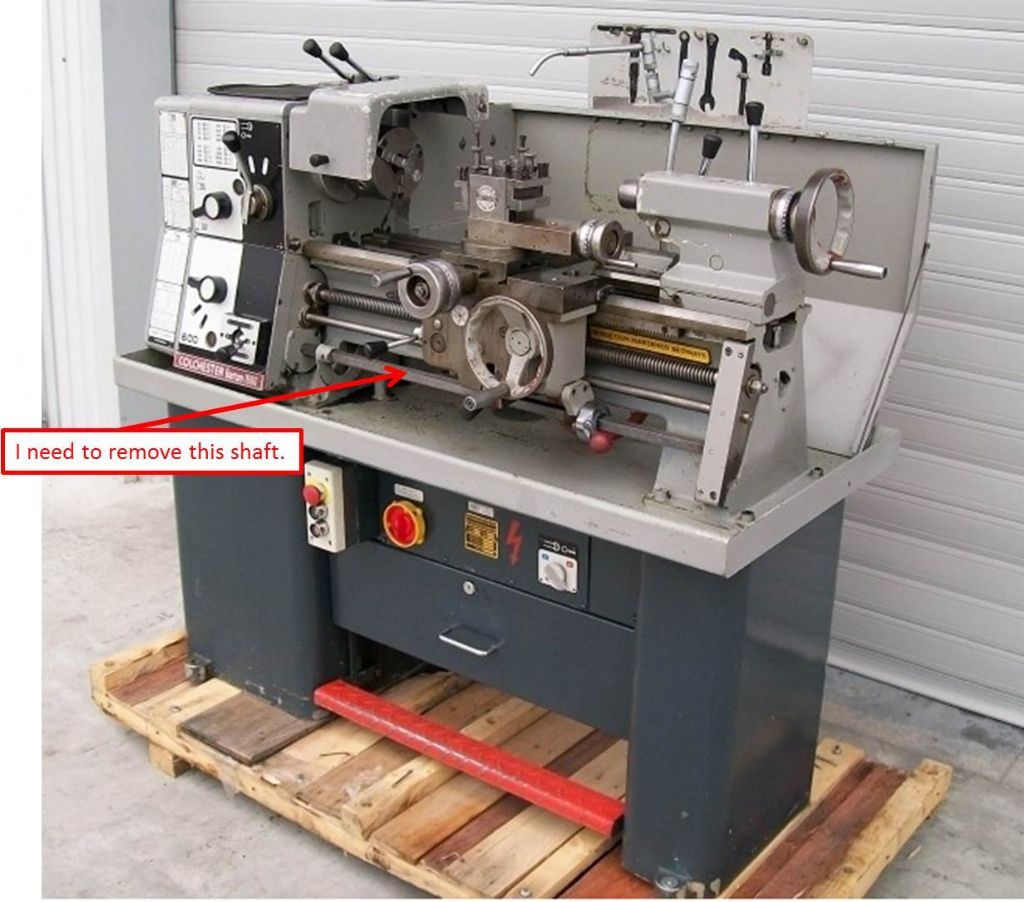

                                              Thank you all for your advice.I believe my lathe is a mk2 i have attached a photo from another thread not my post hope he doesn't mind me using it.624207.jpg
                                              #576026
                                              Andrew Cressey
                                                @andrewcressey80402
                                                This is the same as mine
                                                #576029
                                                  That is a two speed motor one so back to square 1
                                                  #576035
                                                  Simon Williams 3
                                                    @simonwilliams3
                                                    Jason has it – that initial picture of Andrew's has the position for the "L – H " switch for the two speed motor, but somebody has removed the switch. So no two speed pulley drive as per the pictures of the Colt from Lathes.co.uk.
                                                    I converted mine to single phase, hated it, converted it back to three phase but with a VSD, making the best of both worlds. I've got mine configured so the original L – H switch is now a digital input to the VSD to tell it to run at 100 Hz to get the higher set of speeds, though I hardly ever use them. The other trick I've found is to set the VSD to run (low speed) at 60 Hz, then the lower speeds through the gearbox are all set up by 20%. I use mostly carbide tooling – the faster speeds are a bonus.
                                                    The original L – H switch is a 6 pole 4 position rotary switch, probably still available out of the Kraus and Naimer catalogue. It switched the motor windings to change speed electrically. With a VSD all you need is a simple single pole changeover switch.
                                                    There is some stuff about converting a Student HERE and some more HERE and HERE
                                                    HTH Simon
