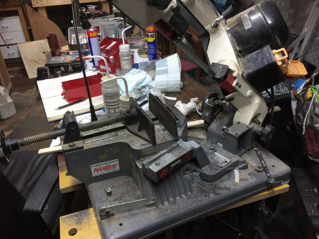

      I may have posted about this before in a 'which bandsaw should I buy' context. A Femi would be nice, but it's not going to happen for a while. So I have to live with what I've got.

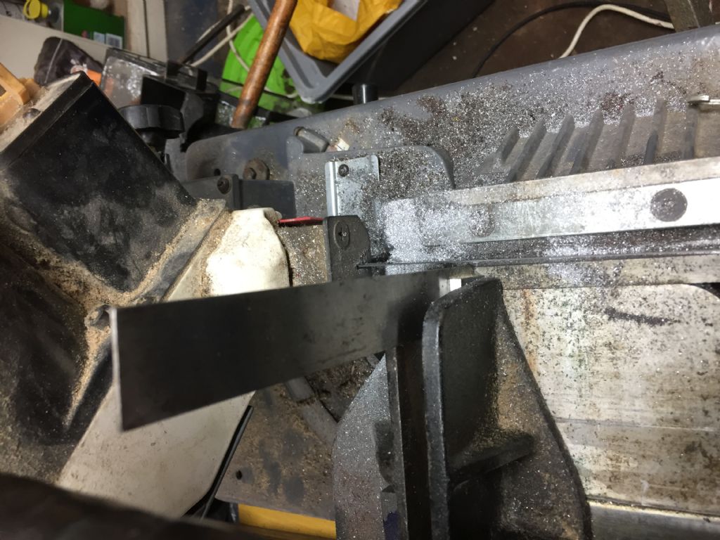

      Here is a cut in 1.5" aluminium square:
      At this point the blade jumped off the wheels (I was hoping to get all the way though, hence the redundant 'top' reminder). So two problems, which I think are linked: (a) the cut is way out of square and (b) the blade jumps from the wheels. Probably relevant is that the cut starts smoothly, but the machine makes a clunking noise and the arm 'hops' a little in time with the clunk before the blade jumps the wheels. I've watched the weld and it isn't catching in the workpiece, it happens when the weld is somewhere inside the machine.

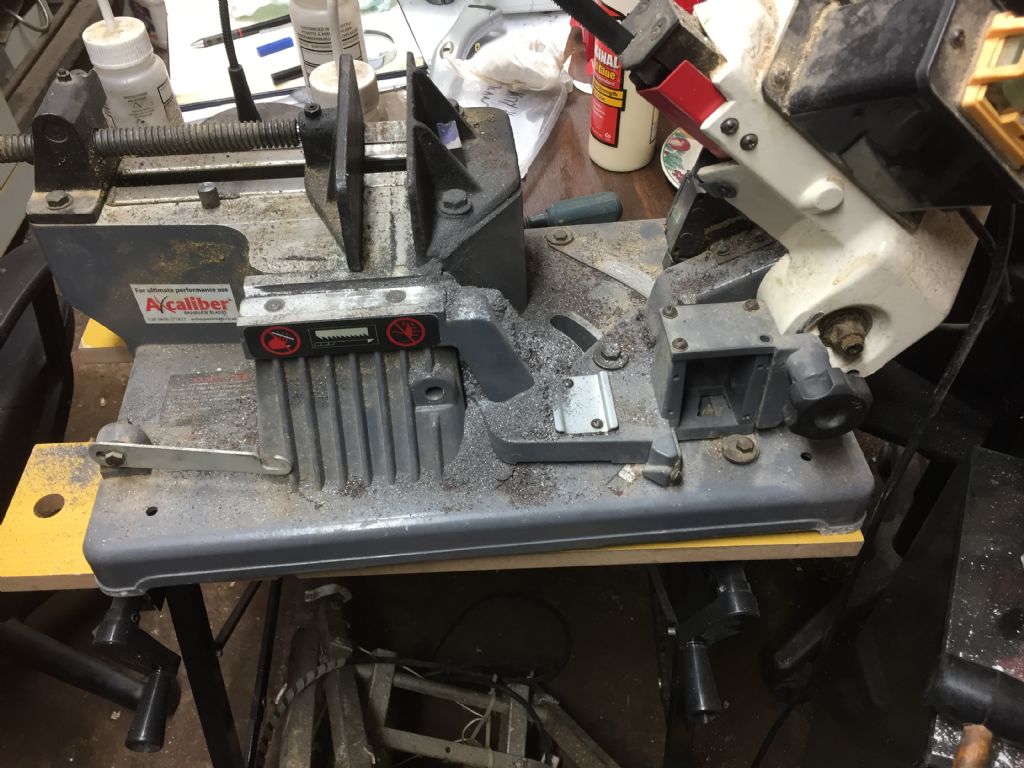

      Here's a pic of the machine:
      and another with the arm set at an angle to make it clearer how the castings fit together:
      Obviously there are many variables here. What I'm after is advice on systematic diagnosis of the problem(s). Everything is fixable with a lathe and a mill!

                              I suspect the alignment of the blades guides. the brutal twist back onto the powered wheel is very demanding.
                              I had similar trouble with my saw and it was compounded with blade breakage. I put it right in the following way
                              Take the blade right out and dismantle the guide wheel heads. Mine were badly made with cast surfaces that fitted where they touched, re-machine all those so that they can be relied upon to guide the blade correctly. Now stretch a wire or fishing line round the blade wheels with it snugly into the rim groove and rebuild the blade guides.
                              The aim is to only just support the back of the blade, the wire should therefore just graze those wheels. Take the wire out and refit the blade. Grip it at the low end with a tool makers clamp where it runs out of the guide to twist the blade and set it upright with respect to the vice and held like that refit the side wheels to support it. Next set the guide blocks is to hold the twist before screwing it down to the support beams. Be sure the side wheels allow the blade to run through without gripping it tightly.
                              Tension the blade to a mid musical tone by plucking the free section at the back of the bow, a dull thud is far too slack it does need to ping.

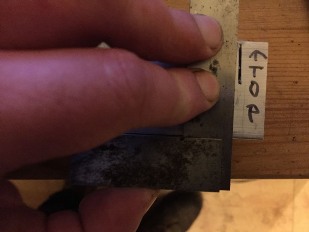

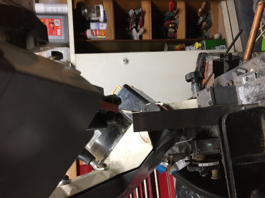

                                Thanks for replies.
                                Bill – (Cornish Jack) maybe you got the first one I bought from them and sent back! It was even worse on vertical alignment than the replacement, and as you know there is no provision for adjustment.
                                I'll fit a new blade and see if that helps. When I bought the machine I also ordered a small stock of replacement blades from Axminster. They are 1470mm x 1/2" 14tpi carbon steel – I think I might still have one left, However it may be better to fit a third party blade. My Record woodworking BS certainly works better with Tuffsaw blades than the Record offerings.
                                I'll go for bimetal with M42 teeth. Ian at Tuffsaws stocks these with various pitches – from what's been said here it seems 8/12 or 10/14 Vari-Tooth might be a reasonable choice.
                                Having said that there is a fundamental problem with the machine which I'll have to address at some point if I want to get it to cut true:
                                Apologies for it being sideways – I forgot that if I want things to come out the right way up on this forum I have to turn my camera 90 degrees.

                                      I think the vice is an integral part of the base casting. Though the blade is pulling in the cut so would do the same whatever angle the work were held at eg blade not inline with plane that the arm moves in.
                                      #442613
                                      Robin Graham
                                        @robingraham42208
                                        Posted by JasonB on 20/12/2019 07:07:58:
                                        You are right Jason. The vice is indeed integral with the base casting. I'm now pretty sure that there are several problems with this machine. I think the pics of a square in the vice show that the axis on which the arm swings is not parallel to the vice base. Maybe I could fix this by making a 'sub base' with an arrangement of fixing/jacking screws to allow adjustment. The blade pulling might also a be problem, but perhaps secondary. This is becoming a challenge! I'll get a better saw when finances are better, but I don't like chucking stuff without having a go at fixing it.

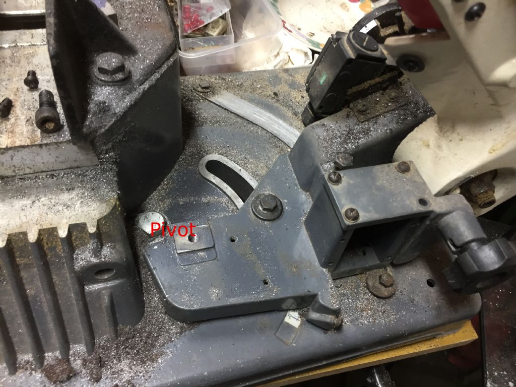

                                                To follow up on this, I replaced the (quite new) Axminster blade with a bimetal 10/14 Vari-Tooth from Tuffsaws. I was reluctant to believe that the blade was a problem because the Axi blade had seen very little use, but this completely cured the problems of the blade snagging and/or jumping the wheels. In fact the machine is now cutting better than ever.
                                                Encouraged by this result I am revisiting the accuracy problem, which is still with me. To recap, the machine cuts about 2mm off square vertically over 50mm. This is how the arm is mounted to the base casting:
                                                As you can see the arm pivots wrt the vice to allow angled cuts, but I don't really need that feature – I'd be happy if the ducking thing just cut square.
                                                My first thought is just to put in some shims somewhere (I need the tilt the arm about 2 degrees towards the camera), second to drill and tap for jacking screws, third to take it all to bits and try to mill or file the base of the casting which holds the arm so it sits right. I suppose that would be the 'proper' way to do it? But it might be tricky.
                                                Any thoughts? There could well be snags with my naive approaches which I haven't seen.
                                                Axminster are now selling what appears to be the same machine, but re-badged as 'Engineer Series' and painted a different colour (mine was 'Hobby'  )   for £546.96. Gosh.
                                                Robin.
