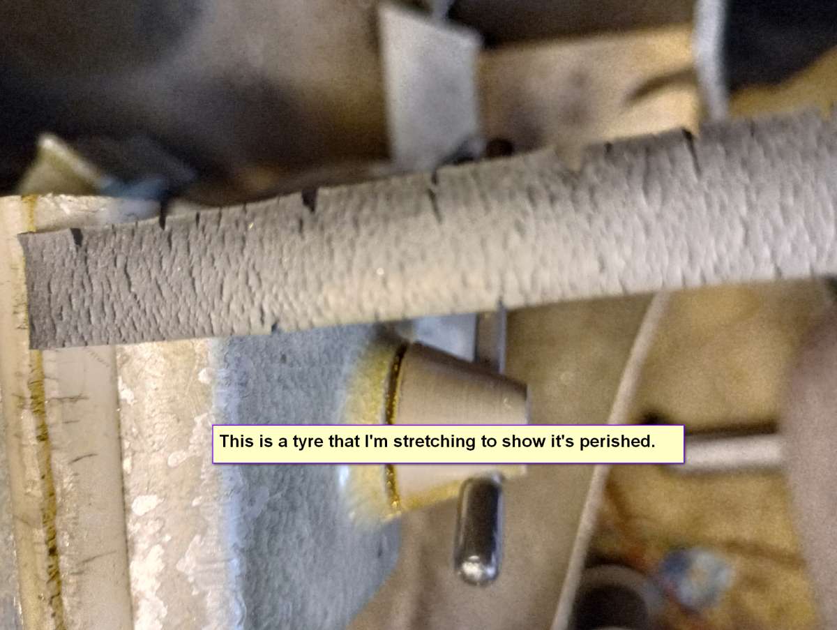

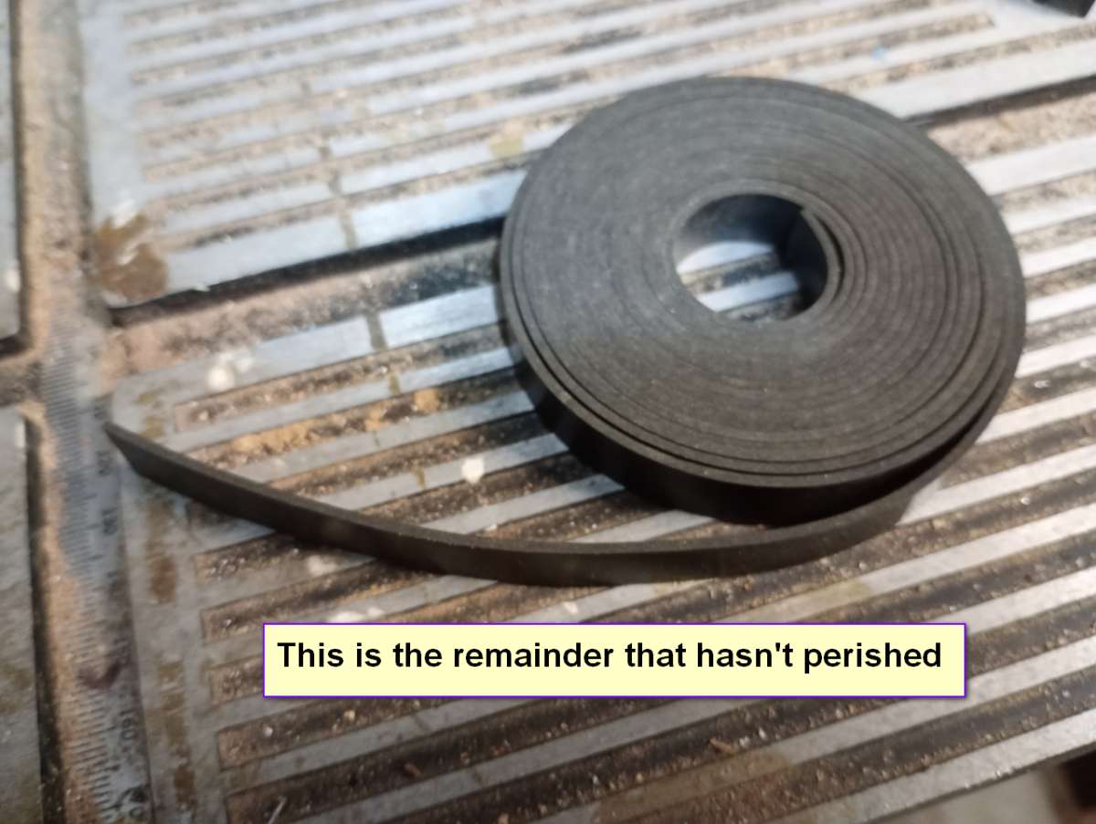

      I inherited a Clarke CBS355 bandsaw. The 3 rubber tyres needed replacing, but I couldn’t find a supplier for them so I purchased a roll of, what appeared to be, a suitable replacement material. I cut off 3 lengths to fit and joined the ends with superglue. They fitted perfectly, but after a couple of months they all broke. The glued joins hadn’t failed – the rubber had perished.  The remainder of the original length is still fine – no sign of perishing.
      Any ideas as to why the 3 home-made tyres perished?
      PerishedfTyre rubber

                That looks like ozone-stress cracking! Some rubbers get sensitive to ozone when under too much stress. Sometimes just background level that exists in the atmosphere is enough to start the process but you might be adding to it by something you are doing in your workshop. Do you make a lot of sparks ?!?

                          Yes, it’s a generic 3-wheel 14″ B/S. The wheel are 165mm diam. I’ve not managed to find a source of replacement tyres online – any suggestions.
                          I don’t have any details of the material I used other than it’s rubbery. The unused remainder has been stored right next to the B/S and seems totally unaffected – ie. no sign of perishing.
                          I deliberately sized the tyres to make a good, tight, fit on the wheels. Could I have overdone the stretching?

                                I found the order for the material I used;  it was described as 1.5mmX12mmx5m Black Neoprene. Could the initial stretching (at least 65mm on a length of 455mm) be rather too much?
                                I didn’t fancy £33 for the three tyres so if the Neoprene isn’t suitable in it’s stretched state I’ll take the suggestion of getting the bigger (and cheaper) larger ones and cut them down. What do you think?
                                #720394
                                  65mm does sound like a lot of stretch
                                  I am no expert on band-saws, or neoprene; but I suspect you have triggered what is known as “stress corrosion” … where a tiny defect develops into a big crack under stress.
                                  Edit: __ Wikipedia has a good overview
                                  https://en.wikipedia.org/wiki/Stress_corrosion_cracking

                                    If you’ve got enough material, trying again with less stretch has to be worth a go.  By how much?  The length of a bit of string springs to mind.
                                    It might even be worth trying just the smallest amount of stretch, and a little contact adhesive between the wheel and tyre.
                                    #720430
                                    Howard Lewis
                                      @howardlewis46836
                                      Pure gueswork, but 40 – 45mm would probably quite sufficient stretch.

                                        I’m trying with a stretch of slightly less than 4%. It will take a few weeks to see if it works.
