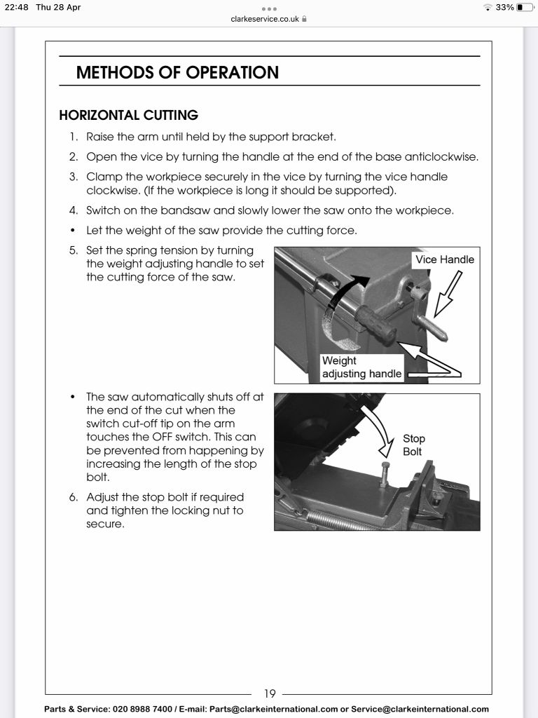

      I can’t find the arm weight I should be using
      #596105
      andrew lyner
        @andrewlyner71257
        I have had a Clarke CBS45MD 4 1/2 inch band saw for a few years now and it is a fabulous tool in any ways. There is a screw to adjust the length of the support spring which varies the 'arm weight'. The handbook mentions the adjuster but I can find nowhere to tell me what weight I should be using. It's not so much the time taken for cutting but the length of life of blades that concerns me.
        I know that hand sawing with a hacksaw can make a big difference in cutting rate, depending on hand pressure so there must be some optimum. I imagine I could get a clue if I was bright enough to translate what the "feeds and speeds" information about turning and milling offers but a simple rule of thumb would be nice to have.
        Any ideas about sources of that info?

            The only hint they seem to give is in the ‘Troubleshooting’ section:
            Bad cuts (not cutting square)
            1. Feed pressure too great
            1. Reduce pressure by increasing spring tension of the saw
            … apart from that, it’s just
            “• Let the weight of the saw provide the cutting force.”
            Ref; __
            https://www.clarkeservice.co.uk/manuals/woodworker/CBS45MD_Bandsaw_ISS_5.pdf

              I find if you apply too much force, wind the tension spring fully off, there is a tendency for the blade to snatch on break through causing the blade to be thrown off the wheels. This is more pronounced on wider flats rather than rounds where the cut lessens as you cut through. So a bit of trial and error with setting, but once set hardly needs touching again.

                    Hi Andrew, yes it is a little guess work, but if you cut a flat bar say 50 x 6mm, with it clamped in the vice by the 6mm dimension, you will need to have less pressure on the blade than you would if you held it in the vice by the 50mm dimension, not having enough pressure on the blade this way will give the effect of the teeth rubbing rather than cutting. You have be aware that these machines are a bit of a compromise, compared to an industrial machine, where the pressure can be controlled by hydraulics even during the cutting process, so in the case of large diameter round bar on an industrial machine, you can start of with a fairly light weight cut and then increase it as it gets towards the middle section and then back the weight off once it has past the middle section, thus prolonging blade life, but in my experience, nobody really does that in a work environment, as they just what to cut things off as quickly as they can and don't worry about how many times the blade has to be changed.

                                          Posted by andrew lyner on 28/04/2022 19:51:47:
                                          i couldn’t find any figures on a prescribed maximum pressure (load?) on the Clarke manual. Mine’s the 41/2 inch version.
                                          The prescribed [albeit not enumerated] maximum pressure is that provided by the weight of the saw
                                          To repeat the quotation:
                                          P.S. __ It is my belief that I referenced the correct manual for your saw
                                          … which is quite widely referred-to as having a capacity of 4 1/2” x 6”
                                          … I may, of course, be mistaken
                                          Ref.
                                          Edited By Michael Gilligan on 28/04/2022 22:54:23

                                            That is no help whatsoever. The "weight of the arm" is not the same as the force on the blade because of that massive / adjustable spring that partly holds it up. I read all that already. Can you tell me how I could get the information I wanted? I mentioned that I measured 10 to 20N on the handle but the range is greater than that in both directions. If I remove the spring, then I will get "the whole weight" acting on the blade. I don't think I'm being particularly thick about this when I say that the information is just not there.
                                            But I now realise that it's only by looking at the resulting cut or time taken that I could tell if the spring should be wound in or out if indeed it makes much difference.
                                            But hats off to Clarke on their fantastically good (cheap) workhorse. It cuts much straighter and truer than I could ever do by hand. The only snag is that at least two values of tip are needed and changing the blade is a bit like crocodile wrestling – so I will stay with a fine one and be prepared to wait ages to cut a thick aluminium bar.

                                              Posted by andrew lyner on 28/04/2022 23:06:38:
                                              Evidently, I cannot
                                              I have already tried to explain that the maximum is the ‘natural’ weight, and the spring can only serve to reduce the ‘effective weight’ AND that the effective weight is to be reduced if the cutting is ‘not square’
                                              … and I really can’t be bothered trying any further.

                                                  I have had one of the same generic type of bandsaws for six months or so now. Used it extensively cutting 3/4" steel plate as seen in my recent thread on Myford Lever Action Tailstock Design and Build. It seems the "correct" setting for the spring adjustment is by trial and error and varies somewhat depending on the material being cut and its thickness. Blade tension can make some difference too. Obviously cuttng a piece of 4" x 1" flat bar will be different from cutting a piece of square tube with 1mm wall thickness.
                                                  In the end I have arrived at a setting that generally works but if the machine sounds like it is starting to shudder or work too hard, I might either lift the arm a bit to take some pressure off, or wind the spring up a bit. Conversely if it's cutting a bit slow or rubbing a bit, I might gently push the arm downwards add some weight to the blade, or adjust the spring to suit. Mostly, once you get the "feel" of it to your satisfaction, the spring can be left alone and the saw left to do its job unattended once started.
                                                  One thing I did do was follow the advice of the manufacturer of the new blade I bought and tighten the spring up to use less pressure on the blade until it is "run in" a bit. Definitely helps. Good quality aftermarket bimetal blade is streets ahead of the standard item. And you can run the saw on the fast speed to cut steel with it, saving a lot of time. I think from memory mine is a 14-10 variable pitch blade and seems to work on steel and aluminium just fine.
                                                  So in a nutshell, a bit of trial and error and a bit of gumption will get you there.
