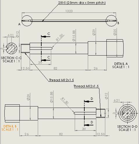

            I bought a set of 3 ball screws and nuts from a seller in China on AliXpress for my CNC conversion. They offer to machine the screws to your drawings for a few dollars extra which I took them up on. Having designed my own complete conversion in CAD, I was able to print out a set of PDF drawings which the seller used to make my set up from. This included my own keyways, threads etc and a variety of diameters and lengths. I was pleased to find that they were nicely machined and the dimensions were spot on. Definitely worth getting that done, rather than only getting half the job done and having to machine an unwieldy leadscrew yourself.

                    I like the sound of getting the screws machined to size Murray. If the cost was reasonable, that would make things very much simpler. I assume that the keyways you mention are in the end of the feed screw (for securing handles etc) and not along the body (e.g. main length) of the ball screw?

                          IanT – yes, just at the ends.This is from one of the drawings (for the X-axis). I think I paid $10 for the machining of the X and Y balllscrews. Can't recall if that was each or total but it was a bargain either way. You can't really machine keyways where the ball threads are.
                          I made a transfer arbor for my Z-axis ballscrew which I bought a few months before the X and Y so I could machine the ends myself. I also had to machine down the hardened flange on the Z-axis ballscrew. If you need to remove the ballnut, it could be tricky with some designs, so you should consider how to make and use one of these arbors at the design stage. I'm not planning to remove the X and Y ballnuts at this stage but that may change….
                          Unless you buy from the US, ballscrews tend to be metric and generally come in 12, 16, 20, 25 and 32mm diameters. The most common pitches are 4, 5 and 10mm, although there are larger ones if you look around. 5mm is the same as the original pitch on my metric Bridgeport clone and I could see no obvious reason to change it. I also downsized from 32mm acme thread to a 25mm ballscrew. If you look at the load specs, 25mm should be more than adequate.

                          X-axis ballscrew drg
