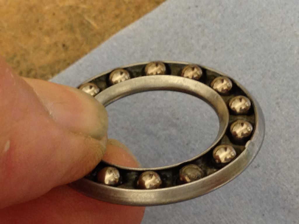

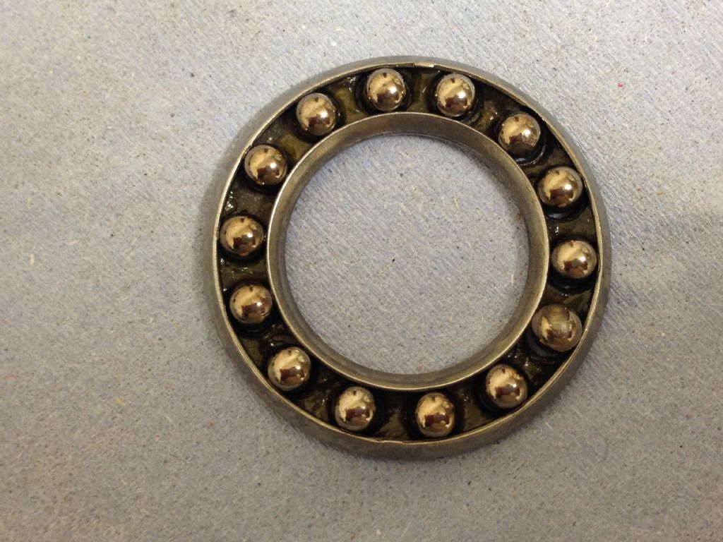

      I am refurbishing a Tom Senior Vertical Light mill. The bearings in the traverse (hope that's the right word) are worn as are the cages they sit in (see attached).
      I think I can find replacement balls but the cages might harder to come by. Could I get away with just replacing the balls?
      A couple of emails have gone off to two bearing suppliers but I have little hope of them being interested in such a small order.
      Any advice would be very welcome.

          Is this a thrust bearing; working between two flat [or grooved] washers ?
          … If so, then I suspect that there will be a modern alternative readily available.
          Could you please provide some dimensions.

                  As mentioned above it is a thrust bearing and there will or should be two end discs with a groove ground in one face that the balls ride in .
                  You will need outside diameter , inside diameter and total thickness of the bearing with the two discs fitted to allow the bearing supplier to find what you need .
                  You mentioned that they are worn ?
                  How have you determined this ? As they are not something i would have suspected to be worn out , if the balls are still running smoothly in their grooves they are probably ok – look for any corrugating in the end disc groove and check the balls out if there is no apparent damage all is good .

                    I replaced the thrust bearings in my Tom Senior Junior Y and X Axis handwheel/leadscrews. I don't know whether the sizes are the same for the light vertical.
                    For my mill they were FT5/8 Imperial Thrust Bearings and come with the balls/cage assembly and two races to run in.
                    A word of caution, I bought some unbranded ones and they should have been 0.281" thick, but mine measured 0.286" thick. Because of the way the Y axis bearing housing was designed, they are not adjustable, so the unbranded bearings were binding when tightened down. I had two options, shim out the bearing housing with the oversized bearing, or return them and get branded. I ended up returning them, and the vendor replaced them with branded RJH variants which fitted perfectly with no shimming required. Vendor was Bolton Bearings.

                      The bearings sit between to flat shims which are about 1mm thick. They do not have machined grooves in them but there is some surface pitting. I have already worked out that these could be reversed if needs be to provide a decent surface for the balls to run against. Some of the balls are pitted which is why I said they are worn. I get the impression that the oiling point on the traverse may have become blocked.
                      A quick Google yesterday showed a similar product that is called a thrust bearing and with similar cages.
                      Dimensions are: Outside diameter 32.75mm and inside diameter (the hole) is 19.30mm. As I said earlier I am pretty sure that this mill is mainly imperial unlike my 1978 Boxford lathe which is a real hybrid of Whitworth & metric.

                        I suspect the bearings you need are FT3/4 bearings. They are pretty readily available for less than a tenner.
                        They should have O/D of 33.35mm (1.313" ) and I/D of 19.05mm (3/4" ) and thickness of 7.14mm (0.281" )

                          Thank you for your help. I had to work late last night but measured up the bearings this morning and Bolton Bearings seem to have them.
