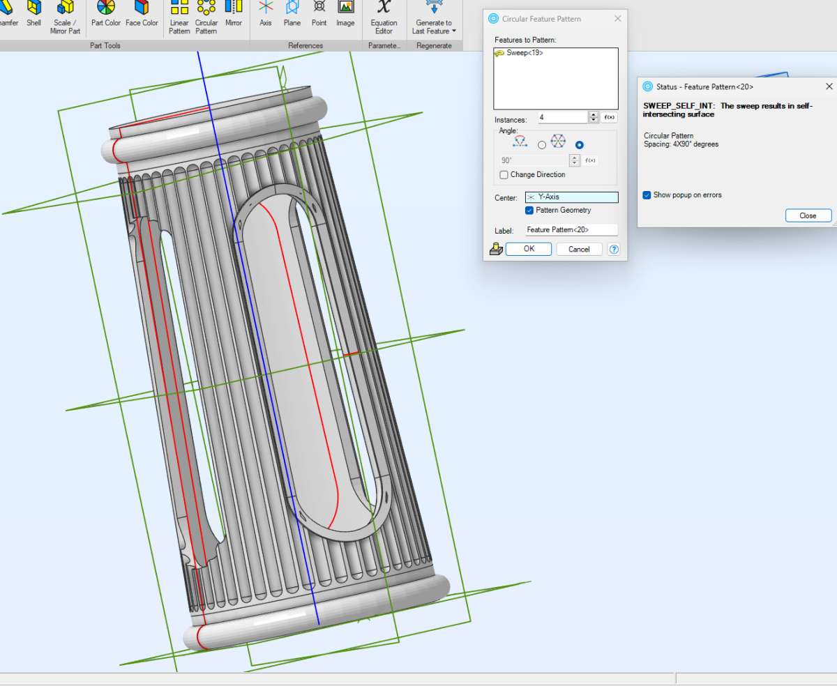

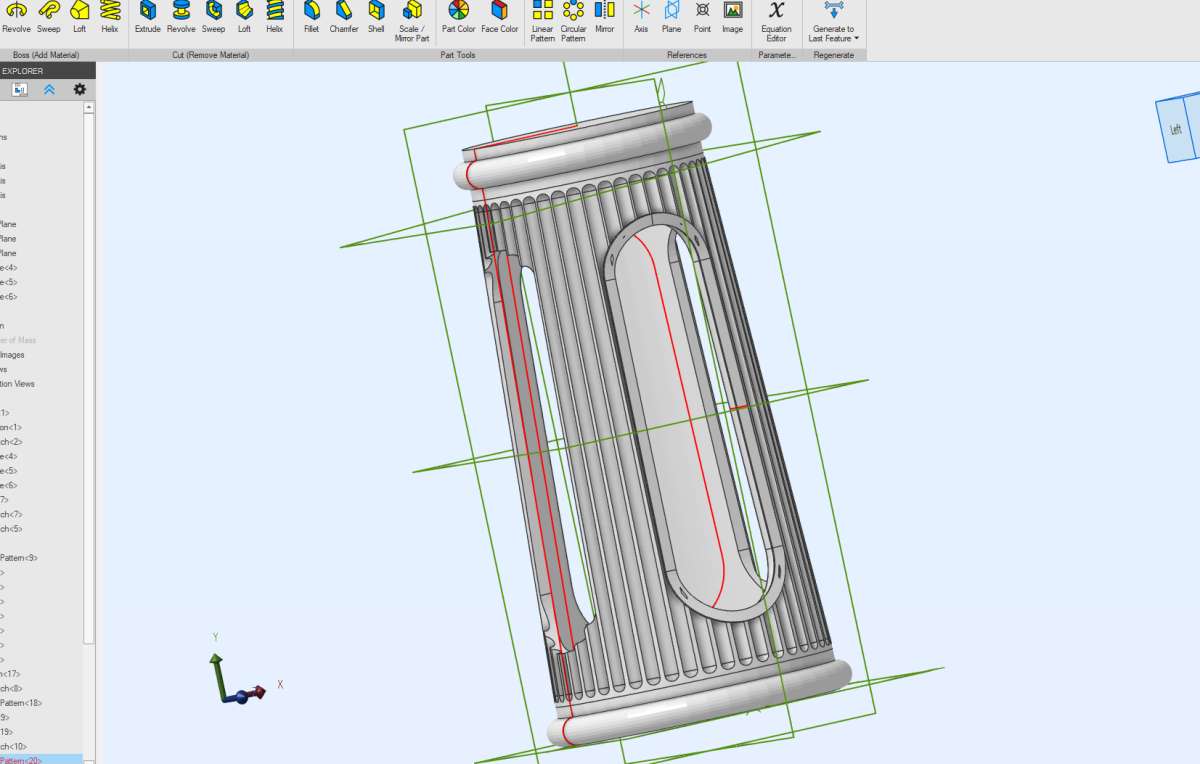

      I’m still learning ‘The Principles’ by just playing – this isn’t part of a project – it’s an exercise..
      Here is a fluted column. It’s a truncated cone, with 4 tapered cut-outs (‘windows’) disposed radially.
      I’d like to ‘frame’ the windows, possibly with an ‘angle’ profile, but perhaps more easily with a ‘flat’ applied to the surface around each aperture.
      Sweeping an angled strip around the inside ‘section’ of the cut-out is just do-able, but took several goes, made the processor ache – and the end result is unpleasing.
      Q1 – how can I replicate this ‘sweep’ to the other three apertures
      Q2 – I can see how a separate frame might be more pleasing – how would one form it – by building a ‘reference cone’?
      Columnshot23Feb

        Q1 – use a circular feature pattern.
        Q2 – not sure I understand either your aim, or “reference cone”.

          ..the ‘okay’ button will go red, once the error notice is cancelled..

            Q2 – How can I make a ‘frame-shaped-structure’ that conforms to the shape of the surface of a cone?

              Q2 – again not entirely sure what that means.  Is front of frame to be curved around the cone or flat?
              If you send your existing file to me, directly (PM me for e-mail address) OR raise a support ticket with Alibre and I’ll pick it up there.  https://www.alibre.com/alibre-customer-support-ticket-entry/

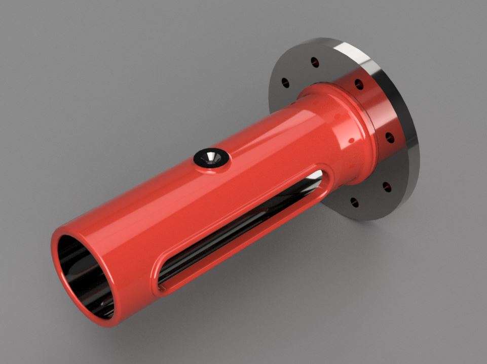

                I did draw a Williamson column at one time but can’t find it at the moment.

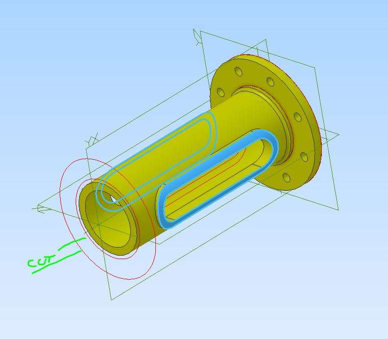

                This is how I have done it with a plain cylinder in the past
                1. Draw the shape of the window on one of the central planes and extrude it out beyond the cone. In your case I would just extrude out one sid eand then do a 4 x circular pattern of teh extrude.
                window1

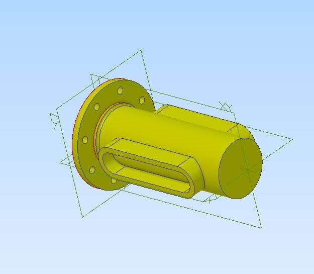

                Then cut off teh excess protrusion, I did it by cutting a “washer” shape along the length but if you do a shape with one line running parallel to the edge of your cone and do a revolve cut all the way round that will leave the window frame a set distance from the crest of the flutes
                window2
                Lastly add any edge detail, I did a roundover
                window3

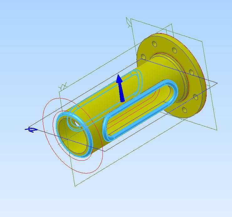

                  Just tried similar method on teh Otto Column
                  otto window

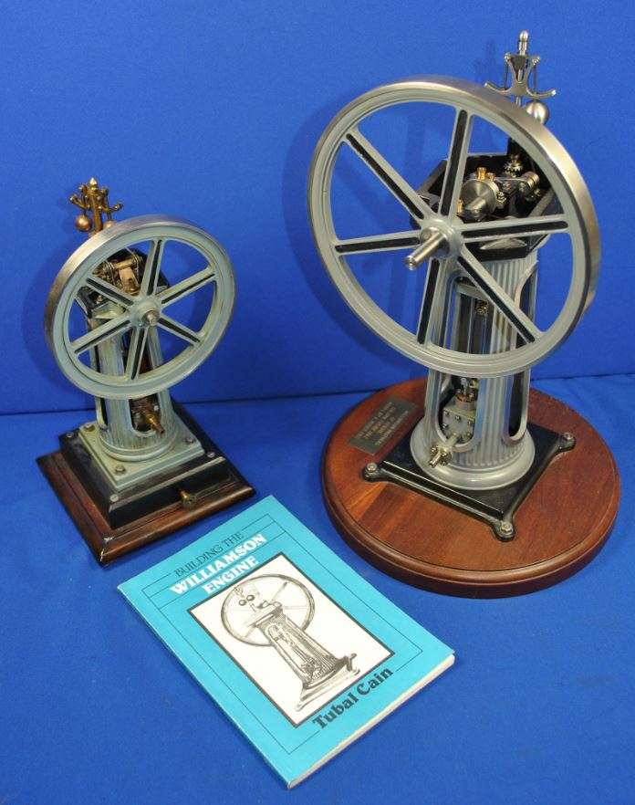

                    Jason – have you ‘done’ a Williamson? – a nice looking engine, but probably above my skill-level to fabricate at present..

                      As for why the feature pattern didn’t work, I’d need to examine the file with the failed feature to work that out.  Say OK/Apply anyway (even though button is red), to have the feature saved into the Design Explorer.

                        I had quite a job getting the sweep to ‘take’ in the first place, a whole series of minor ‘tweaks’ to both sweep sketch profile and settings, so could be related to that, also there are 46 flutes (not divisible by 4) so the possibility exists for a ‘clash’ there somewhere too?

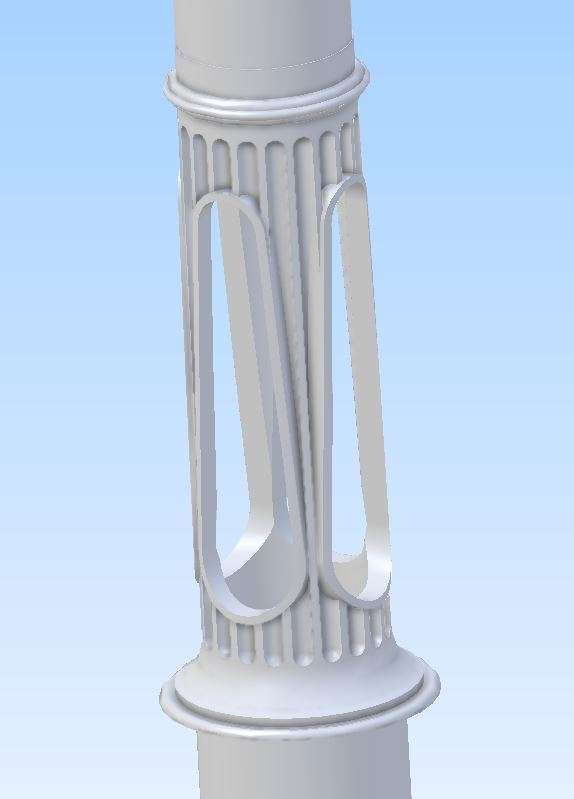

                          There was talk of a “Big Willy” over on MEM forum, Anthony Mount did some patterns and made a couple to commission. It would not be too difficult to machine the column from thick wall tube, cut the windows and then add the “frames” It is not an easy one to cast as the flutes prevent it from being just a two piece pattern split down the middle as you would not be able to pull them out of the sand. A good candidate for 3D metal printing but you do need to be able to draw it first!
                          I’ve got the book and will draw up the column again to see how it looks.
                          big willy
                          #785214

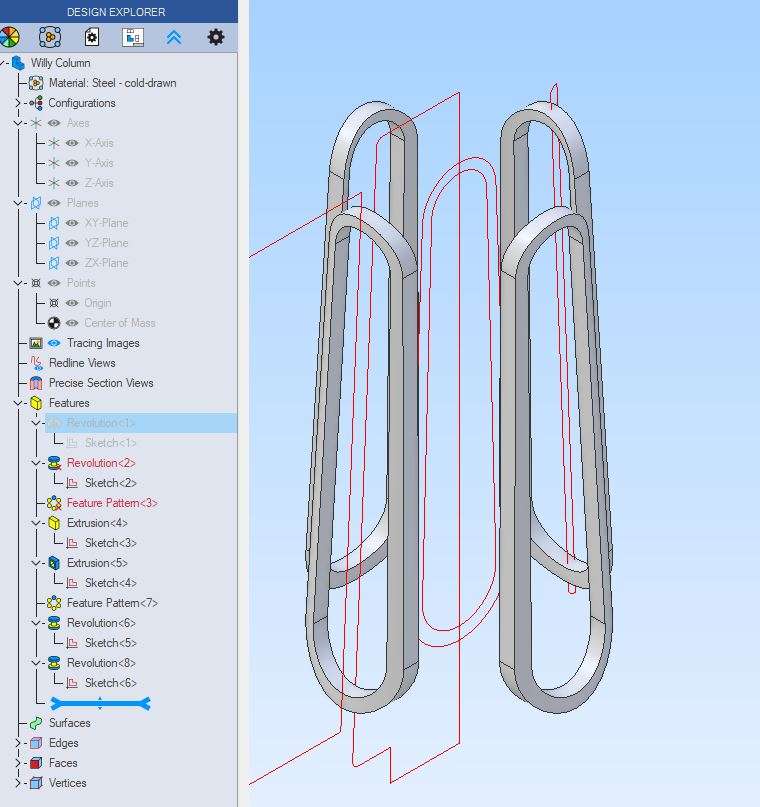

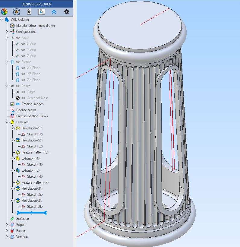

                            Here you go, done much as I described earlier
                            bw1
                            I’ll send you the file.
                            And if you wanted the frames separate then the previous features can be suppressed
                            bw2
                            #785216
                              bw3
