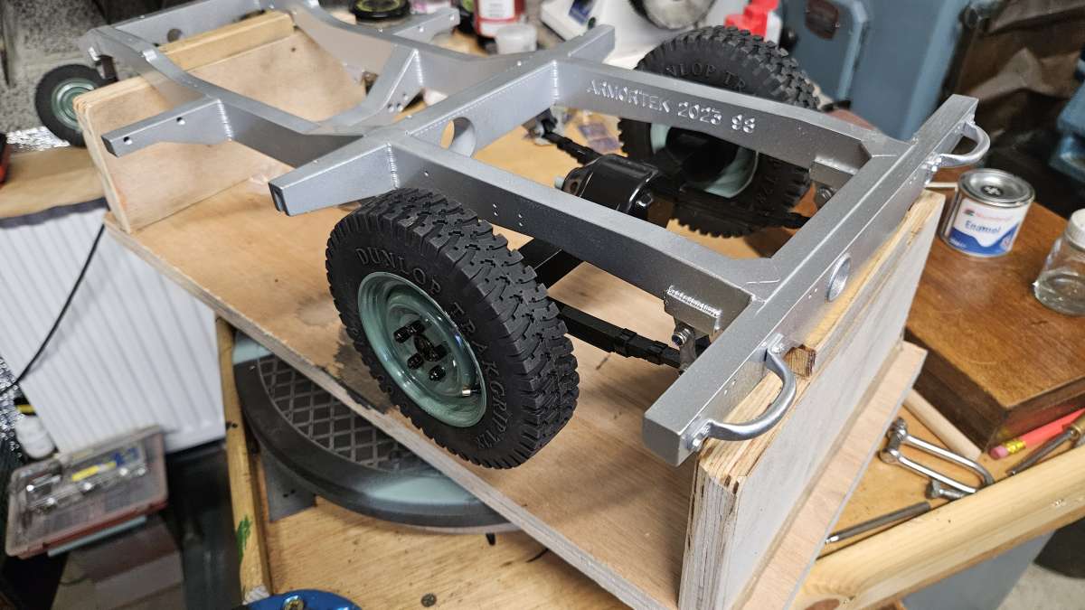

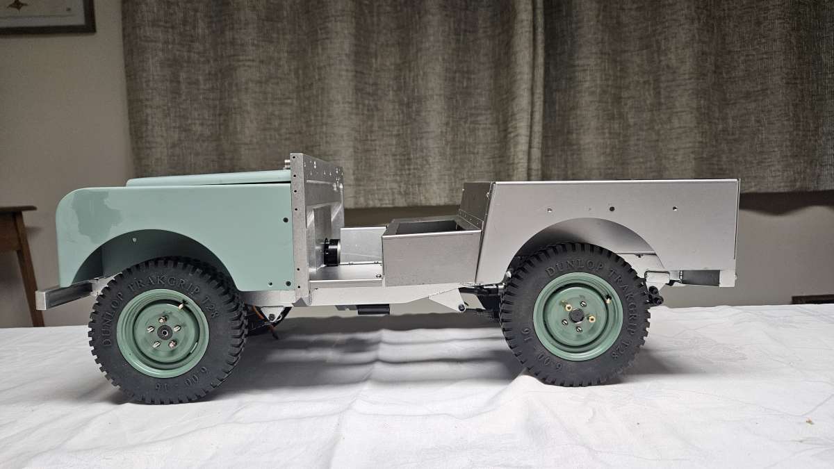

      Chassis built up and painted and the rear axle fitted.
      I opted to paint in an aluminium silver colour as the Landy was originally meant to have a zinc dipped finish as a rust proofing measure.
      But it was expensive and so silver paint was adopted early on.

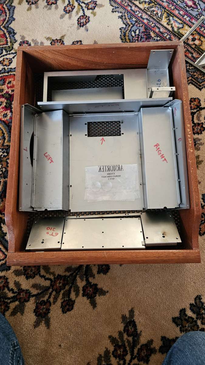

            Work is continuing on the chassis,  but as its Christmas i decided to spend a bit of time out of the shop and sorting the parts for the Landrover bodywork.
            20241224_151044

              @plasma
              This is the sheet metal for the rear bed, it’s all bolt together in kit form but obviously is riveted mostly in full size.
              I will dry fit the parts together and see what needs to be done to achieve a closer facsimile of the Landrover I am basing my build on.
              It won’t be a scale replica but will certainly enhance the look of the basic kit.

                Spent an hour dry fitting these panels together so I can see the layout and start to assess which fastenings can stay, which need to be disguised and which need to be ditched and replaced with aluminium rivets to scale size.

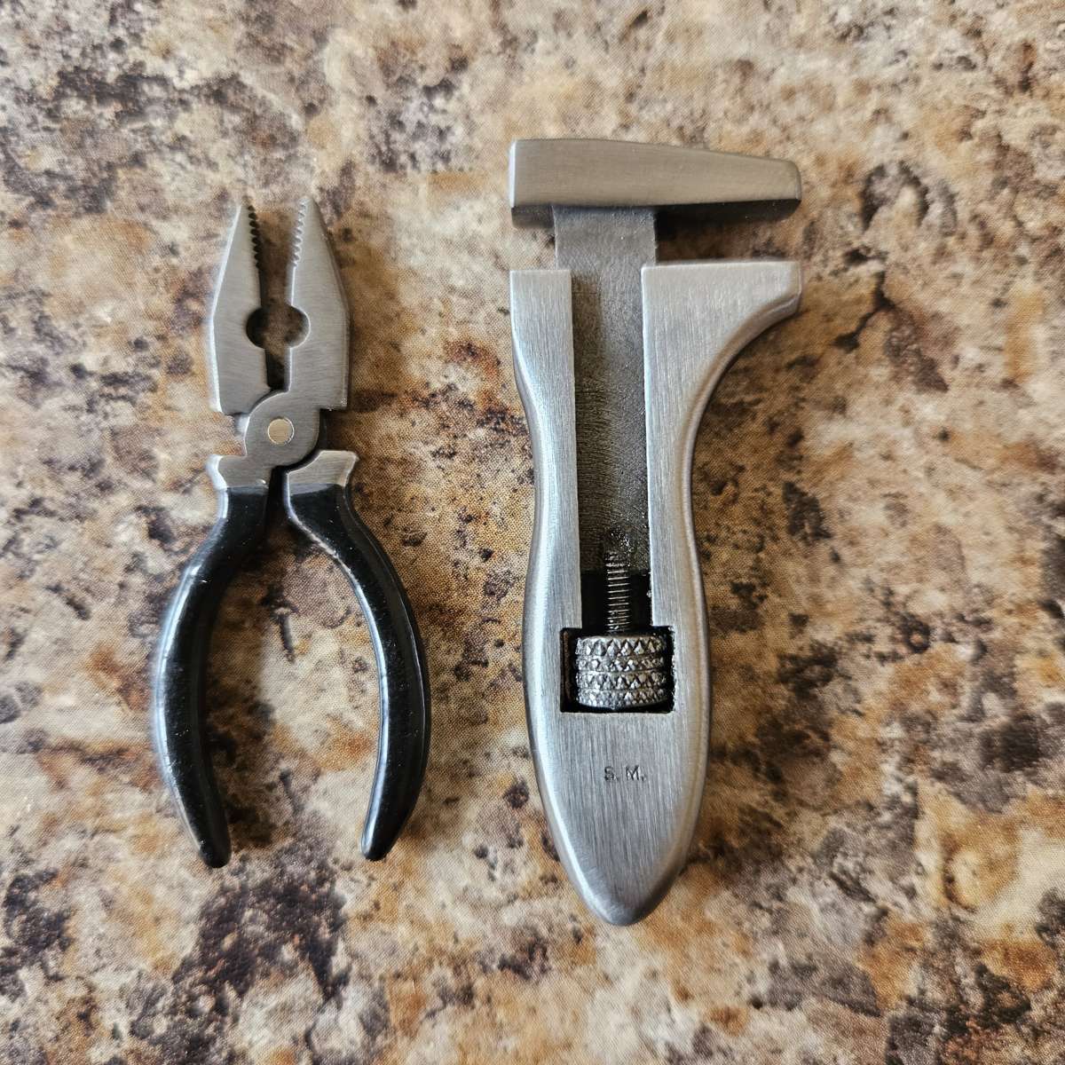

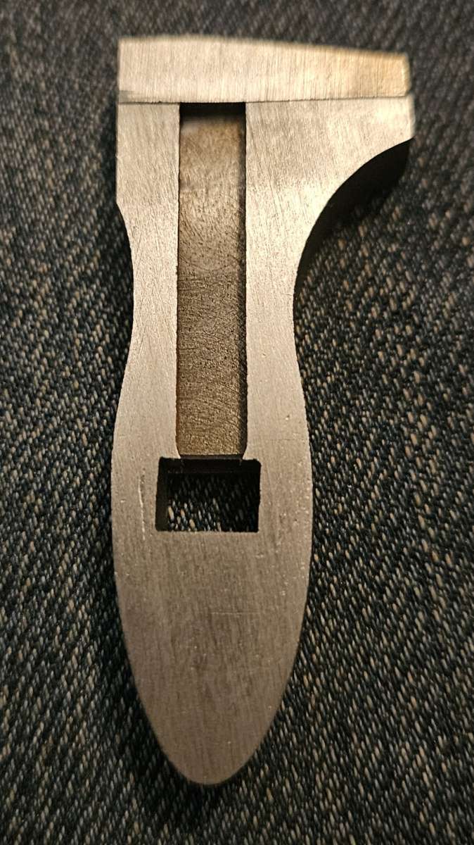

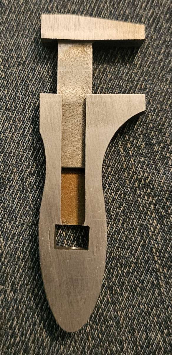

                    After working on the heating system in the house for a while I decided to make a movable jaw spanner for the Landrover kit.
                    The original toolkit has a distinctive spanner and I thought it would be a neat exercise in milling to make the tee slot in the fixed jaw.
                    I used the die filing machine to work on the curved surfaces as the cast iron is 8mm thick.
                    So far a couple of sessions in the shop have got me to a decent place and now it’s turning an adjuster nut and fitting an M2.5 threaded rod into the sliding jaw.

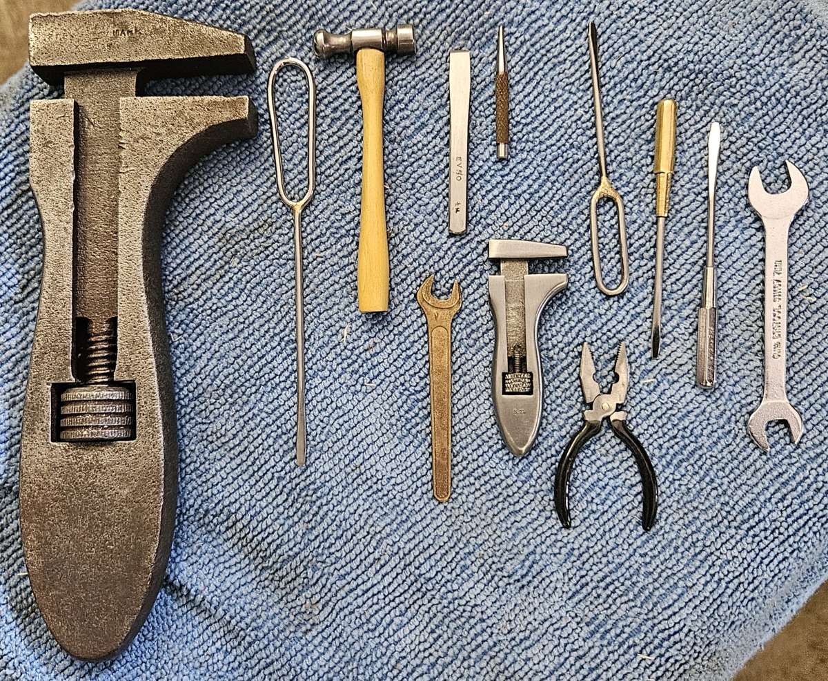

                        The little tool set is about complete. I’m very happy with the movable spanner and the pliers.
                        This was a side project to keep me busy while the weather turned better for painting.
